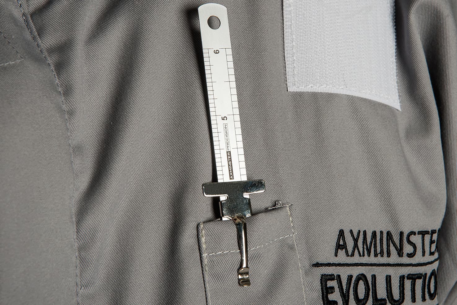

Axminster Precision 150mm Rule With Pocket Clip
We all know what it’s like, you put down a rule or tape and you then cannot find it, or it’s the other end of the workshop. A handy pocket clip means you will always have this rule to hand. However, this is no gimmick, this rule is as accurate and easy to read as the rest of the range.
