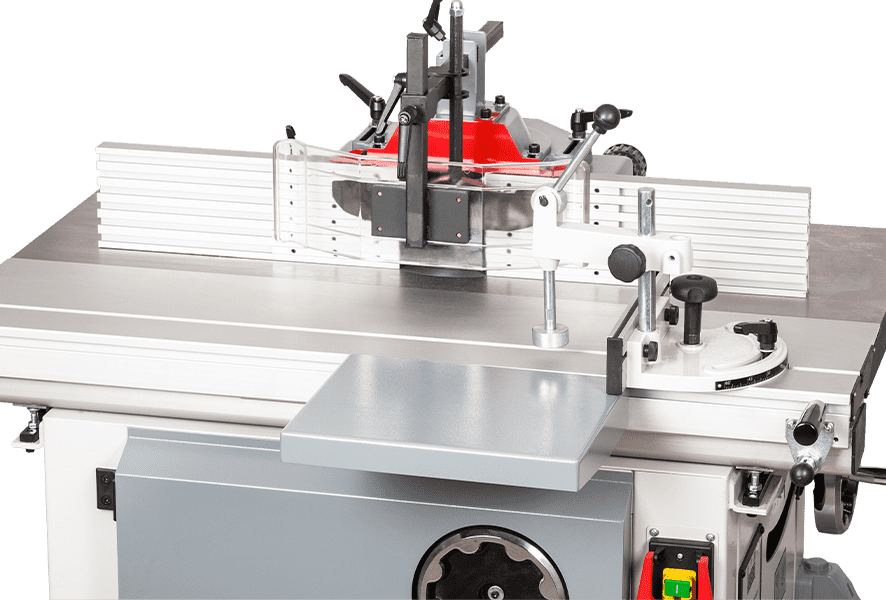

The 1,000 x 360mm table is made of fine ground cast iron, providing a smooth, stable and robust work surface.
Integrated sliding table
Your work will be well supported right up to the cutter block, improving accuracy and making the cutting process easier.

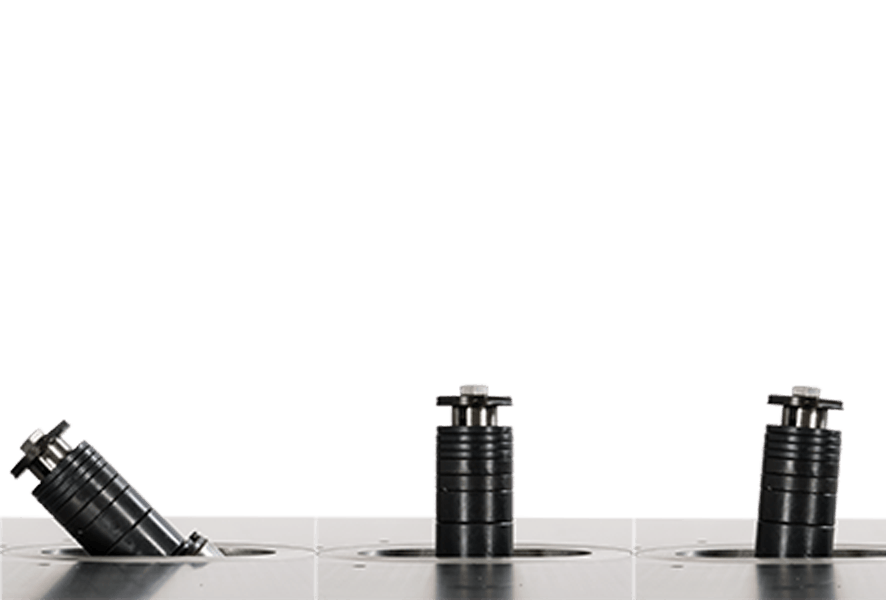

Spindle tilt
Spindle tilt
The AP200SM has a tilting spindle with a range through +5⁰ to -45⁰, for versatile and creative work using the same cutter at different angles. There is a pre-set angle stop at 0⁰ vertical for ease of use.

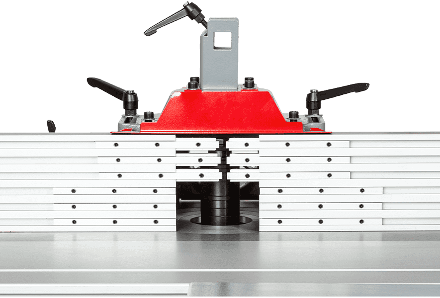

Integrated finger fence
Enjoy added safety with the integrated finger fence; fully adjustable and able to close around the cutter block.

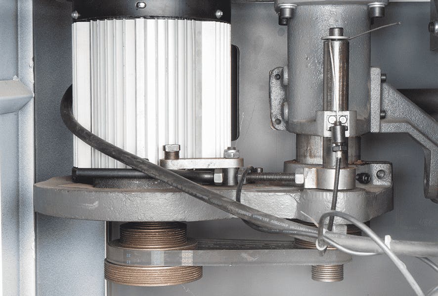

Easy speed change
Easy speed change
Set up quickly and easily with simple speed changes. Four speed choices between 1,800 and 9,000 rpm allow the use of a wide range of tooling, whilst the digital speed readout ensures accuracy.

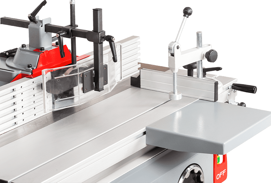

Cutter hood guard
Cutter hood guard
The AP200SM has a substantial cutter hood guard with fully compliant shaw guards, which complies with all HSE regulations for safety.

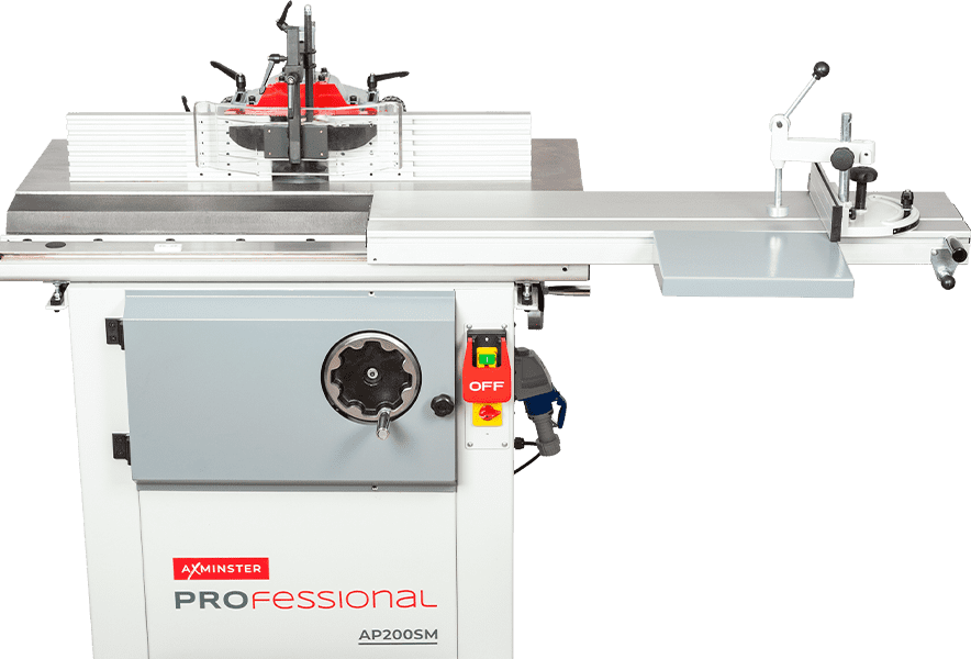

A machine with great potential and many useful features. The ground cast iron table is a good solid surface and gives great stability and solidity.
The machine has a 2.8kW 1ph motor producing plenty of power. A choice of four speeds between 1,800 and 9,000rpm allow the use of a wide range of tooling. A handy digital readout displays the spindle speed. The 30mm spindle has a tilt facility from +5° to - 45°. There is a stop set at 0° vertical, which can be withdrawn to allow the spindle to tilt forward by +5°.
The spindle hood is cast alloy with long, fully adjustable finger style fences. It, comprehensive work hold-downs and a 100mm dust outlet. A second 100mm dust outlet is located on the stand directly below the cutter block. With the two connected to a suitable extractor waste removal is highly efficient. The machine is supplied with a simple sliding table with a mitre fence and work clamp as standard.
An optional square frame table for the added support of panels etc is available. Other options include a tenoning plate, which raises the work above the table allowing you to machine the bottom and top of the work together. It also allows cutter diameters up to 200mm above the table for long tenons.
