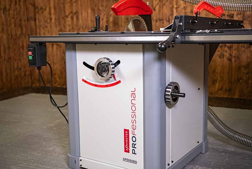

A versatile and capable workhorse
The Axminster Professional AP305SBD Table Saw is a superior machine with a more than impressive cutting capacity. Designed with flexible twin table configuration, heavy duty construction and a premium fence solution, you won’t know how you worked without this saw.
Buy with confidence
So sure are we of the quality of this table saw, we cover all parts and labour free of charge for three years!
Find out more
Cast iron tables
The large fine ground cast iron tables provide smooth running, reduced vibration and a long life for your table saw.
Independently mounted table & trunnion assembly
The trunnion assembly is mounted independently on the saw's frame, relieving stress on the table and ensuring that the table remains flat and true over time.
Solid "T" style dual height rip fence
Achieve close to the blade work as well as heavy duty ripping with the dual height rip fence, with a solid "T" style design for accuracy.
Twin extension table configuration
Set up the twin extension tables on either side of the saw for a traditional cabinet making style, or mount both tables on the right-hand side to handle large pieces.
Twin mitre fence table slots
Twin T-slot mitre fence slots on both sides of the blade, ideal for jig use. Also supplied with a premium mitre gauge with useful pre-set angle stops.
Impressive cutting capacity
The 305mm blade give you a 103mm depth of cut, while the extension table provides a ripping width of 1,300mm, making this a very capable bench saw.
Compatible with Dado Blade
With the available accessories of Dado Blade Table Insert and Overhead Crown Guard, the AP305SBD is compatible with a Dado Blade Set which enables the easy cutting of grooves.
Powerful 2.5kw motor
The quiet and powerful induction motor maintains blade speed for a consistent cut.
Heavy duty handwheels
Metal handwheels provide a smooth operation for blade adjustment.
Recommended Accessories
Axminster Professional 200mm Dado Blade SetFrom £199.98 £166.65
Frequently Bought Together
The AP305SBD Table Saw is robustly engineered and has an excellent capacity, making it invaluable for the professional workshop. It boasts an impressive 103mm depth of cut and a generous ripping width of 1,300mm with the included right hand extension table. This table saw will become an integral machine in the workshop, able to handle most pieces from sheet material to solid timber.
It's constructed on a heavy gauge steel chassis, with a cast iron table on top, providing smooth machining and reduced vibration over a long machine lifespan. The trunnion assembly and motor are mounted independently on the chassis rather than the table, relieving stress on the underside of the table and ensuring the table remains flat over time.
The AP305SBD is supplied with twin extension tables which can be configured in multiple ways, increasing it's versatility. Both tables can be mounted on the right hand side, offering an extended surface area which is ideal for cutting larger panels. Alternatively, it can be set up with the tables either side of the saw, making the AP305SBD into a more conventional cabinet maker's saw bench.
A quality mitre fence runs in T-slot grooves provided on both sides of the blade. The full length fence is a rigid T-style which locks at the front, adjustment is smooth and easy. The rip fence comes with a Hi/Lo aluminium auxiliary fence, for ripping and close to the blade work.
The 2.5kw induction motor offers the power needed. Two point dust extraction is via a 63mm connection on the blade guard hose combined with a 100mm outlet at the rear of the machine. Connection to a suitable extractor is recommended.
The AP305SBD is compatible with a dado blade. Optional accessories for this machine include a Dado Blade Table Insert and a Sliding Table.
