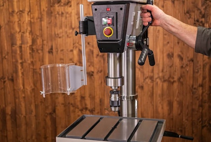

Enhanced Safety System
The electronically interlocked chuck guard and integrated belt cover safety switch prevent the machine from being accidentally turned on or running with the cover open, ensuring maximum safety.

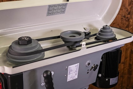

Multi-Vee Belts
Multi-Vee Belts
Multi-vee type belts provide maximum grip and low vibration, contributing to the drill's overall smooth and stable performance.

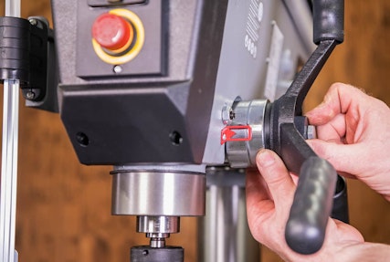

Improved Depth Stop
Improved Depth Stop
The improved depth stop allows for easy adjustment, enabling precise control over drilling depth for consistent results.

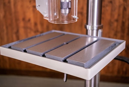

Polished Cast Iron Table

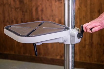

The (290 mm x 290 mm / 345 mm x 345 mm / 475 mm x 425 mm*) cast iron table provides a strong and rigid work surface, ensuring stability and durability during drilling operations.
Rack and Pinion Table Adjustment
The rack and pinion mechanism provides quick and easy table adjustments, making it simple to position your workpiece accurately.

The AP32FD Floor Drill includes a large table with rack and pinion height adjustment, which can tilt and swivel away to allow the base to be used as a work support. The switch system features a separate locking emergency stop switch and a separate switch for the integrated, adjustable LED work light. For added safety, the chuck guard and belt cover are electrically interlocked. This floor drill also features a 3MT precision spindle running in genuine NSK ball bearings, ensuring accurate drilling and low vibration.
This model includes several key upgrades, such as a heavy-duty chuck and a redesigned chuck guard with a fitted seal. The high-quality chuck enables quick and easy bit changes. An improved depth stop design allows for precise drilling depth adjustments. The AP32FD also boasts improved motor mounting and enhanced soundproofing between the drill head and guard, contributing to a quiet and smooth operation.
