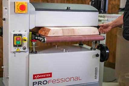

Fixed-head drum design
Offers superior structural integrity compared to traditional open-ended models.

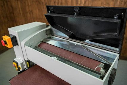

Self-cooling aluminium drum
Self-cooling aluminium drum with cloth-backed abrasive strip
Minimises heat build-up, extending the life of both the drum and abrasive for cost-effective operation.

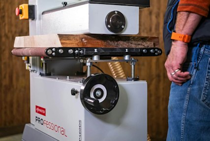

Precision-ground cast iron bed
Precision-ground cast iron bed with chain-synchronised height adjustment
Providing a stable platform, the cast iron bed ensures vibration is limited. The height adjustment allows for uniform sanding thicknesses to be achieved across the workpiece.

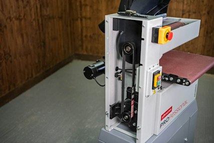

Powerful 1.5kW motor
Powerful 1.5kW motor with twin poly V-belts
Conquer demanding tasks with ease, as the motor delivers efficient torque transfer and reduced vibration for smooth and consistent sanding results.

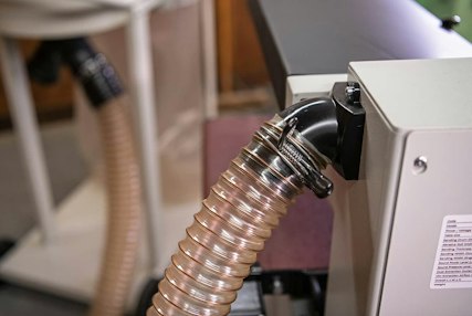

Fan assisted dust extraction
The fan assisted dust extraction helps to keep your workspace cleaner and safer. Pair it with an extractor offering a minimum airflow of 795m³/hr for optimal performance.

It has a robust fixed-head configuration, so unlike traditional open-ended models, the fixed drum head enhances the structure and the overall heavy duty design provides excellent stability and enhanced machine rigidity.
The open ended design allows for a sanding capacity of up to 920mm with a double pass, or 460mm in a single pass - ideal for wide panels and larger workpieces. The sanding thickness capacity is between 5 - 100mm.
Powered by a quiet 1.5kW motor through twin Poly V-belts, it delivers efficient torque transfer and reduced vibration for smoother operation. It has variable speed, so you have full control over the conveyor. The feed system features a cloth-backed abrasive conveyor belt running over a precision ground cast iron bed, adjustable from 0 to 4 m/min to suit your material and finish requirements. The bed can be adjusted in height and allows for precise sanding thicknesses to be achieved. The self-cooling aluminium drum minimises heat build up and extends the life of the drum and abrasive.
The bed measures 460mm x 465mm and is supported by four sturdy columns to ensure accuracy and minimise vibration. It is synchronised via a chain-driven mechanism for consistent height adjustment. A depth scale is also included for easy adjustment of thickness.
The 100mm precision balanced sanding drum is aluminium to ensure accuracy and to limit vibration.
Dust extraction is supported via a 62mm outlet. While a collection bag is included, we recommend pairing the sander with an extractor offering a minimum airflow of 795 m3/hr for optimal performance.
