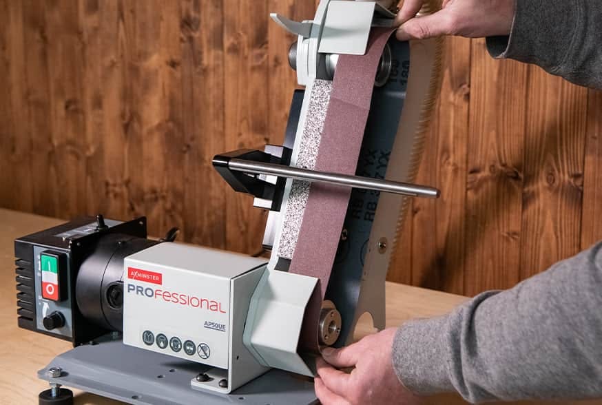

Axminster Professional Ultimate Edge Variable Speed Sharpening System
The Ultimate Edge offers a controlled, repeatable and effective method for sharpening, linishing or polishing on all your edge tools. Here’s our guide on everything that comes as standard, to the wide range of accessories available.
Features of the Ultimate Edge Sharpening System
Variable Speed - Stay In Control
With just a simple twist of a knob you can match the speeds needed for various types of abrasives and material, preventing overheating on small delicate items.
Forward & Reverse Running
Running the belt in reverse (away from the tool) prolongs belt life, gives you greater control and generates less heat resulting in a better edge for your tools. The reverse function is perfect for woodcarving tools.
Pulse Width Modulation (PWM) Motor Control
Smart electronics constantly monitor amps and speed to ensure there is enough consistent power under varying loads. The power is provided by a premium variable speed 560W PMDC Brush Motor providing plenty of power but also offers greater control when sharpening delicate carving tools or producing a secondary bevel.
Digital Readout in Metres Per Minute (MPM)
Allows you to closely monitor the speed, ensuring you can always maintain the correct one for the material you’re cutting. Speeds range from 202-600 MPM.
Adjustable Tracking
Tracking can be adjusted around four times quicker than a normal tracking system. Belt size 50mm x 785mm
Machined Flat Platform
Provides a flat surface for your belt application, ensuring an even grind when sharpening your tools.
Machine Extraction
Dust extraction ports to the top and bottom allow effective extraction, whether the machine is running in forward or reverse, providing you with a safe and clean working environment.
Toolless Quick Belt Change
Change belts in just 20 seconds with the quick-release door lock. An auto-tension lock and easy-to-adjust belt tracking not only means changing a belt couldn't be easier but it also allows you to work much more efficiently.

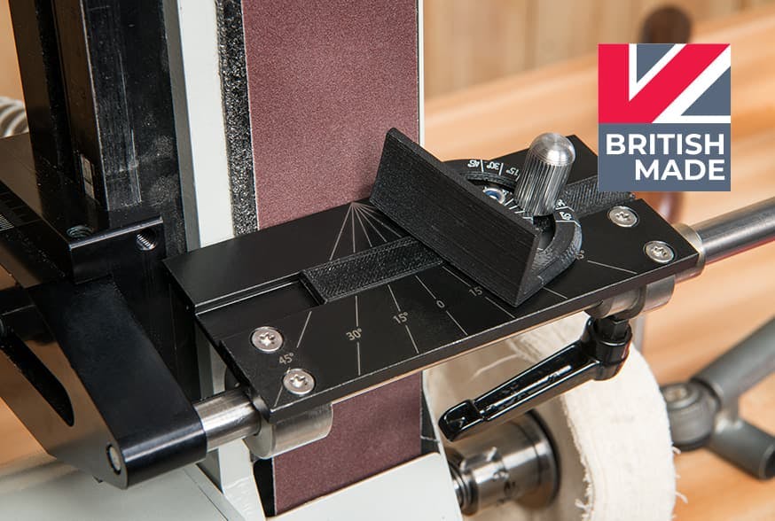

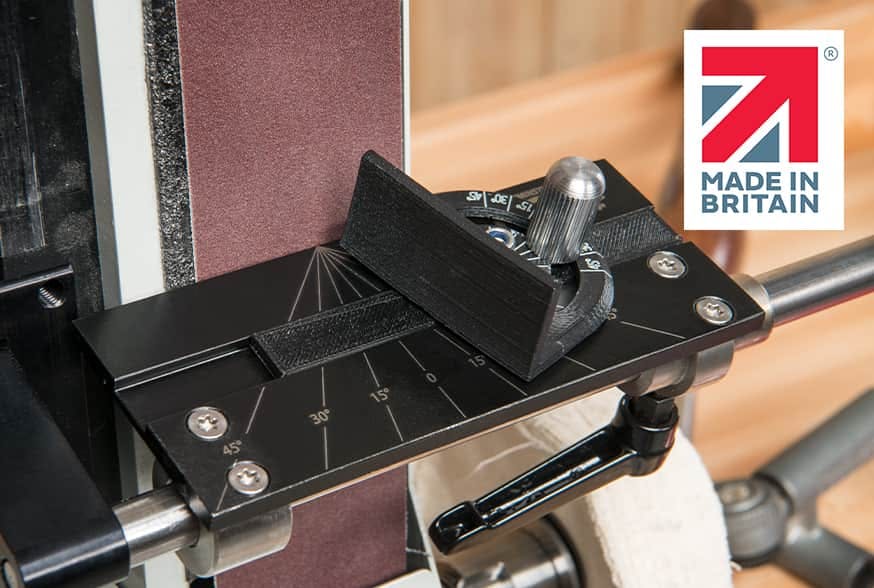

Universal Sharpening Table
Ideal for freehand lathe tool sharpening and general linishing. The Universal Sharpening Table locks securely onto the round bar of the Compound Jig forming a stable platform. Anodised in black, there is a quadrant of angles laser-marked into the surface for easy reference. The supplied mitre guide also helps to maintain the position of the grind.

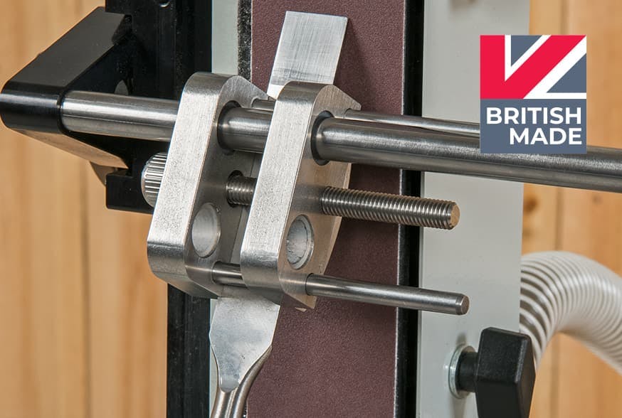

Honing Guide
Perfect for plane blades and joinery chisels - the jaws accommodate chisels from 6-66mm in width, so even a No. 8 plane blade will fit. The Honing Guide fits onto the round bar of the Compound Jig. The blade is clamped tightly allowing both primary and secondary bevels to be achieved. It is manufactured entirely from stainless steel and has a simple set screw to control the width. The LH jaw is reversible and has twin jaws. One curved so that chisels that do not have perfectly parallel sides (such as Japanese styles) can be clamped; the other jaw being parallel. The jaws are of a dovetail shape, allowing the chisel to be securely clamped against the body.

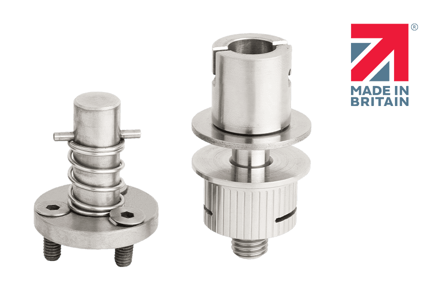

'Twist n Fix' Arbor
The Polishing and Honing 'Twist n Fix' Arbor allows you to attach a mop, felt wheel or profiling wheel to the Axminster Professional Ultimate Edge sharpening machine. It comes in two parts, a carrier with a 12mm shaft and the detachable 'Twist n Fix' mop arbor. The carrier bolts onto your Ultimate Edge sharpening machine (mounting hardware supplied).

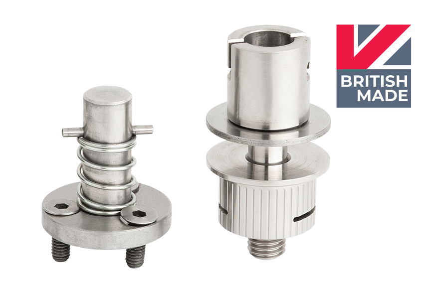

Additional 'Twist n Fix' mop arbors are available as a single item or in packs of three
Additional Mop Arbors makes the polishing process quick, safe and simple. It’s best practice to use a separate mop for each different grade of polishing compound. The mops, felt wheels etc should always be used in order, working from coarse to fine compound. With each mop etc mounted on its own 'Twist n Fix' Arbor you can change them in an instant.

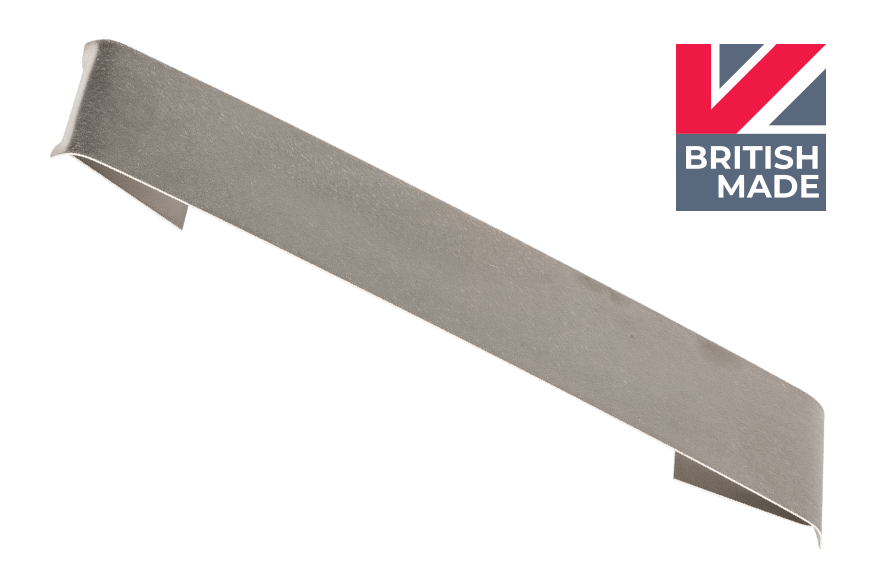

Steel Slip Plate
When sharpening certain tools, such as wide flat bevels, it helps to have a firmer surface. This simple piece of thin steel clips onto the platen of the Ultimate Edge and covers the graphite slip plate. While the graphite slip plate helps the abrasive belt move evenly, there are times when a firmer surface may be required and this robust plate provides that in an instant.
