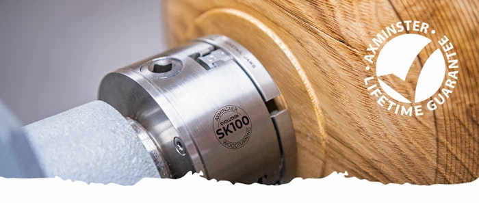

  • Manufactured entirely in Axminster, UK
  • Square key for positive location and extra torque
  • Stainless steel body for maximum corrosion resistance
  • Direct threaded chuck body ensures concentricity
  • CNC manufacturing for superb accuracy
  • Supplied with soft grip chuck key
  • Fitted with SafetyJaw© accessory mounting jaws
  • 114mm (4.5") diameter
  • Lifetime guarantee

Stainless steel & worthy of super precision status
We are mindful that chucks can corrode so stainless steel is the perfect choice of material for the chuck. Other chucks are plated which requires the chuck to be made undersized and accept the plating process to bring it into tolerance. The Evolution SK114 is not plated but is machined to tolerance for a perfect fit of both jaws and lathe mandrel.
By machining the scroll register and cutting the thread all in one operation, we can ensure that no errors arise in concentricity. In fact there is no perceivable error in this process. Our jaws are machined to within 2 microns, giving us accuracy worthy of super precision status.
