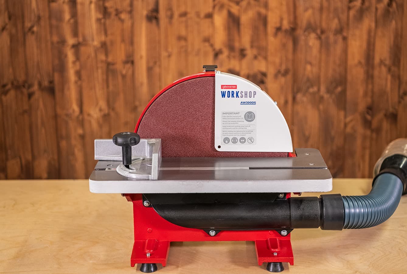

Strong and sturdy design - AW300DS

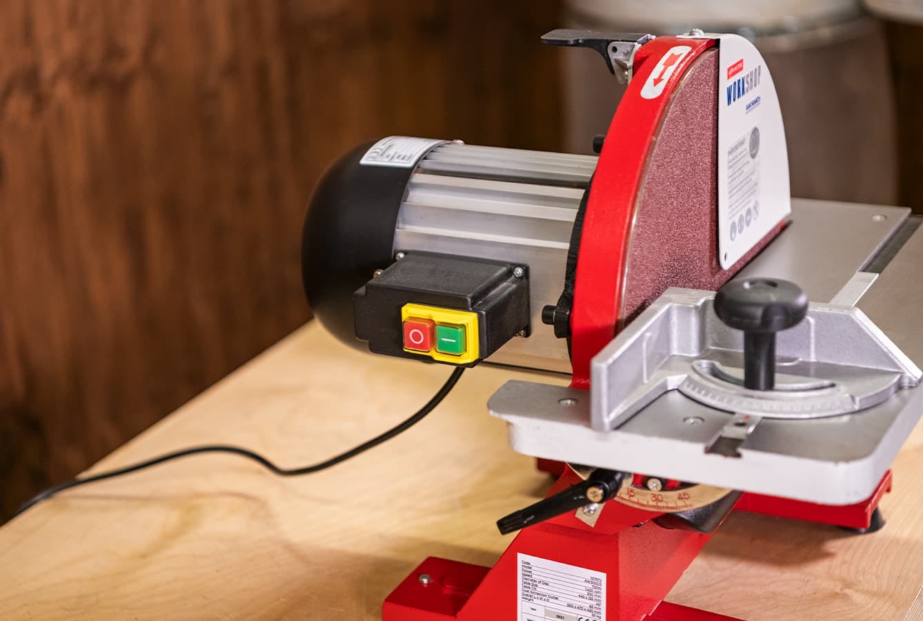

The main body is cast iron which helps to reduce vibration for a more comfortable experience.
Plenty of power - AW300DS
Plenty of power
A quiet 750W induction motor provides ample power to handle your projects, while a disc brake and NVR switch safeguard you for complete peace of mind at all times.

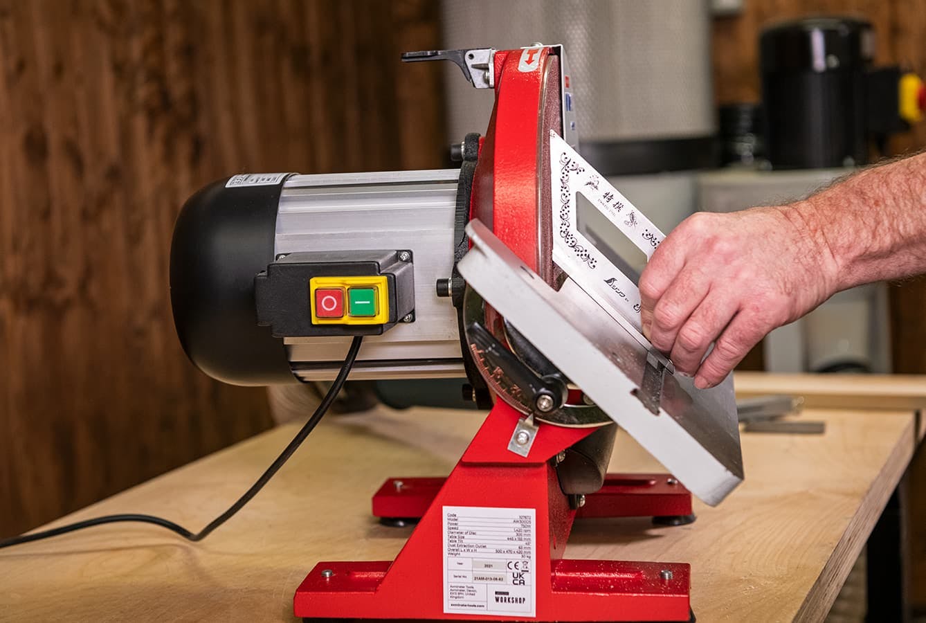

The table incorporates a mitre fence running in a slot, for bevel and compound angle sanding. Both sanding functions use a decent size work table which pivots from 0° to 45°. 

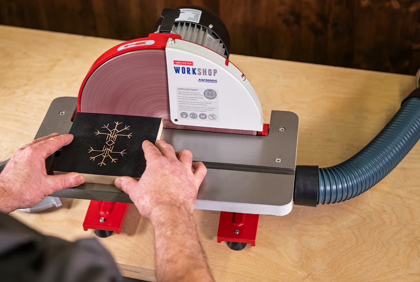

Dust extraction port - AW300DS
High levels of dust extraction
The disc is fitted with close fitting guarding, to help with efficient extraction for safeguarding health and better visibility whilst working. Plus, almost 100% dust extraction can be achieved when connected to a simple vacuum extractor.

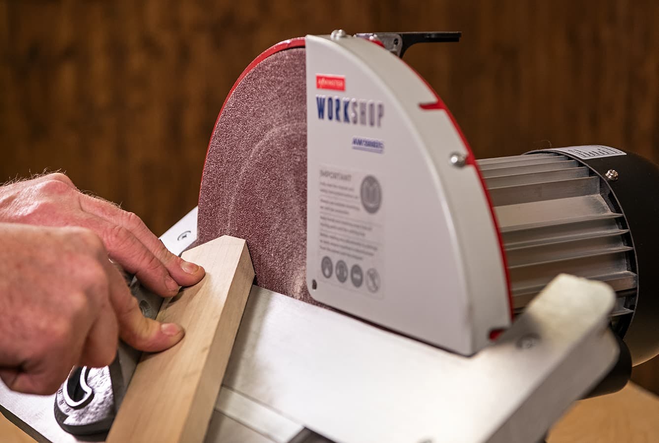

Sanding wood - AW300DS
Perfect for…
This sander is ideal for outside curves, sanding to the line, smoothing wood and plastic, removing small waste material and prepping surfaces by removing old finishes.

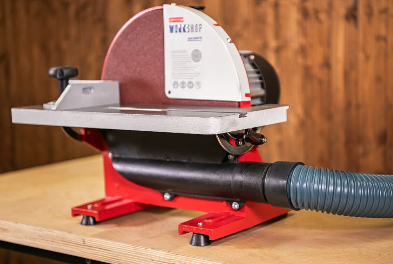

The AW300DS has an 300mm diameter aluminium disc driven by a quiet 750W induction motor. It has a no-volt-release switch and a brake to slow the disc down in a reasonable time.
The cast iron sanding table has a ground top surface with a slot for the mitre fence. The unique mitre fence has two faces at 90 and can produce LH and RH 45 bevels without resetting. The table tilts up to 45 and firmly locks at both sides.
Efficient dust extraction is via a 63mm outlet. A 450mm length of flexible hose is provided with the machine for connection to a vacuum or similar extractor.
