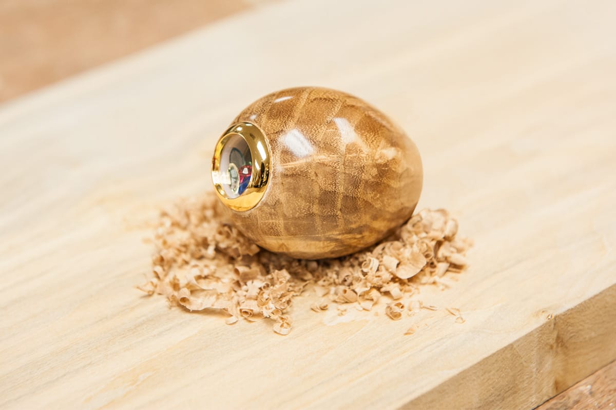

Eggoscopes, or egg shaped kaleidoscopes are a great gift all year round! An unusual, yet easy to make design that’s guaranteed to keep children (and adults) entertained.

Eggoscope Blank
