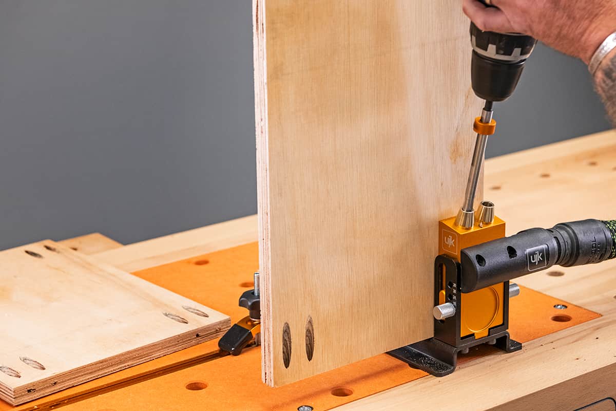

Pocket hole joinery - Fast, clean, concealed
Pocket hole joinery uses angled pilot holes and specialised screws to pull parts together tightly. It’s ideal for carcass work, frames and rapid assembly.
Where it excels
  • Face frames and cabinet carcasses
  • Workshop storage and fixtures
  • Furniture aprons and stretchers
  • On‑site fitting and retrofit jobs
Pro tip: Match screw thread to material (coarse for softwoods/ply/MDF, fine for hardwoods), use clutch control to avoid over‑driving and add PVA where long‑term strength matters.
