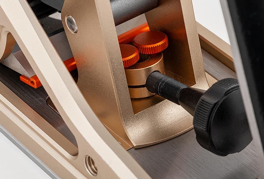

Adjustable mouth
The iron is engaged to the depth adjuster via a pin nut attached to a 0.5mm thread pitch lead screw. One full revolution of the lead screw increases the depth of cut by 0.1mm.

Adjustment for the depth of cut is via a modified Norris mechanism with a 0.5mm thread-pitch lead-screw for super fine control. The lead screw sits in a solid brass split pivot nut, resulting in a backlash free mechanism that is adjustable by hand. Moving the lead screw knob left or right controls lateral blade alignment.
