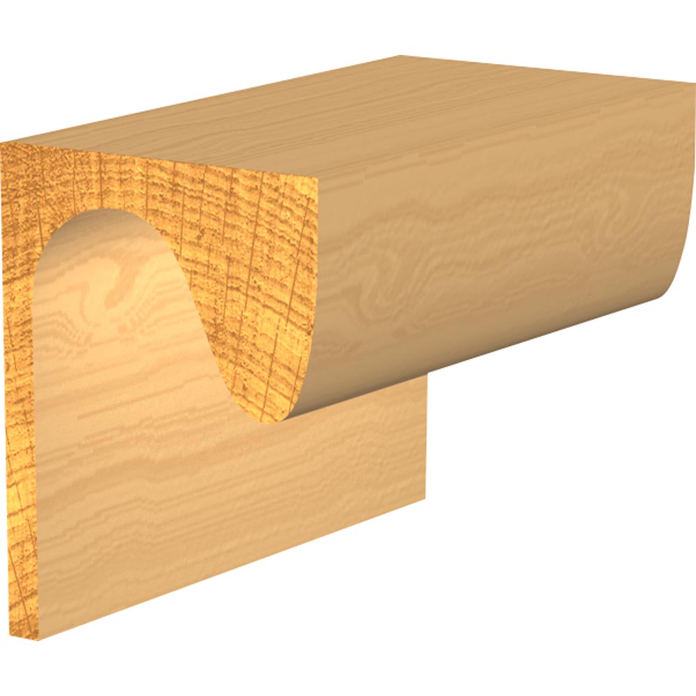

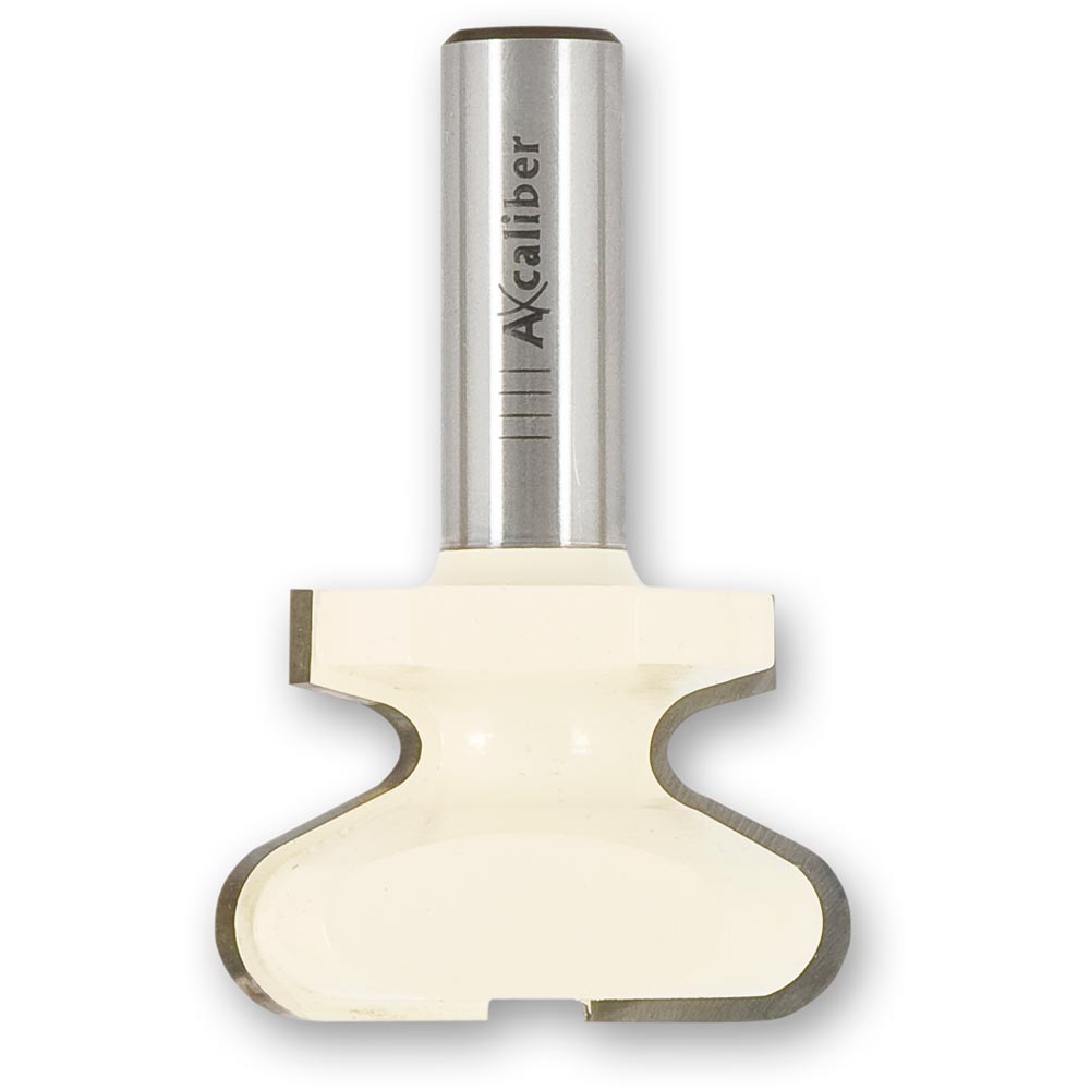

  • Cuts a clean, neat finger groove
  • Removes the need to have protruding handles
  • Use on drawers and cabinet doors
  • Precision made on multi axis CNC machines
  • High shear-cut angle for cleaner finish
  • PTFE coating helps cutter to remain free of resin
  • 1/2 shank
Drawer pull cutters offer the opportunity to create flush fitting cabinet doors and drawers and are easier to use if used in a router table set-up. Drawer pull cutters remove the need to have protruding handles on your cabinets.
Axcaliber router cutters are high precision tooling, made using advanced technology on multi axis CNC machines. A high shear-cut angle gives them a smooth cutting action and results in a clean finish. The tips are diamond-ground micrograin tungsten carbide. PTFE coating minimises resin build-up.
Shank Diameter 1/2" (12.7 mm)

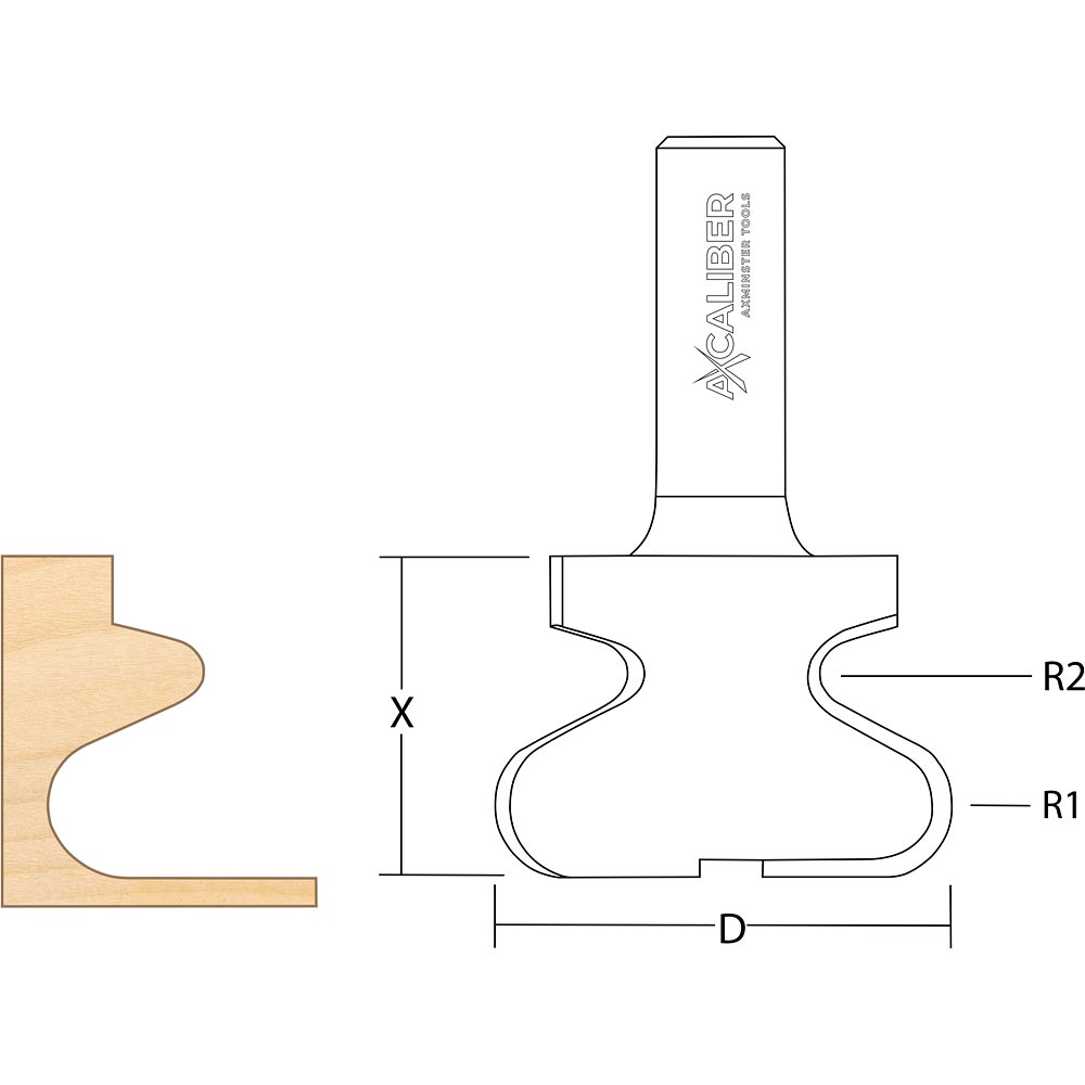

X = Depth of Cut 28.6 mm (1.1/8")
D = Overall Diameter 44.5 mm (1.3/4")
Web Attribute Set Drawer Pull & Keyhole & Mitre Lock Router Cutters R1 = Radius 1: 6.35 mm (1/4) R2 = Radius 2: 3.2 mm (1/8) D: 44.5 R1: 6.35 R2: 3.2 X: 28.5
