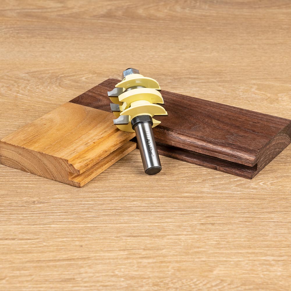

  • One cutter produces both the moulding and scribing cuts
  • Excellent for custom made kitchen cabinet doors
  • Attractive ogee style profile
  • High shear-cut angle for cleaner finish
  • PTFE coating helps minimise resin build-up
  • This cutter is for use in router tables only

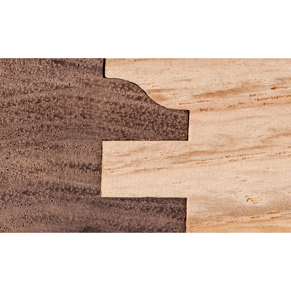

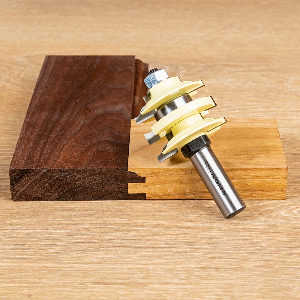

This Axcaliber stile and rail cutter offers an attractive ogee style profile with the advantage of having just one cutter for both the moulding and scribing cuts. Excellent for making your own kitchen cabinet doors. Please note that for reasons of accuracy and safety these cutters should only be used in a router table. The timber should be positioned to face down on the table for the profiling cut and face up for the scribe cut.

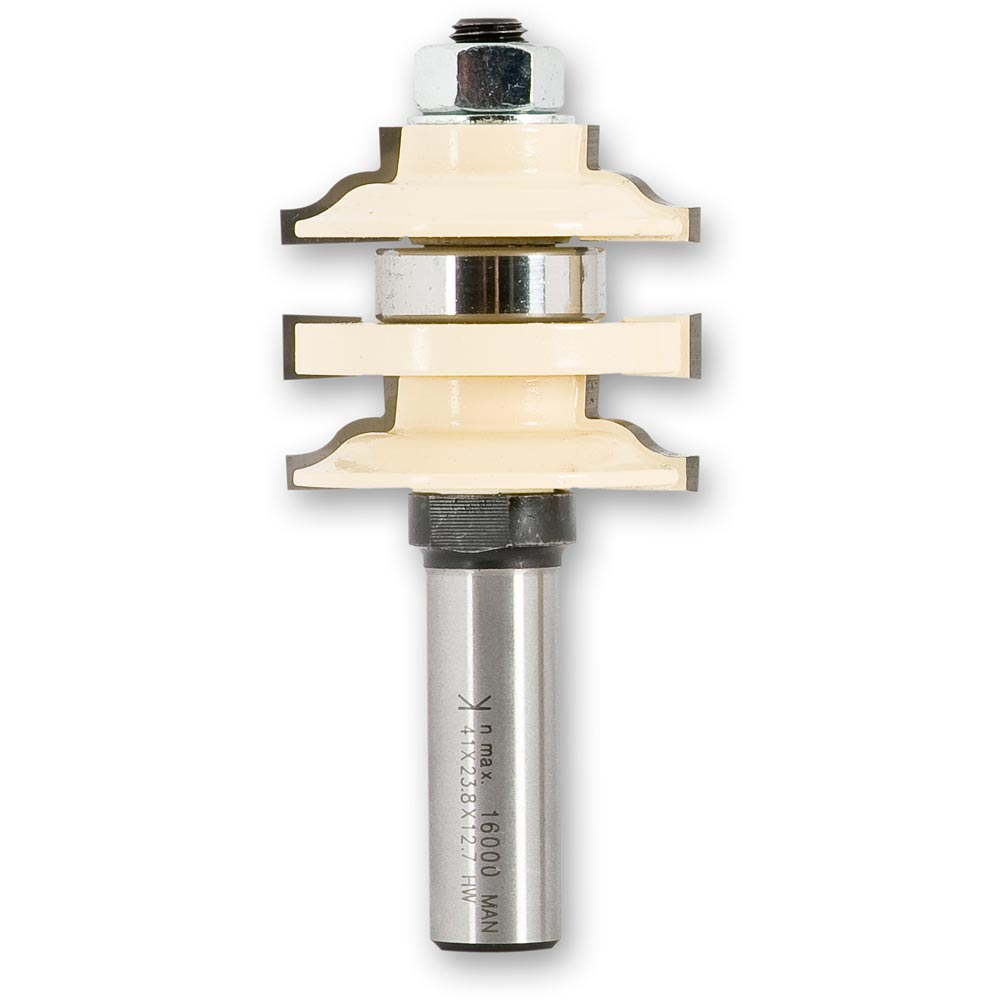

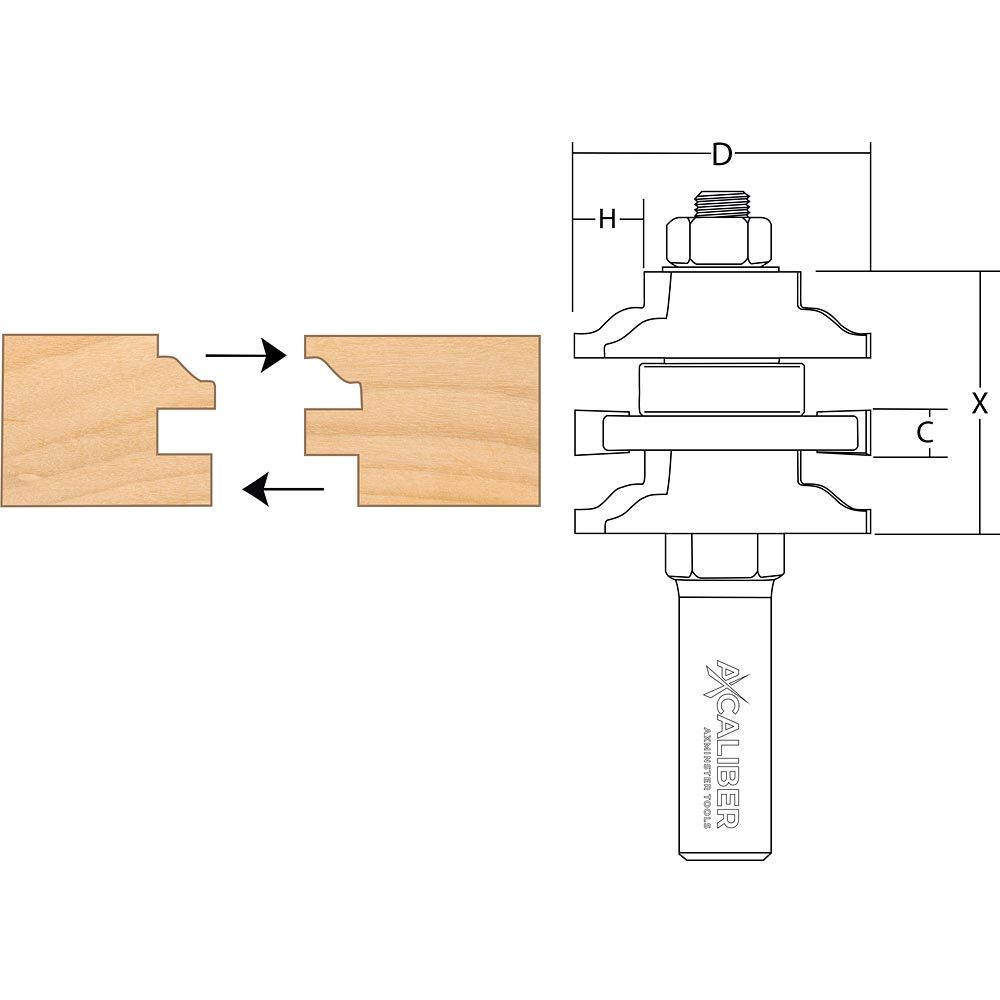

Shank Diameter 1/2" (12.7 mm)
X = Depth of Cut 23 mm
D = Overall Diameter 41 mm (1.5/8")
C = Width of Groove 6.35 mm (1/4) H = Horizontal Depth of Cut: 9.5 mm (3/8") Web Attribute Set: Profile Scribing Router Cutters C: 6.35 D: 41 H: 9.5 X: 23
