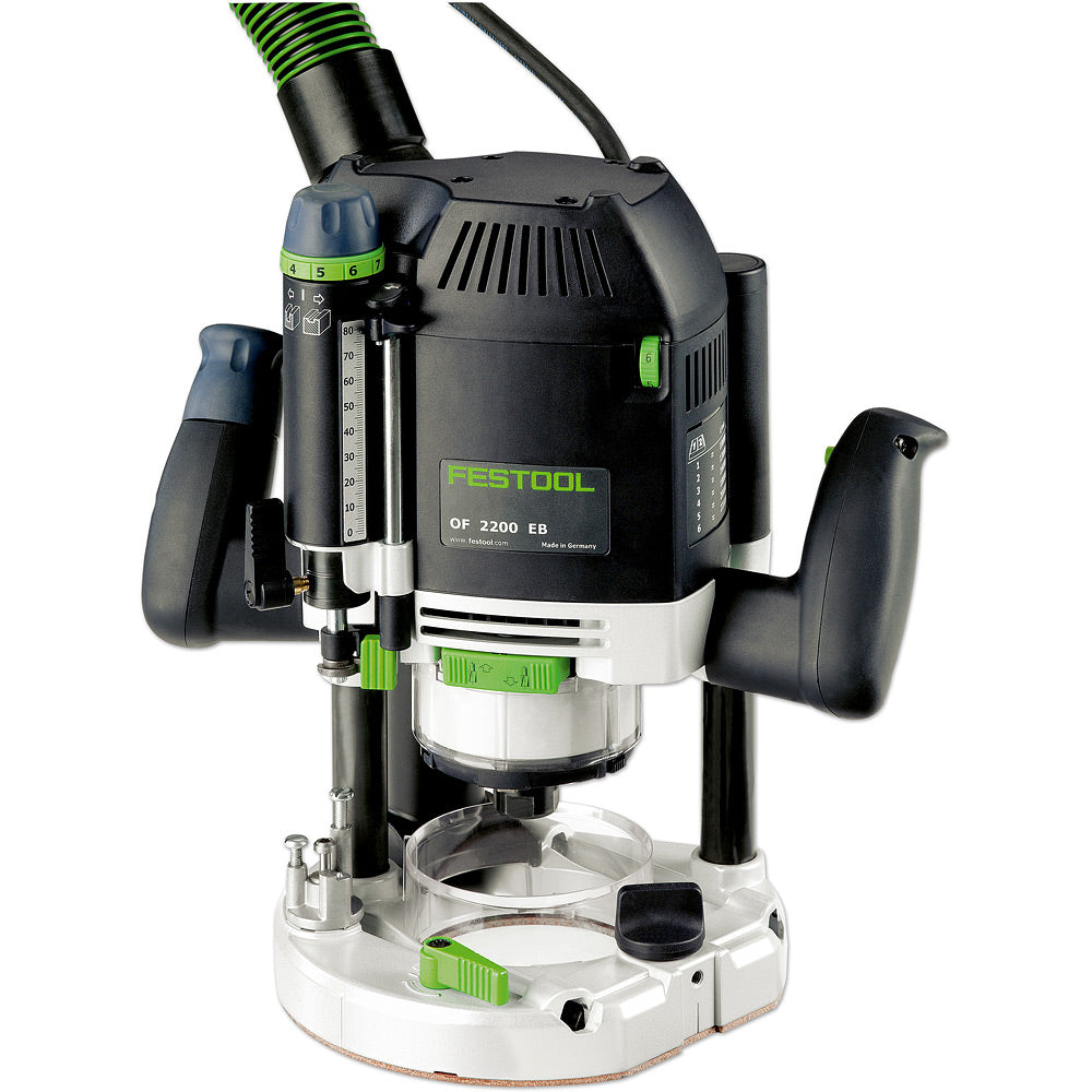

  • Highly precise powerful 2200W router
  • 10,000-22,000 rpm
  • Exact fine adjustment in 1/10mm steps
  • Powerful low end torque for clean cuts every time
  • 80mm plunge stroke

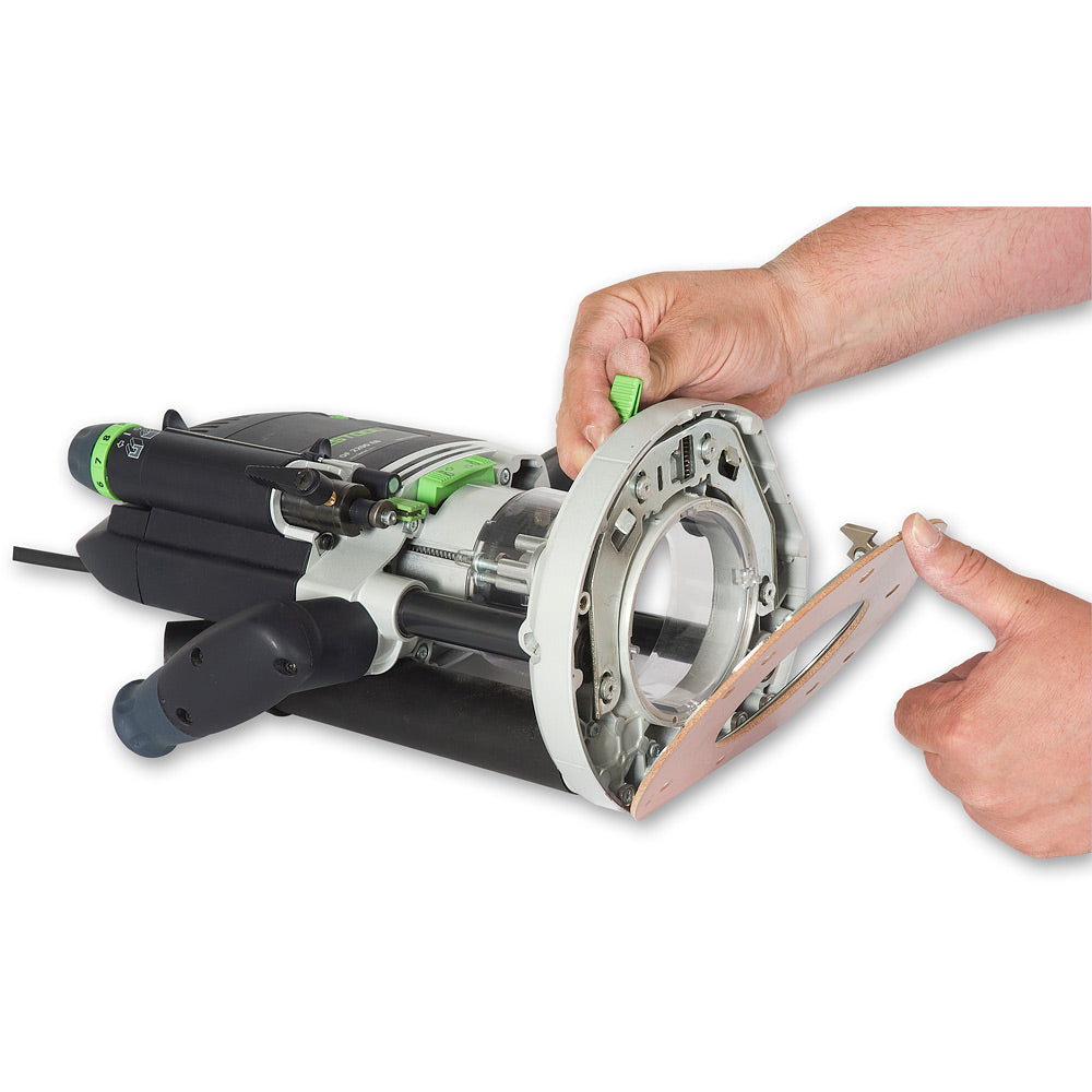

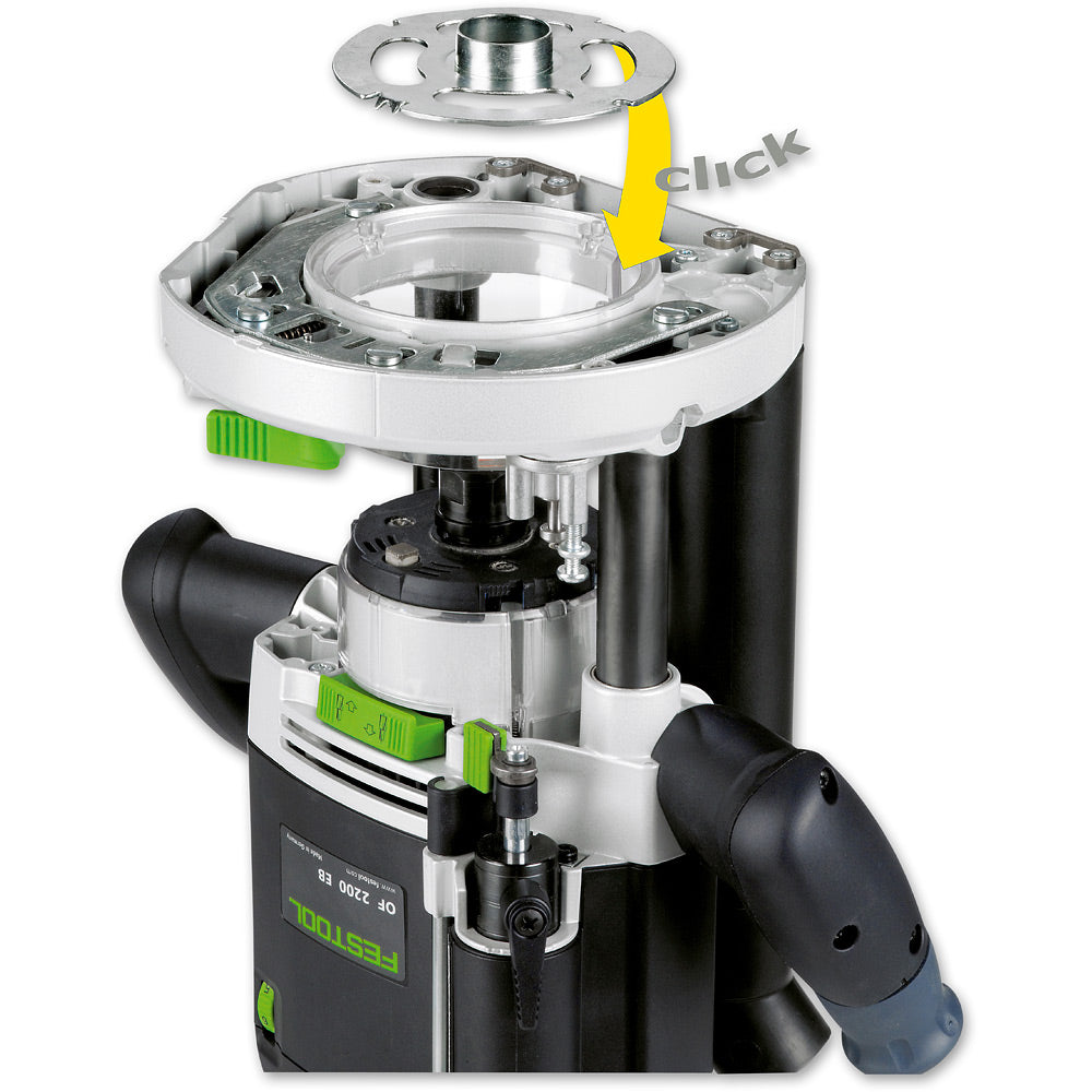

  • Tool free base changing
  • Router accessory kit also available
  • Supplied in a Festool T-LOC SYSTAINER case
Features include enormous cutter depth range of 80mm, quick height adjustment and an exact fine adjuster in 1/10mm steps with a zero function. Fine adjuster can also be locked to the base allowing easy base adjustment to the cutter. Once set the lock on the handle clamps to both columns simultaneously for total accuracy. The innovative dust extraction system ensures that a very high level of waste is removed with a combination of extraction ring, chip catcher and exhaust adaptor. The extraction ring is cleverly controlled from the handle to allow you to view the cutter for position, then lowered for extraction. The spindle lock has a rocker and ratchet system for fast cutter changing and the base can be changed without tools. When used with a guide fence or a guide rail the rods are offset at 30 to the machine for safer, easier, guiding and working.
Supplied with 1/2 and 1/4collet, 30mm guide bush, chip deflector and spanner in a Festool SYS M337 SYSTAINER® storage case.
