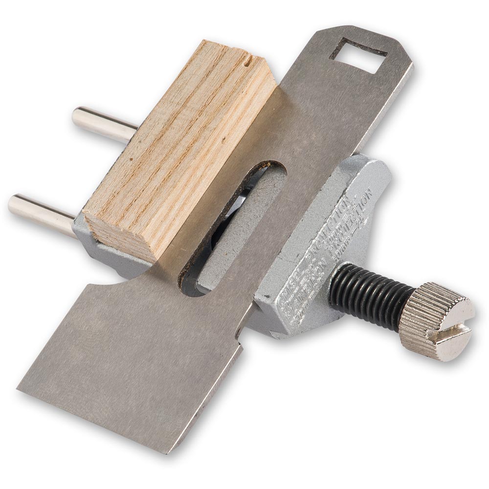

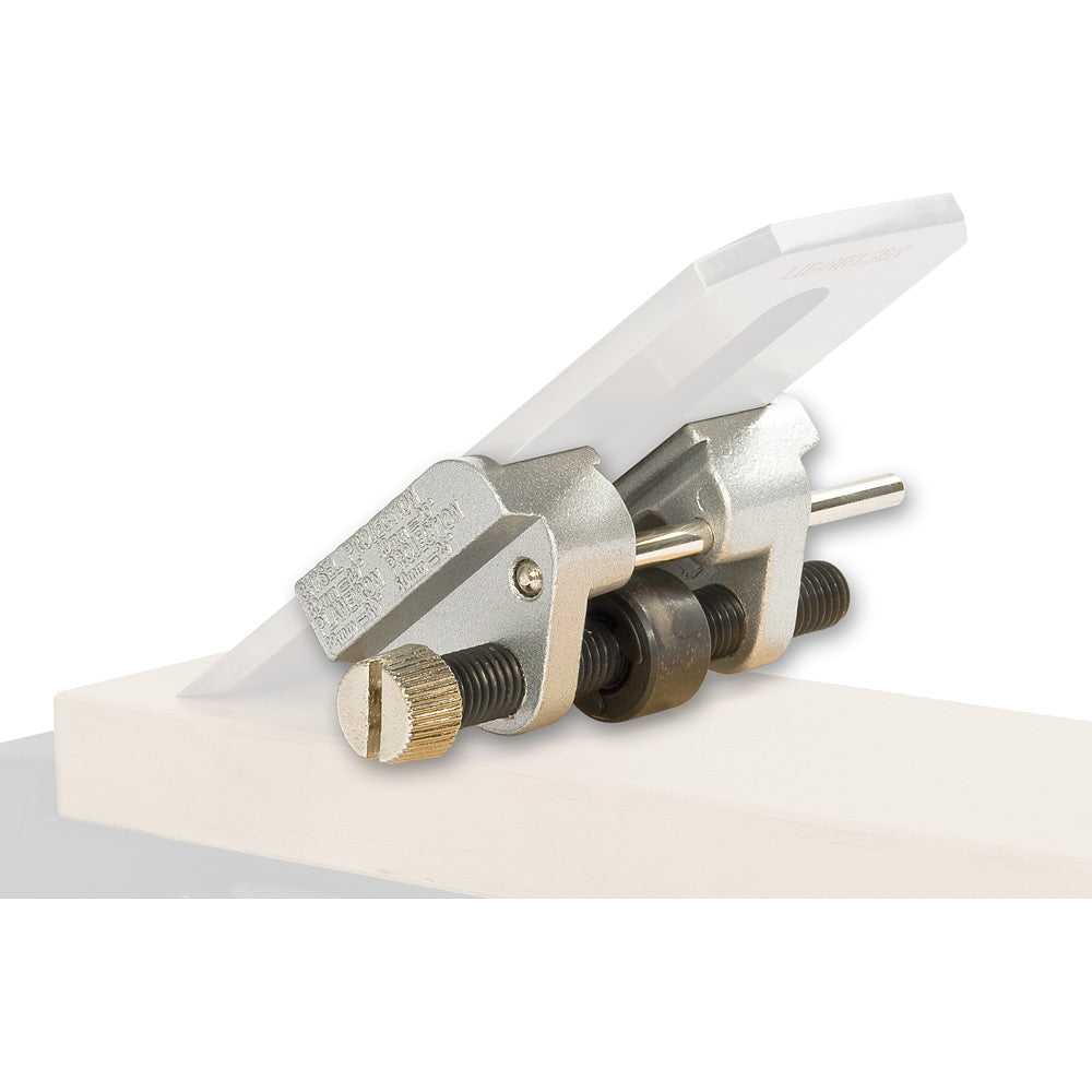

The Axminster honing guide is very similar in design to the classic Eclipse 36. It is an ideal tool for achieving a consistent bevel angle, everytime you sharpen a blade.

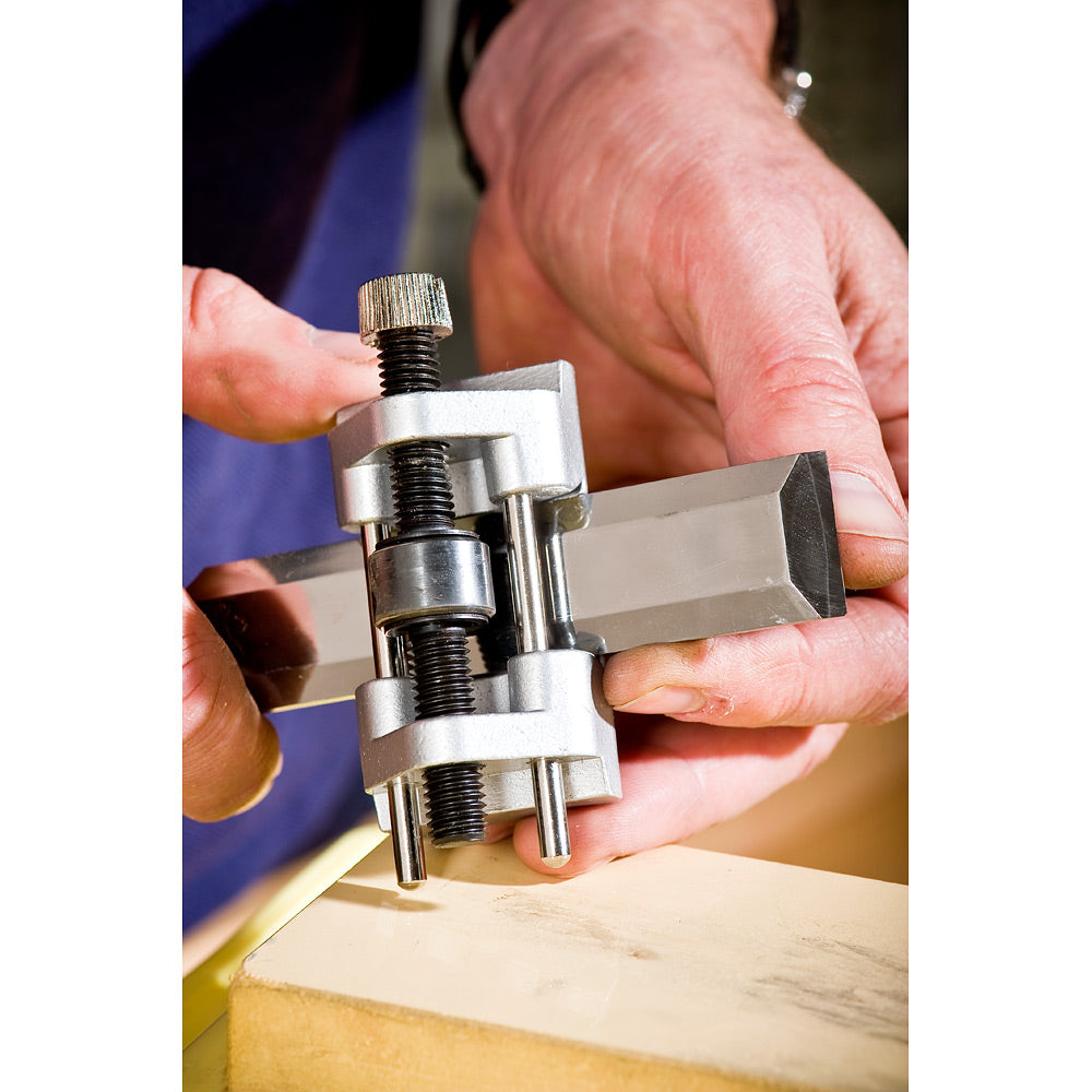

The guide offers two tool-clamping positions. The upper jaw accommodates blades up to 78mm(3-1/8) wide. A lower V-groove secures bevel edge chisels or thin tools from 3mm(1/8) to 48mm(1-7/8) wide.

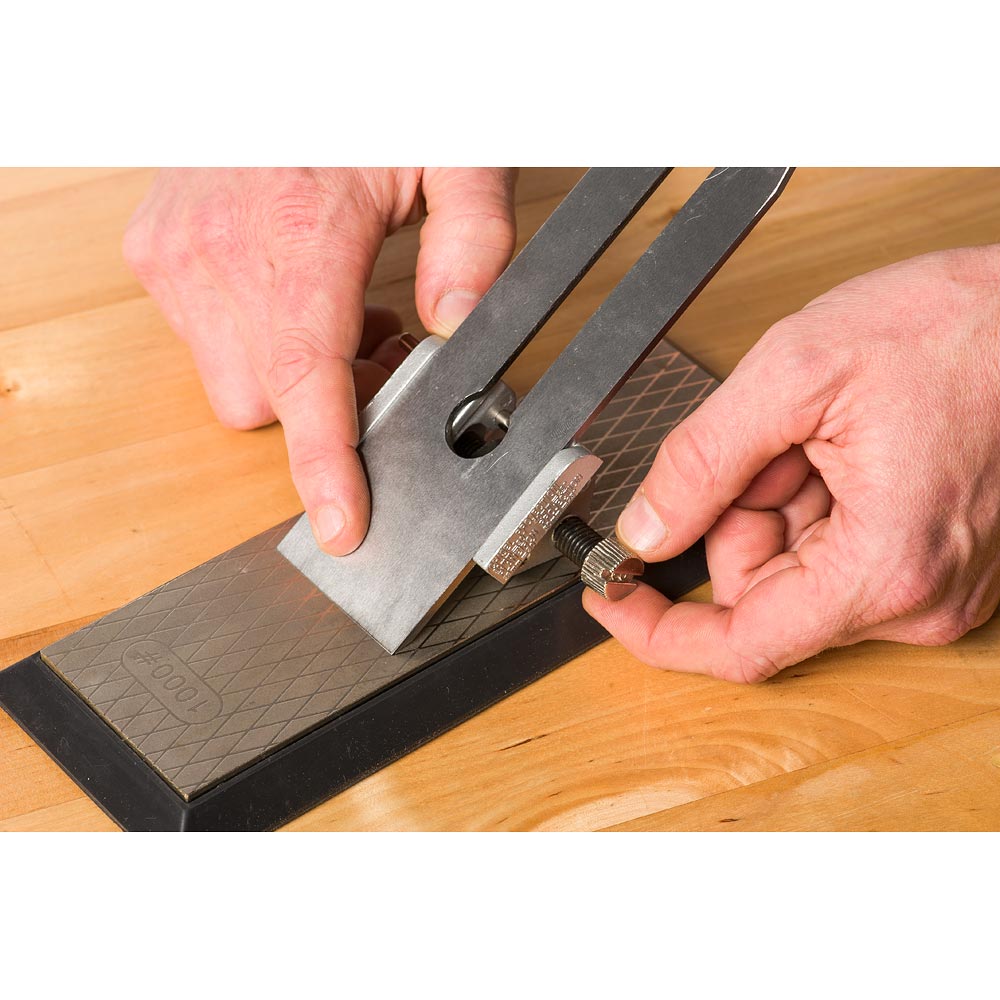

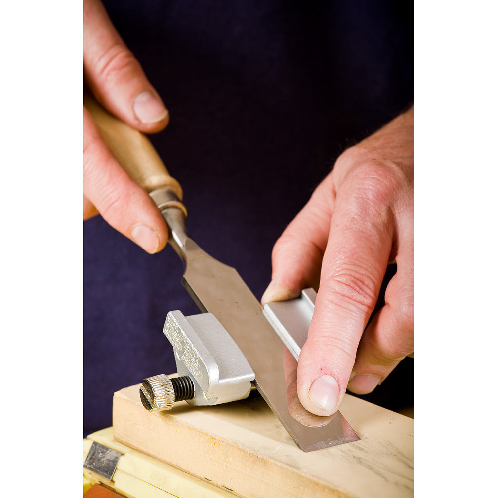

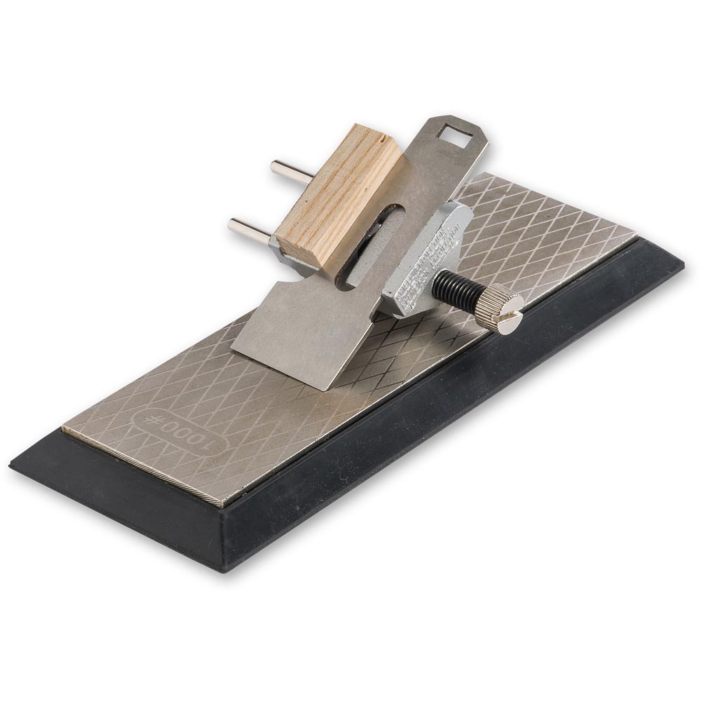

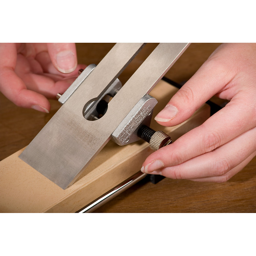

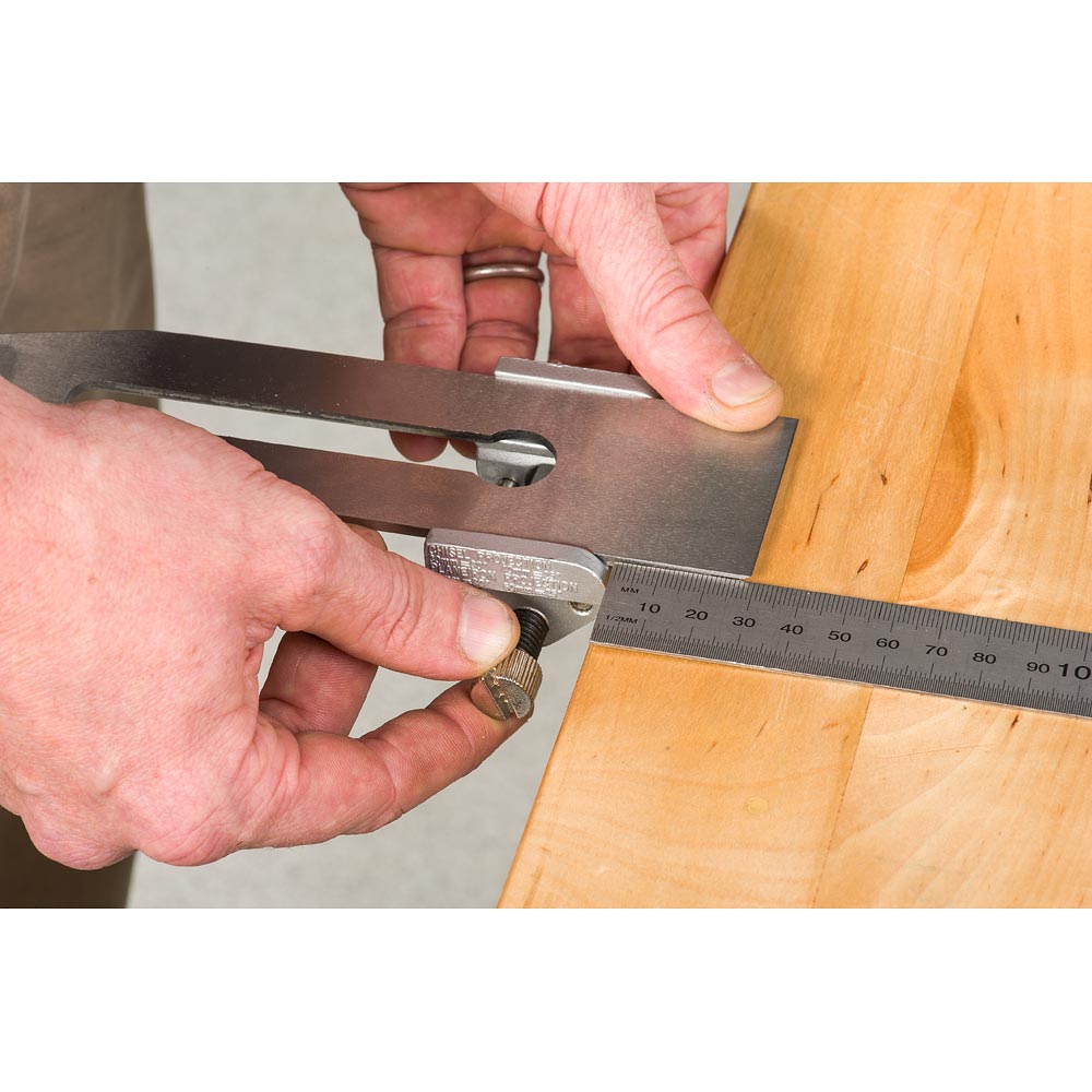

The bevel angle depends on the blade's projection in front of the guide. Typically, plane irons in the upper jaw: 50mm(2) gives 25 and 38mm(1-1/2) gives 30. Chisels or blades placed between the lower jaws: 40mm(1-9/16) for 25 or 30mm(1-3/16) for 30. We recommend constructing a very simple jig to make setting quick and simple. Using a jig will guarantee consistent bevel angles everytime you sharpen.

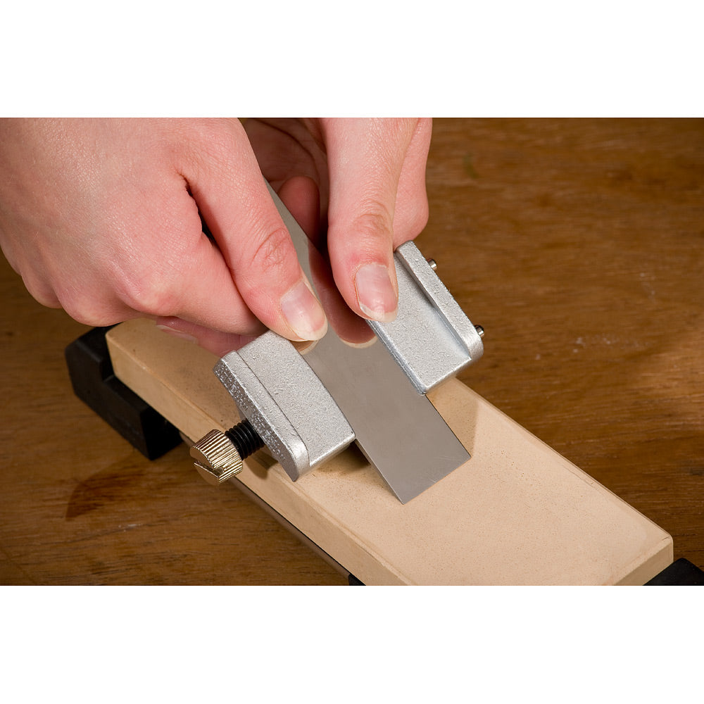

The guide’s 19mm(3/4) diameter by 12mm(1/2) wide roller allows you to hone both straight cutting edges or, by slightly rocking the guide, put a crown on an edge.
