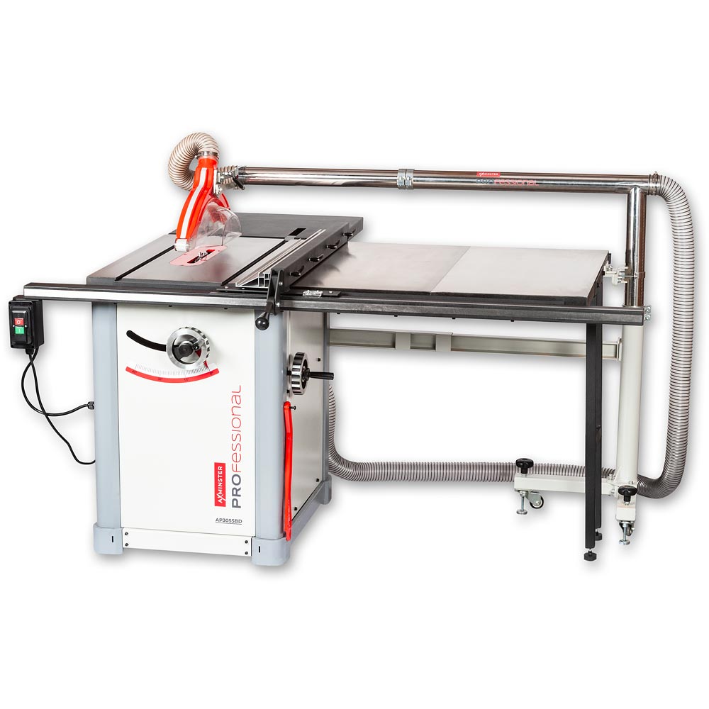

The AP305SBD boasts an impressive 103mm depth of cut and a generous ripping width of 1,300mm with the included right hand extension table. It's constructed on a heavy gauge steel chassis, with a cast iron table on top, providing smooth machining and reduced vibration over a long machine lifespan. The trunnion assembly and motor are mounted independently on the chassis rather than the table, relieving stress on the underside of the table and ensuring the table remains flat over time.
The AP305SBD is supplied with twin extension tables which can be configured in multiple ways, increasing it's versatility. Both tables can be mounted on the right hand side, offering an extended surface area which is ideal for cutting larger panels. Alternatively, it can be set up with the tables either side of the saw, making the AP305SBD into a more conventional cabinet maker's saw bench.

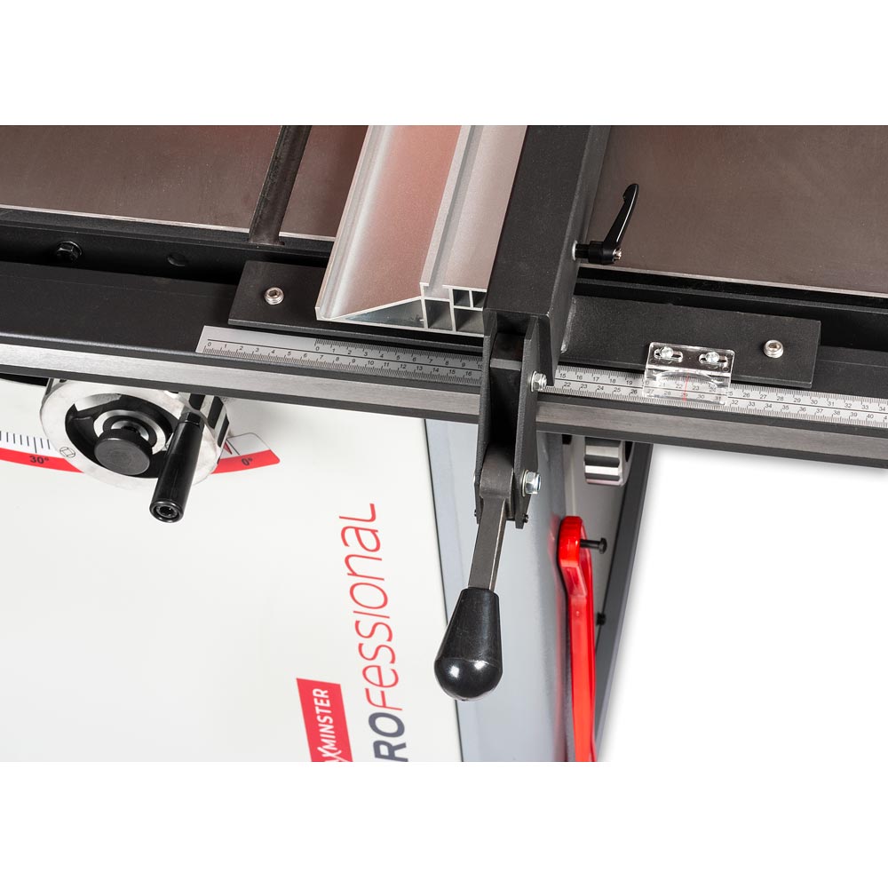

A quality mitre fence runs in T-slot grooves provided on both sides of the blade. The full length fence is a rigid T-style which locks at the front, adjustment is smooth and easy. The rip fence comes with a Hi/Lo aluminium auxiliary fence, for ripping and close to the blade work.

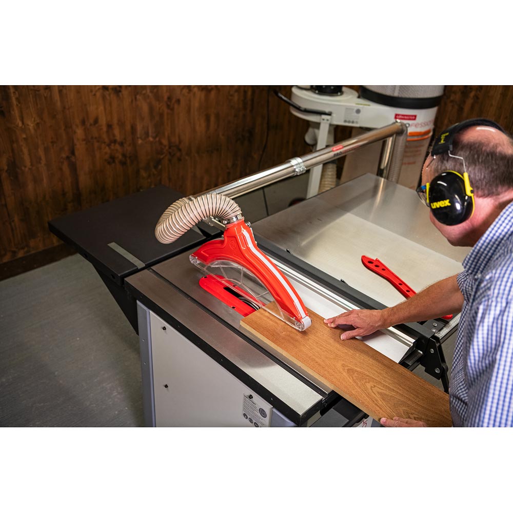

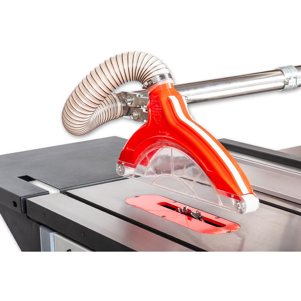

The 2.5kw induction motor offers the power needed. Two point dust extraction is via a 63mm connection on the blade guard hose combined with a 100mm outlet at the rear of the machine. Connection to a suitable extractor is recommended.

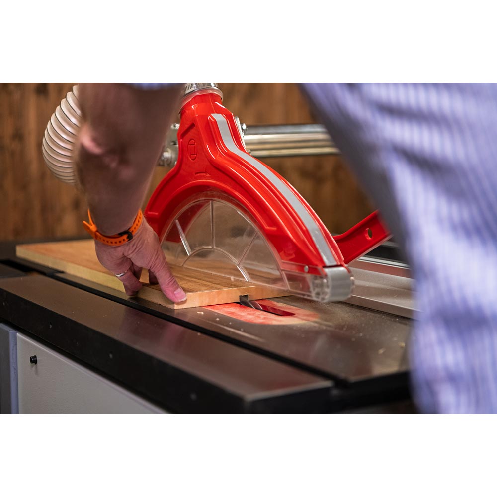

Supplied with this dado saw, the Overhead Crown Guard is recommended by HSE for improved user protection and is a must when using a dado blade. The overhead guard hinges back for easy access to the blades and the clear hood offers non restrictive views to the blade during cutting.

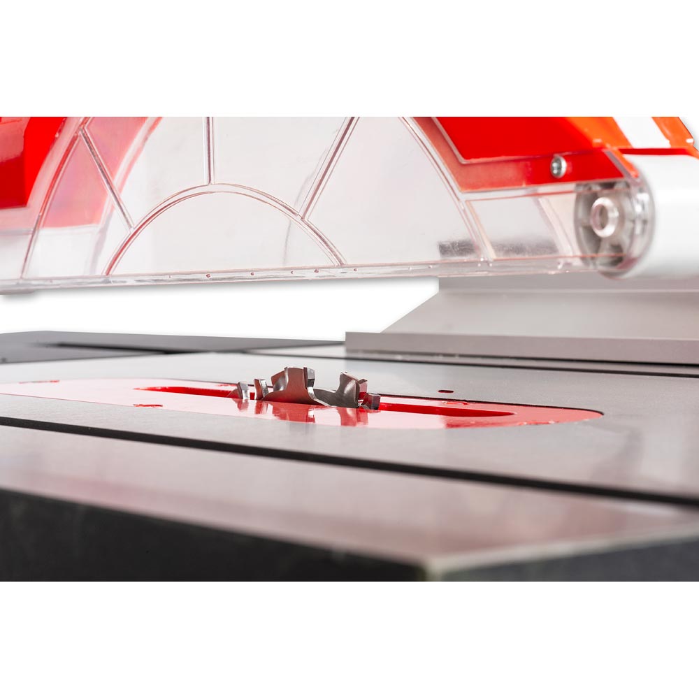

The included 200mm diameter Dado Blade Set comprises 2 x 24 tooth TCT outer blades, 6 inner chipper blades and 4 shim spacers. The chippers and spacers fit between the outer TCT blades. Simply select the inner chippers and spacers needed to cut the width of the slot you require. The outer blades have a 3.2mm kerf. The inner chippers are 4 x 3.0mm, 1 x 2.2mm and 1 x 1.5mm. The spacers are 2 x 0.4mm and 2 x 0.3mm. The dado head should never be used to cut all the way through the timber, it is for machining grooves only, using light, multiple cuts. This saw is also provided with an Axcaliber TCT general purpose blade.
