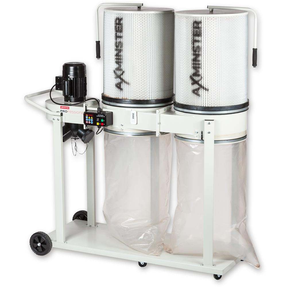

Axminster Professional AP2200DE Dust Extractor 3HP
SKU: 113339
€800,00
  • Extracts chippings, coarse and fine wood dust
  • Steel impeller ensures long service life
  • Two 153L bags for increased waste collection
  • Suitable for use with sanders, saws, planers etc
  • Dependable airflow of 2544 m3/hr @ 152mm
  • 1 x 150mm or 3 x 100m dust extraction ports
  • Time delay feature to clear any dust remanence
The Axminster Professional AP2200DE Dust Extractor is a reliable and efficient dust extractor designed for professional use. Built to deliver consistent performance, it combines effective dust collection with features that make day to day operation convenient and easy. Best suited for larger workshops that demand higher extraction capacity.
The machine is powered by a 2.2kW motor, and features a balanced steel impeller ensuring long service life and dependable airflow of 2544 m3/hr @ 152mm. The cartridge filter provides fine filtration down to 99% > 1 micron and increases the potential use of the machine to include sanders, as well as saws, planers etc. The hand crank filter paddles allow easy and quick filter changing.
Featuring two 153L bags, the extractor is fitted with bag clips and quick fit straps for simple bag changes. The main 150mm outlet can be adapted into three 100mm outlets, allowing you to either connect three separate machines or link more than one extraction port from a single machine. Larger wheels improve portability, making it easy to move around the workshop as required.
A particular highlight is the time delay switch with remote control. This allows you to leave the extractor running after finishing a task, helping to clear any dust remanence. The remote control makes it possible to switch the unit on and off anywhere in the workshop - even if the extractor is located outside of the working area.
N.B. This Machine requires a 16amp supply and it's recommended that a C Type breaker is used, if you are unsure please contact a qualified electrician.
Please note, if you require an EU plug, please ensure you purchase 113776
Airflow 2,544 m³/hr @ 152 mm
Filter Performance 99% 1 micron
Overall L x W x H 1584 x 653 x 1795mm
Power 2.2 kW
Rating Frequent Use
Sound Power Level LwA [Uncertainty K] 87 dB(A)
Plug Fitted UK 16A Plug
Web Attribute Set Coarse Dust & Chippings Extractors
EAN Barcode 5052511142385
