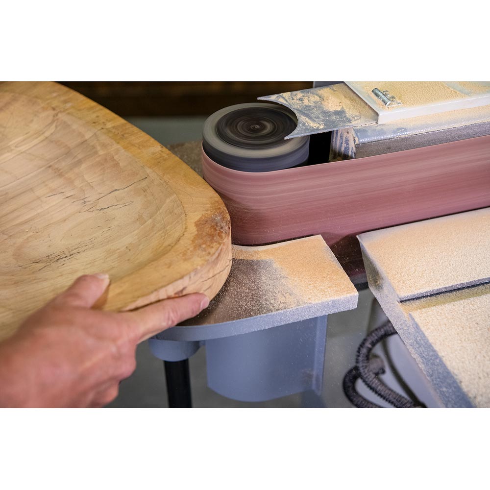

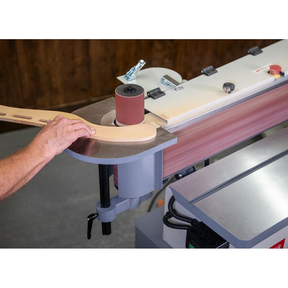

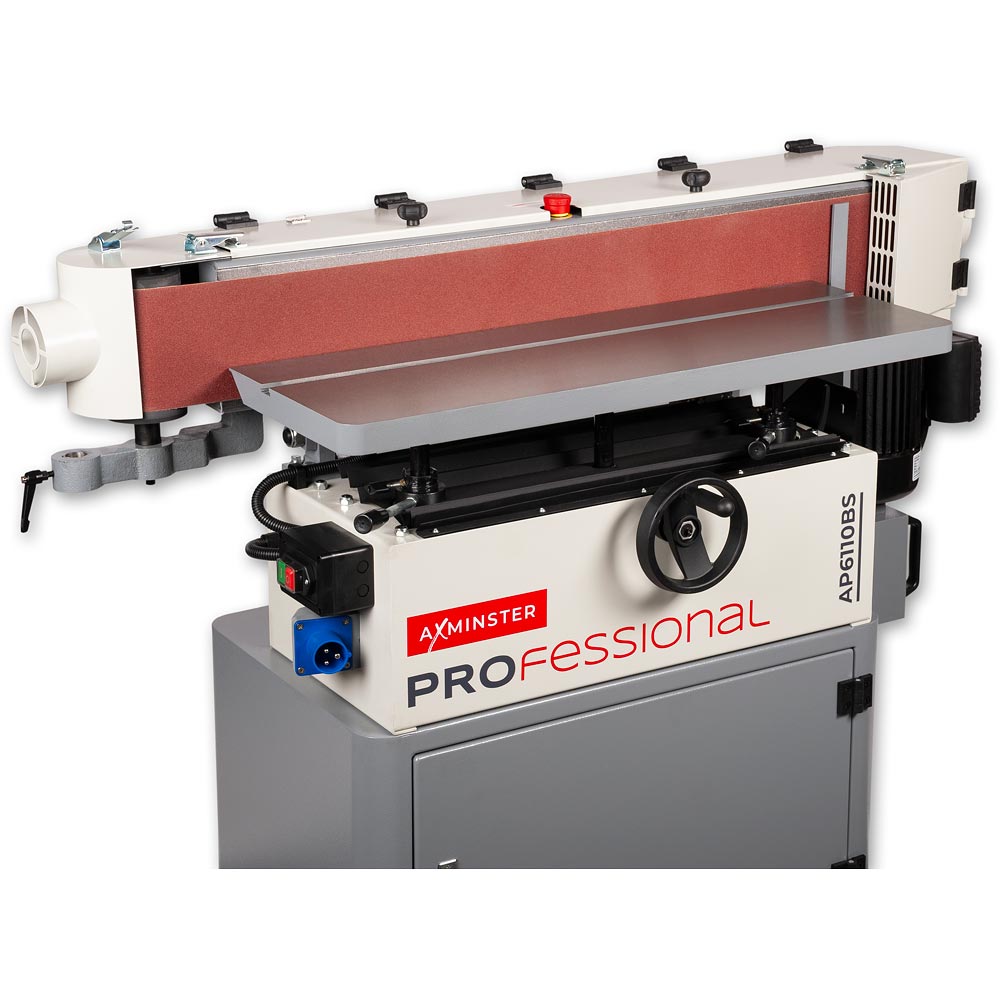

  • Combined belt and bobbin spindle in one machine
  • Heavy duty floor standing design for stability and durability
  • Large adjustable tables for larger workpieces
  • Powerful 2.2kW motor for efficient material removal
  • Oscillating belt action reduces heat build up

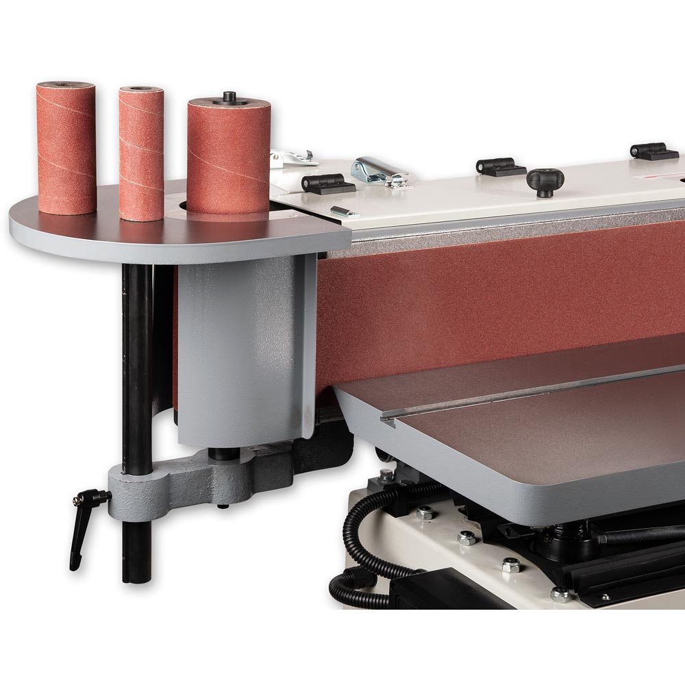

  • Supplied with 38, 50 and 75mm bobbins

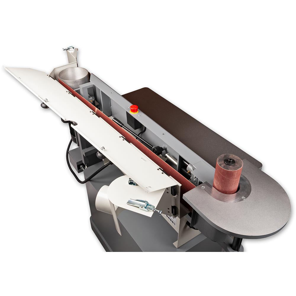

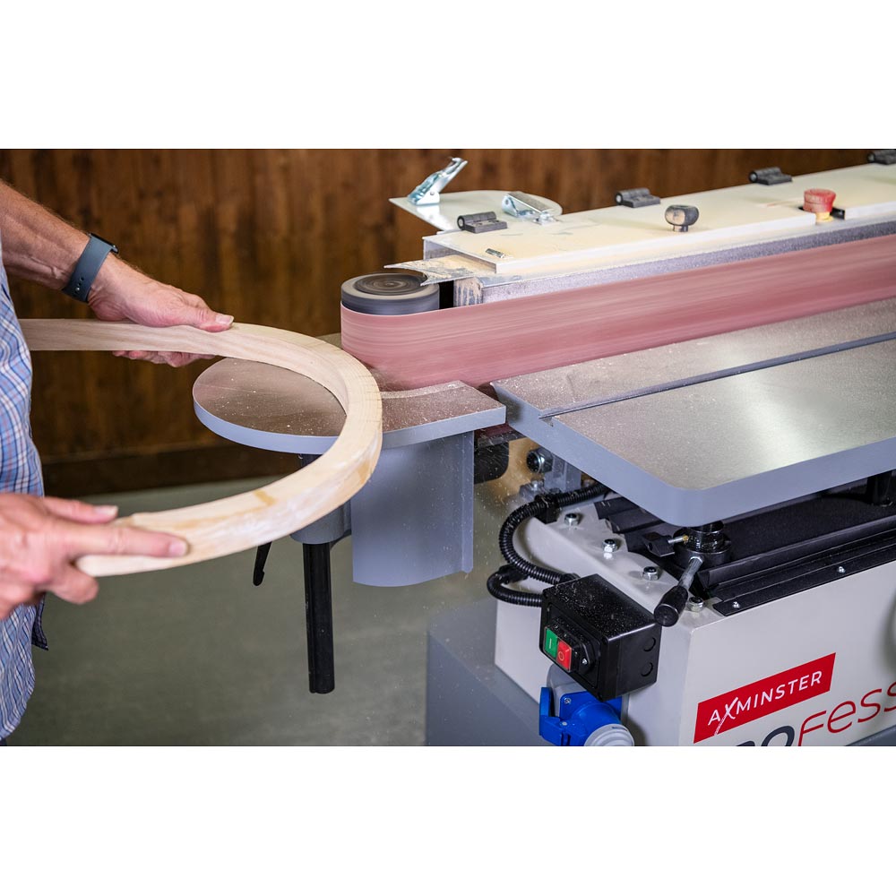

Built for high output workshops and demanding use, the Axminster Professional AP6110BS Bobbin Belt Sander combines bobbin spindle and belt sanding capabilities in a single versatile machine. Ideal for shaping, smoothing and finishing both curved and straight workpieces, its dual function design allows flat edge and contour sanding without the need to switch between machines. Perfect for joiners and furniture makers who require accuracy, versatility and durability.

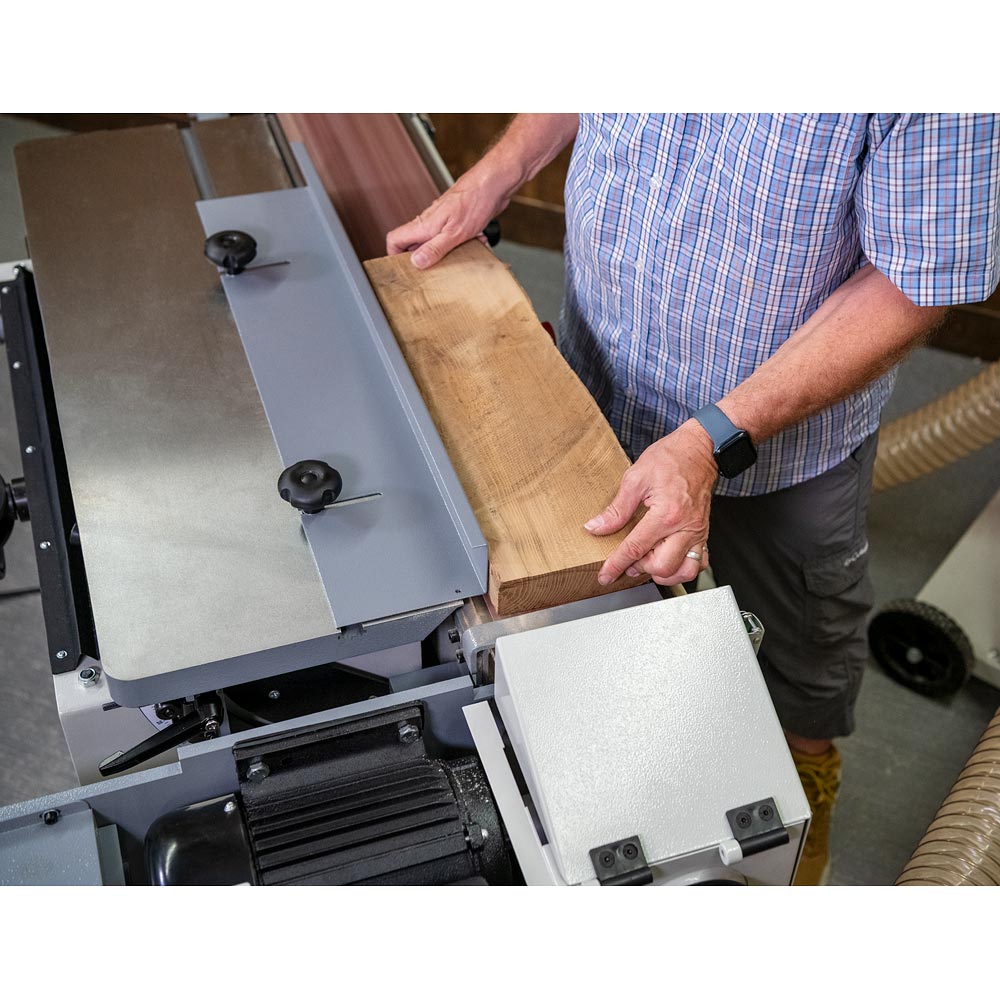

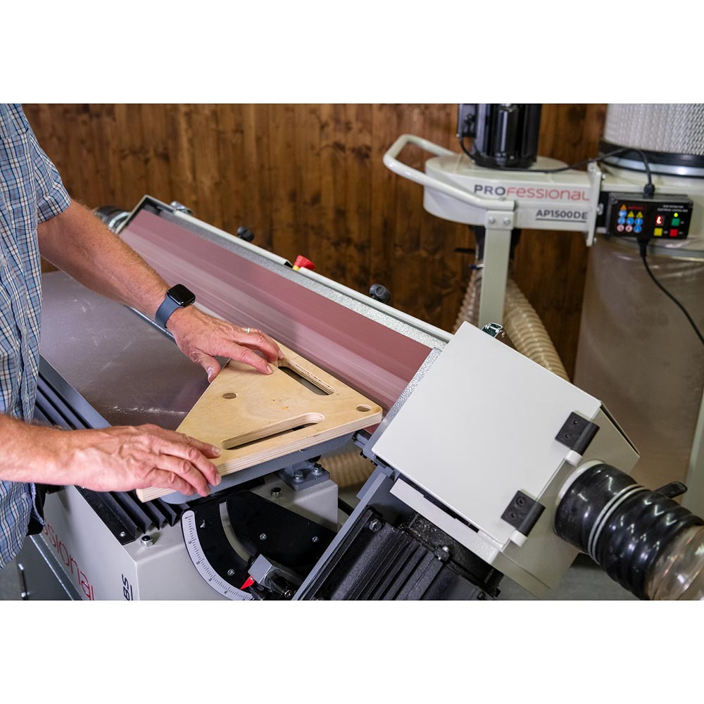

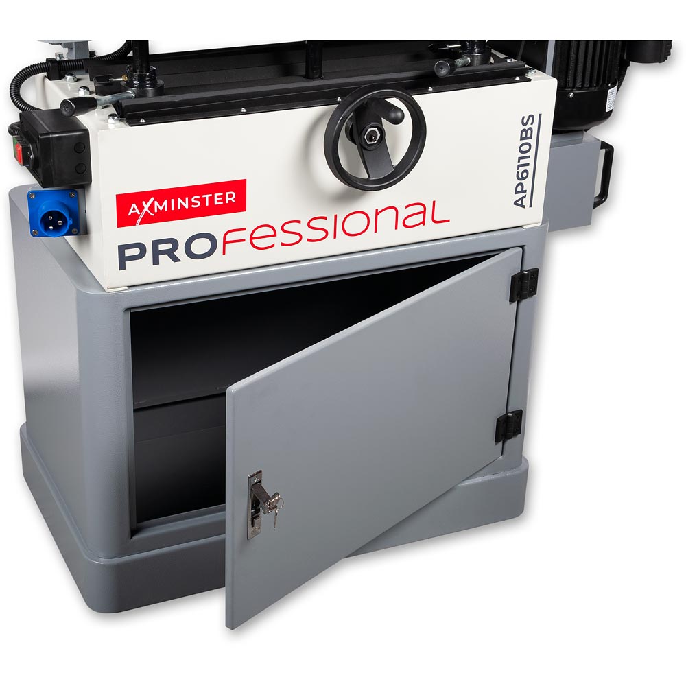

The robust floor standing construction minimises vibration for smooth, stable operation, while the heavy duty build quality ensures long term reliability in busy workshop environments. Generously sized tables provide excellent support for larger workpieces, with the 1,010 x 190mm belt sanding table offering 100mm of vertical travel and the 290 x 260mm bobbin table positioned at a comfortable 920mm working height. Both tables are adjustable in height, helping to maximise abrasive life and get the most from each belt or sleeve. The belt is able to tilt to 90 for angled sanding.
Powered by a 2.2kW motor, the AP6110BS Bobbin Belt Sander delivers smooth, consistent performance for efficient material removal. The bobbin spindle runs at 1,420rpm, while the belt travels at 16m/sec, enabling fast, controlled sanding. The oscillating action on the belt helps reduce heat build-up, extending abrasive life and minimising the risk of burning the timber.
Twin 100mm dust extraction outlets support effective dust collection, helping to maintain a cleaner, safer working environment.
Supplied with three bobbin sizes: 38mm, 50mm and 75mm - the AP6110BS Bobbin Belt Sander offers the flexibility to sand a wide range of internal curves and profiles straight out of the box.
