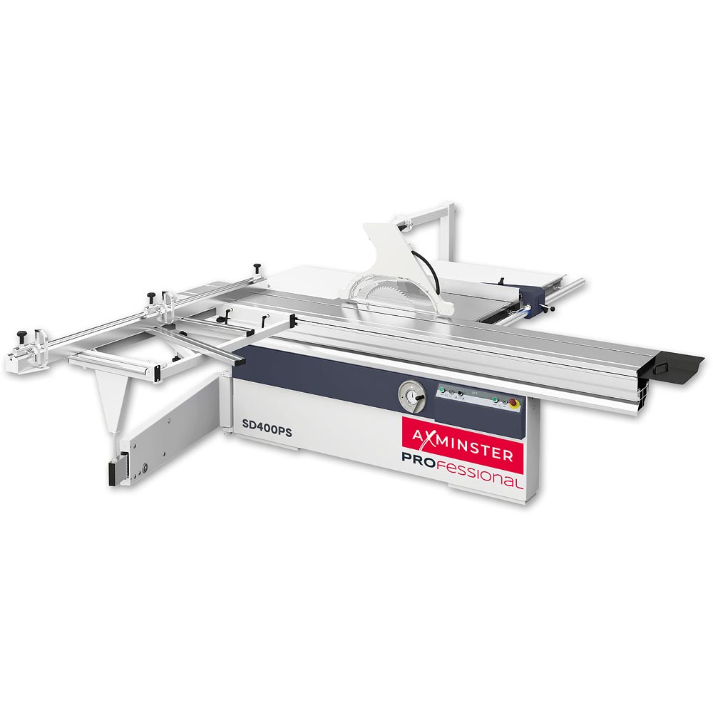

The Axminster Professional SD400PS 3,200mm Panel Saw is a highly versatile machine, ideal for sizing sheet materials, ripping solid, thick timber and producing precise angled cuts for complex joinery. Built with a heavy duty cast iron and steel construction, the saw delivers exceptional stability and vibration free performance, ensuring consistently accurate results.
A large 3,200 x 418mm sliding table, provides excellent support and smooth movement for a wide range of workpieces. The sliding table offers a full 3,200mm travel past the blade, making it easy to handle full-size sheets. The main cast iron table measures 1,020 x 690mm offering ample working space at a comfortable working height of 900mm.
Fitted with a 400mm blade running at a choice of 3,000, 4,000 and 5,000rpm, the saw can cut up to 125mm at 90° and 85mm at 45°, with smooth and precise tilt adjustment from 0-45°. This makes it equally capable of cutting thick boards and carrying out complex joinery work. Power comes from a robust 5.5kW motor, delivering clean, efficient cuts with ease across a variety of materials.
The saw unit and motor assembly are housed within a reinforced steel cabinet, isolating mechanical stress from the cast iron table. This design ensures the table remains flat over time, maintaining cutting accuracy even under heavy workloads. A heavy duty aluminium extruded crosscut fence supports workpieces up to 3,900mm in length and includes two precision machined cast aluminium repeat stops for fast, accurate and repeatable cutting.
With a ripping capacity of 1,250mm and a sliding table stroke of 3,200mm, handling large panels is straightforward. The motor drives a dedicated 120mm scoring blade with a 20mm bore, producing flawless, chip free finishes on veneered and laminated panels.
For safety and dust control, the SD400PS panel saw is equipped with a fully adjustable overhead crown guard that provides clear visibility of the cutting area while capturing dust at source. A 100mm dust extraction outlet requires an airflow of 830m³/hr, helping to maintain a cleaner, safer working environment.
Whether you're upgrading from your old saw or expanding your production capabilities, the SD400PS panel saw delivers the cutting depth, table size, and motor power required for high volume, precision woodworking.
