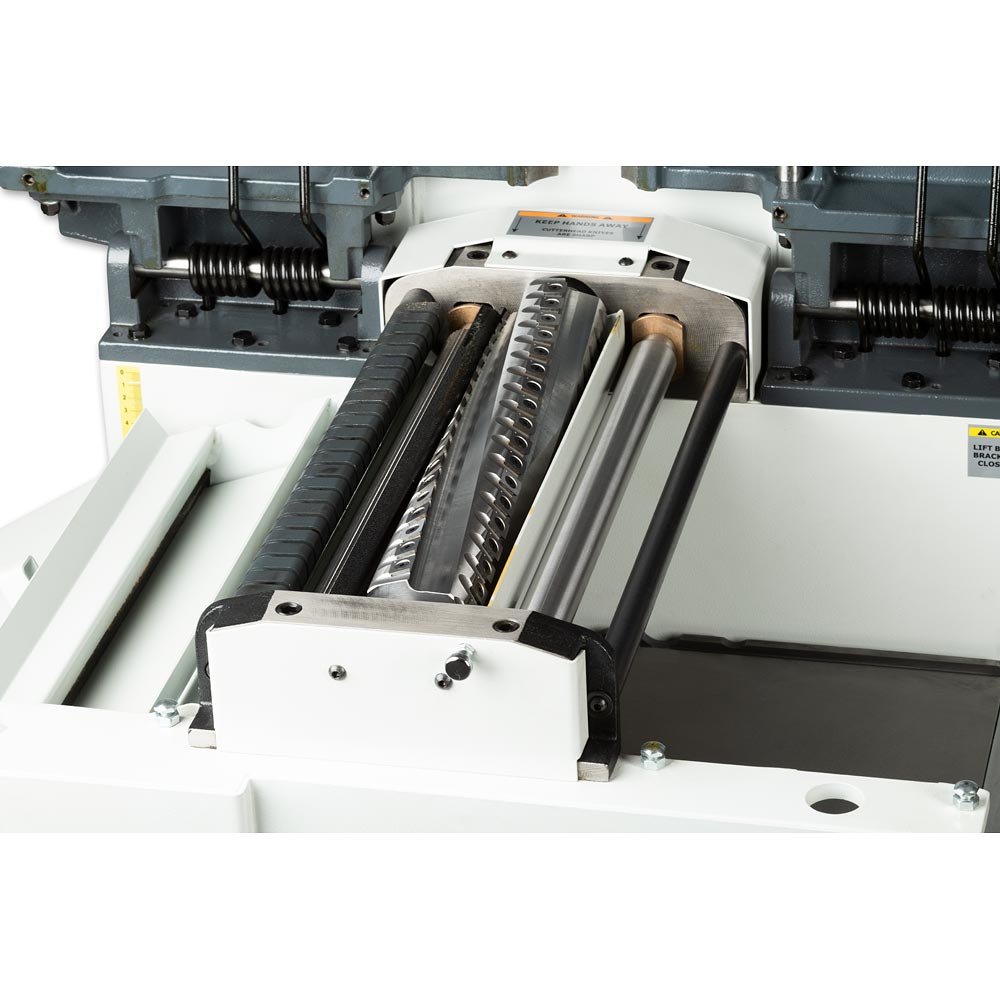

  • Spiral block produces an ultra smooth finish
  • Finely ground cast iron tables for precision and durability
  • Heavy-duty aluminium fence for accurate guidance
  • Solid construction ensures long term stability

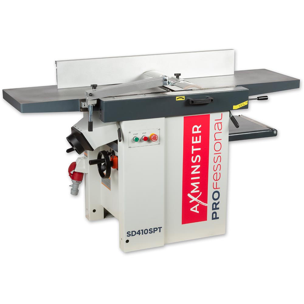

  • Large maximum planing width of 410mm

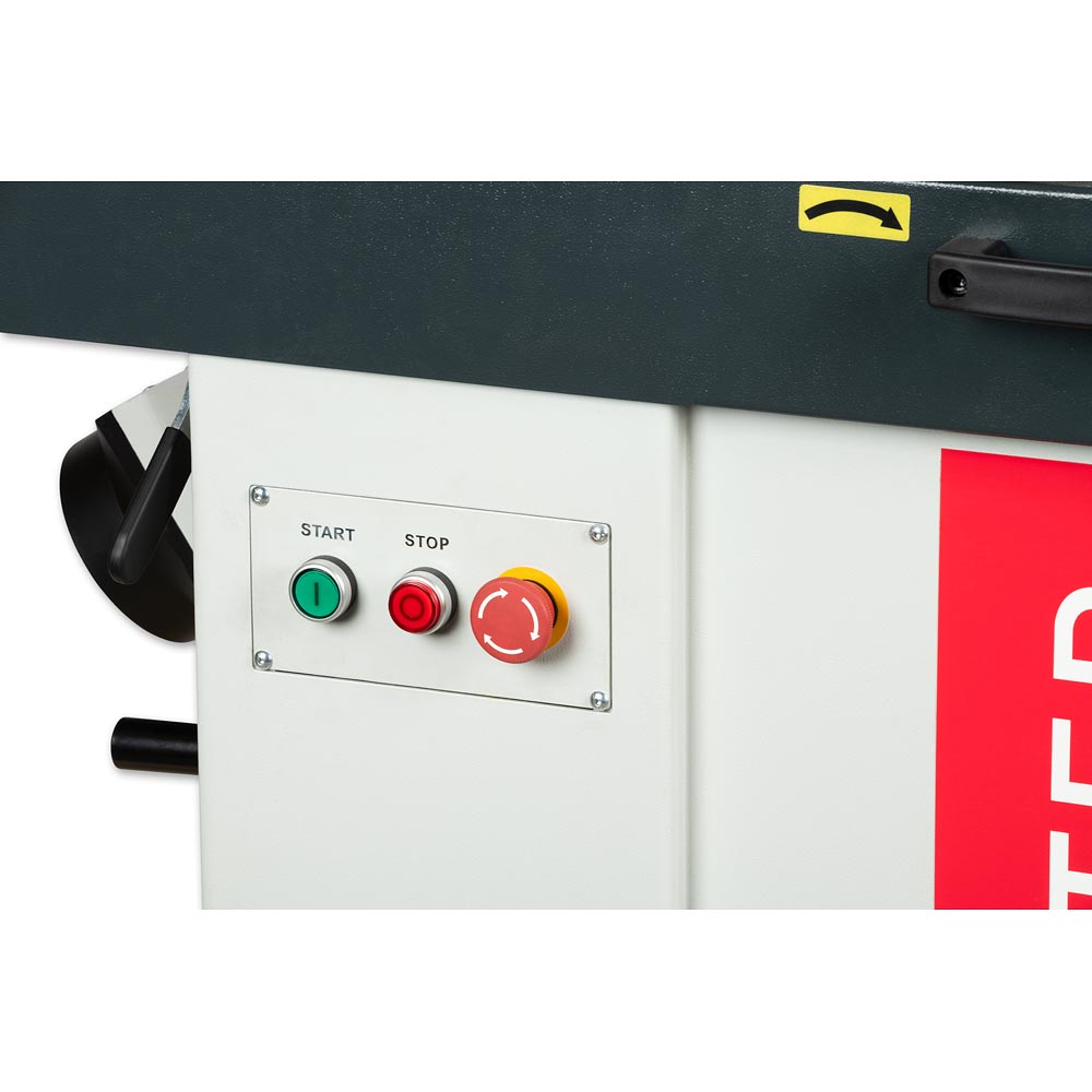

The Axminster Professional SD410SPT Planer Thicknesser is designed to produce exceptional results, day in, day out and is ideal for those who are doing joinery or cabinetry work. Its spiral cutting block uses 44 knives, producing an ultra smooth finish and offering a far longer service life than traditional HSS blades. With this design, planing ripple is virtually eliminated. When an edge eventually dulls, simply rotate the cutter 90° with the supplied Torx driver - tighten, and you’re back to work. There’s no resetting, no downtime, and no waiting for sharpened blades to return. Spiral blocks also run quieter and with significantly reduced vibration.

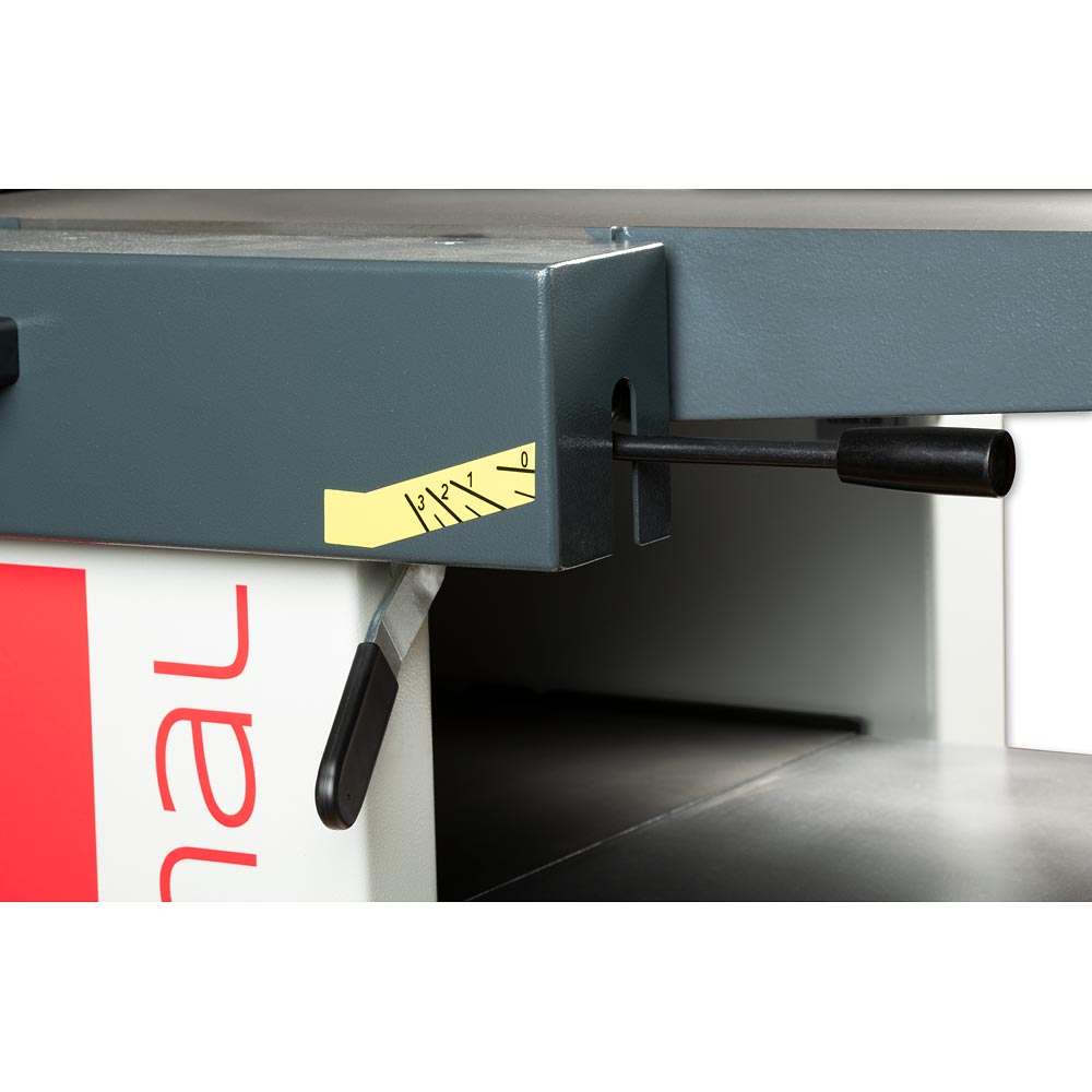

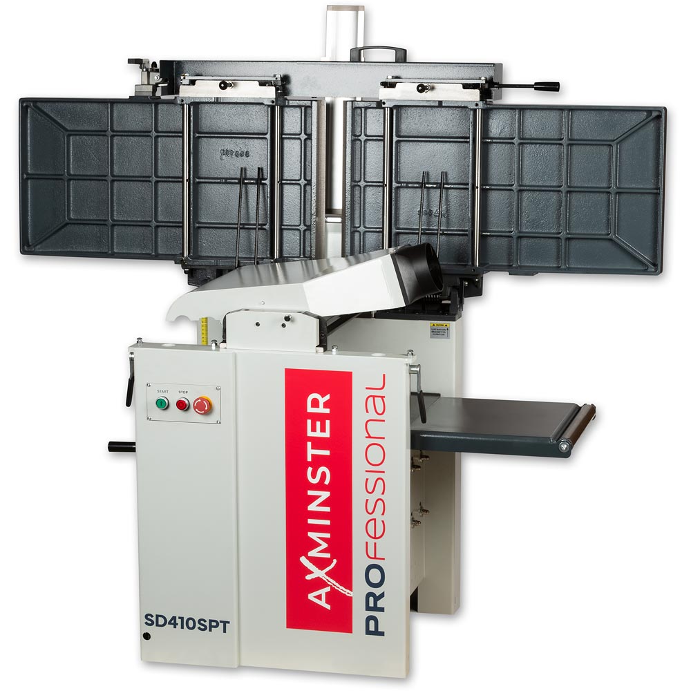

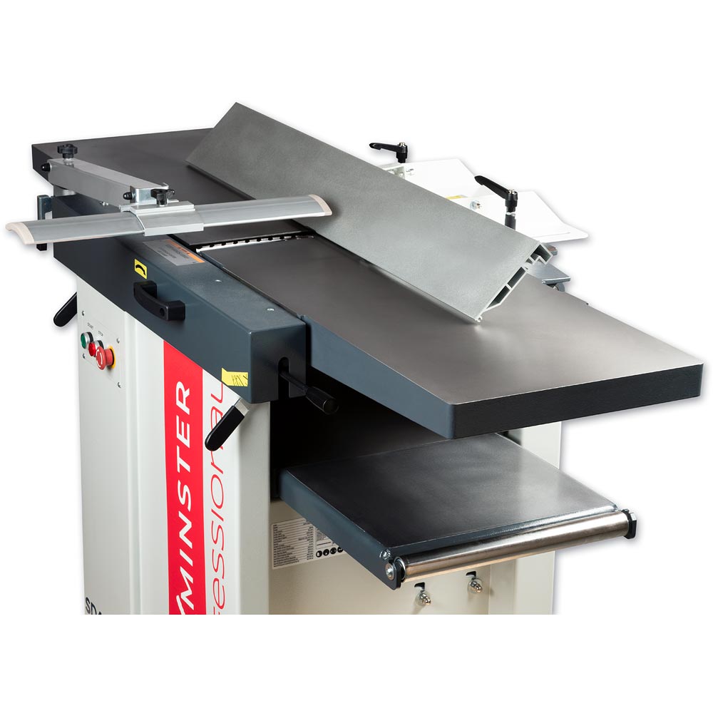

Heavy-duty cast iron and steel construction ensures long-term stability and vibration-free operation, providing a solid foundation for accurate, consistent results. The heavy-duty aluminium fence offers stable, reliable support for precise work, with quick adjustments to 90° and 45°. Switching between jointing and thicknessing is fast and intuitive thanks to the single-lift tables, which rise together in one smooth, effortless motion. Finely ground cast-iron tables ensure accuracy on every pass and the generous 2,080 mm table length also offers excellent support for longer workpieces.

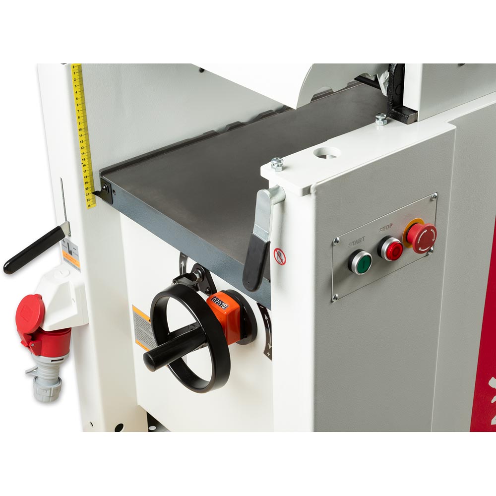

Adjustments are straightforward: the digital height gauge makes adjustments simple, while a viewing window in the feed table allows easy monitoring during operation.
Powered by a robust 4 kW motor, the cutterblock spins at 5,500rpm, feeding material at 7m/min for a consistent, clean and smooth finish. The SD410SPT Planer Thicknesser handles a wide range of tasks with its 410 mm planing width and 225 mm thicknessing height capacity. The maximum depth of cut when planing is 4 mm, whilst the maximum depth of cut for thicknessing is 3 mm.
