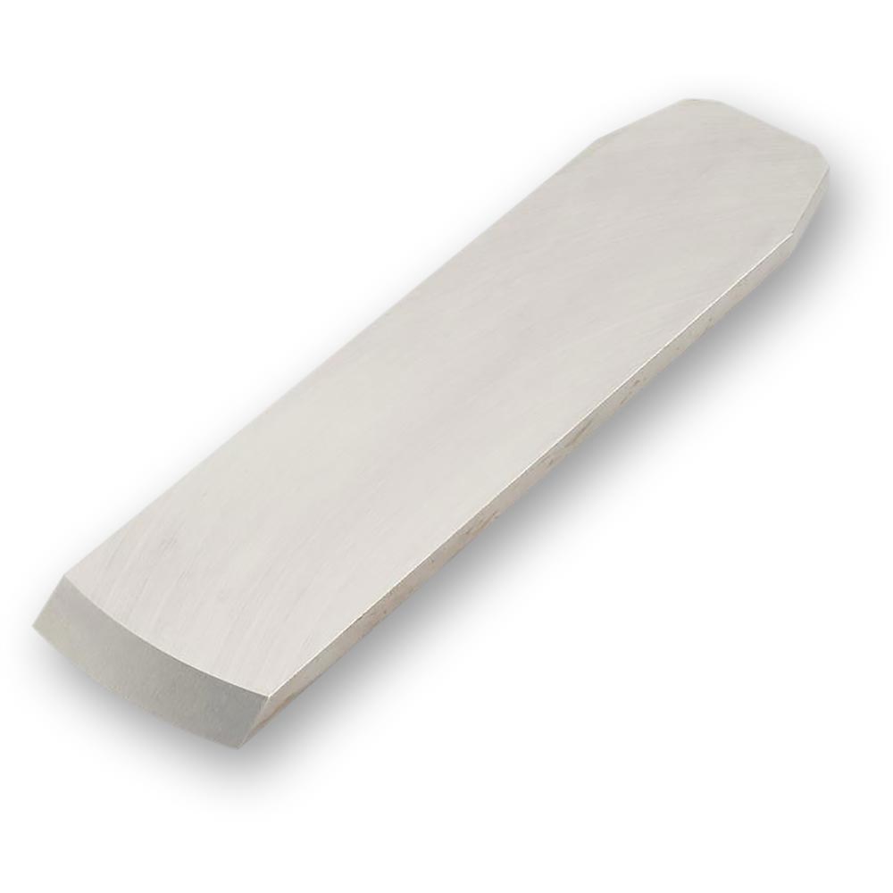

  • 38mm(1.1/2") wide by 4.7mm(3/16") thick
  • Edge is ground with a 75mm(3") radius for an aggressive cut
  • PM-V11 steel blade lapped to a flatness tolerance of +/-0.0127mm
  • Made in Canada
This PM-V11 blade is 38mm(1.1/2) wide by 4.7mm(3/16) thick, the edge is ground with a 75mm(3) radius to take an aggressive cut.
The PM refers to a process known as powder metallurgy. It involves atomising molten metals, cooling and hardening the powder, finally heating it under pressure to form an ingot. PM-V11 is a specific mixture of metals combined into a unique alloy. The resulting steel has a very fine, uniform grain structure. It is inherently more durable than steels produced using ordinary manufacturing processes. Blades made from PM-V11 are highly resistant to dulling or damage from wear and impact. These blades can take a keen edge and hold it through extended use. PM-V11 is as easy to sharpen as A2 tool steel using water stones or other common sharpening methods. Testing showed that a PM-V11 blade edge lasts at least twice as long in use as an A2 blade. Made in Canada.
