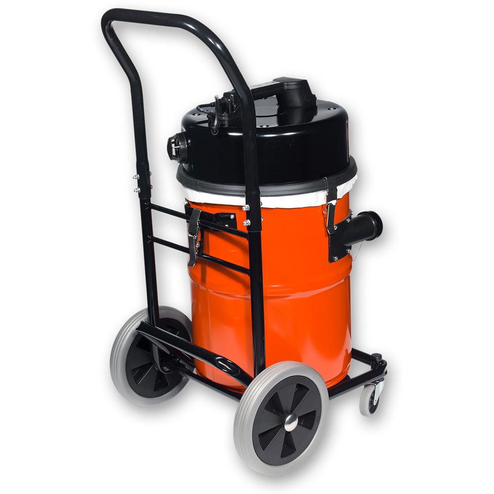

  • 2x 'TwinFlo' vacuum motors, 35 litre steel drum
  • Fitted with primary filter and a secondary filter
  • Filtration down to 0.5 microns @ 99.95%

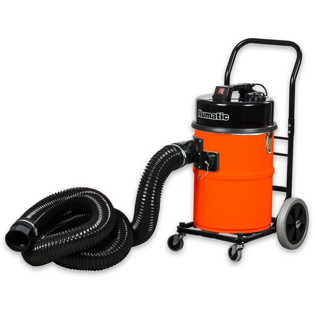

This machine offers an excellent solution for general workshop extraction. The NVD 750 workshop vacuum extractor can be connected to a machine or hand held power tool. The 35 litre drum incorporates a 100mm cyclonic inlet connector for most tasks. A 100-51mm reducer is provided to enable the 2.9 metre x 32mm power tool hose to be fitted.
The two 'TwinFlo' vacuum motors provide power for efficient extraction. A visual flow indicator allows monitoring of the filtration performance. The extractor comes with a red Filtrex primary filter and a secondary 'Permatex' filter. A 'HepaFlo' disposable filter bag should be used when extracting from tools that create dust as opposed to chips. There is an exhaust blower socket to enable the exhaust air to be ducted away from the workshop.
Supplied with a 4m x 100mm hose, a 2.9m x 32mm hose, a step down adaptor and a pack of bags. A mobility chassis provides easy movement around the workshop. This machine is the best solution for those requiring something portable and also to handle a large range of extraction tasks. It is ruggedly made in epoxy painted steel, and is designed and made in England.
