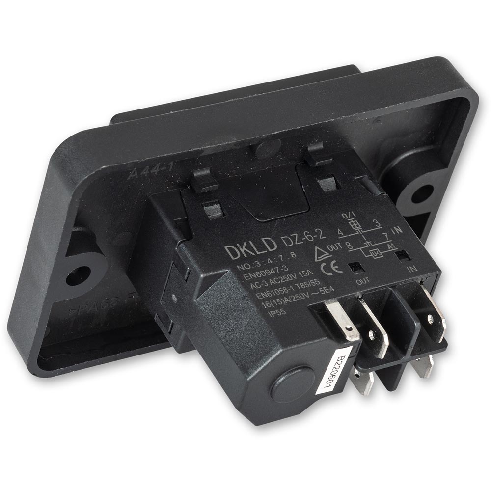

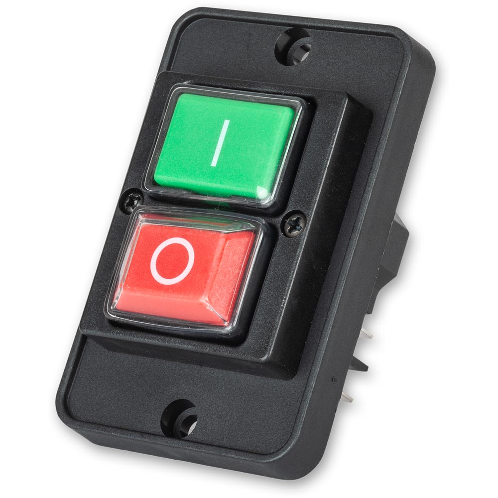

  • Medium sized NVR switch for motors up to 2.2kW (3hp)
  • Common replacement switch for many woodworking machines, especially saws
  • Simple to connect with clearly marked terminals, 5th terminal for interlocked doors
  • Dust cover and positive action push buttons
  • Rated at 15A max load
The DZ-6-2 230V switch is commonly used on small woodworking machines, especially saw benches with an interlocked door. Rated at 15A, it will be suitable for induction motors up to 2.2kW (3hp), 230V 1ph. Simply connect using insulated spade terminals, the connections being clearly marked for input and output. A separate link is provided for an interlocked door etc. It is a no-volt-release type of switch, providing safety in the event of an interruption of power. Requires a rectangular hole approximately 25 x 50mm, with holes for two screws to hold the switch securely. Available with five terminals only.
