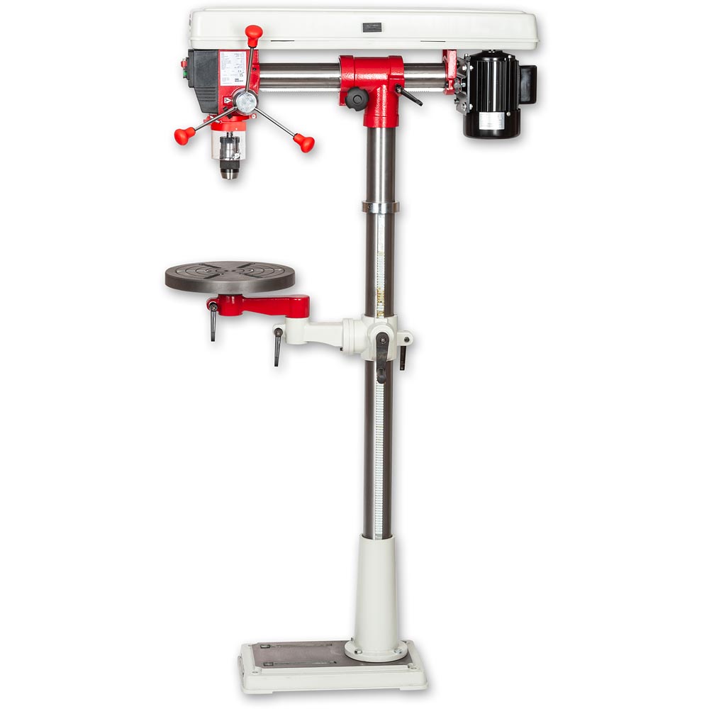

  • Tilting head with up to 420mm drilling width
  • Smooth running 550W induction motor, 5 belt speeds 460-2,480 rpm
  • Quality 1-16mm keyless chuck; convenient rack and pinion adjustments
This floor standing radial drilling machine is good value for a workshop needing to drill wide workpieces. In addition, the tilting head allows drilling beyond the vertical.

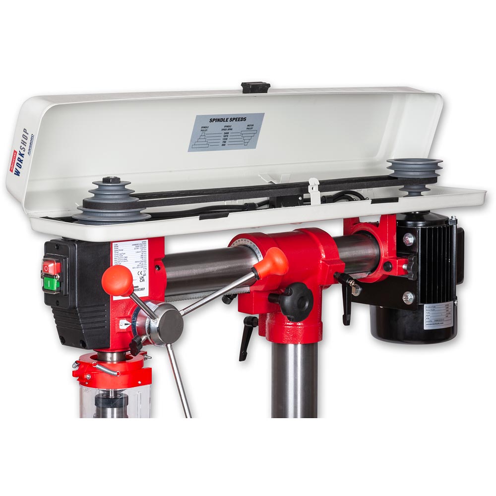

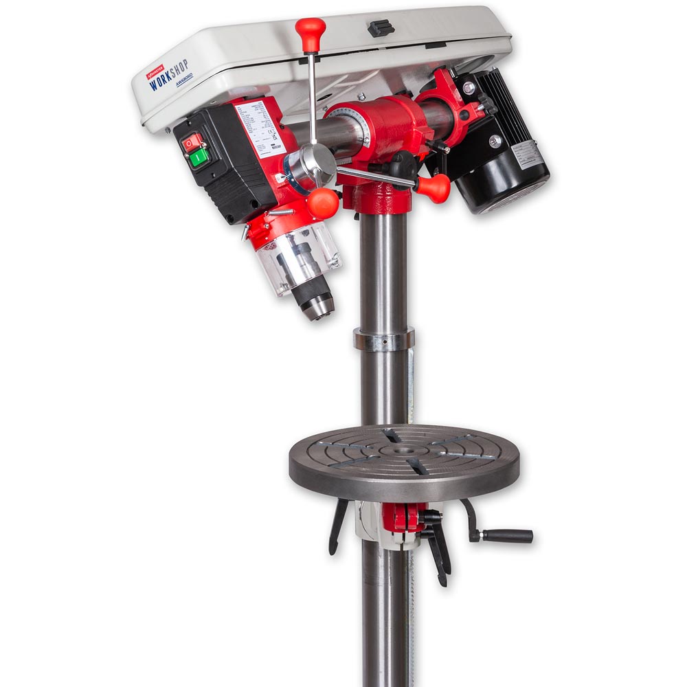

The drilling width is variable, between 220mm and 420mm. The horizontal movement of the head is controlled by a rack and pinion system. Tilting the head is achieved by undoing a locking knob, setting the required angle against a scale and re-locking the knob. There is a positive locating pin to ensure that the head returns exactly to the vertical.
The AW680RD has a 550W induction motor and a choice of 5 pulleys give a speed range of (5) 460-2,480rpm. It comes with a quality 1-16mm keyless chuck. There is a two part table assembly for greater versatility
