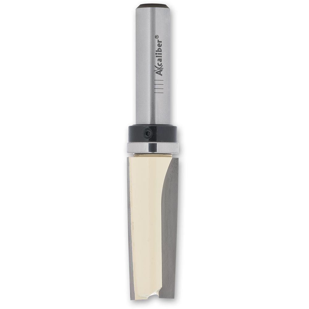

  • For flush trimming or following a template
  • Cutting edges, angles give a downward shearing action

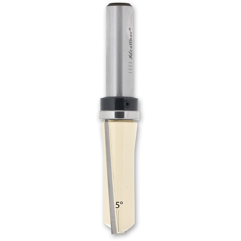

  • Produces a very clean cut with minimum breakout
  • Fitted with top bearing
  • Precision made on multi axis CNC machines
  • High shear-cut angle for cleaner finish
  • PTFE coating helps cutter to remain free of resin
An excellent choice for flush trimming or following a template, this cutter has the cutting edges placed at an angle to give a downward shearing action. This results in a very clean cut with minimum breakout. Top bearing cutter with 1/2(12.7mm) shank, 19mm diameter and 50mm depth of cut.
Axcaliber router cutters are high precision tooling, made using advanced technology on multi axis CNC machines. A high shear-cut angle gives them a smooth cutting action and results in a clean finish. The tips are diamond-ground micrograin tungsten carbide. PTFE coating minimises resin build-up.

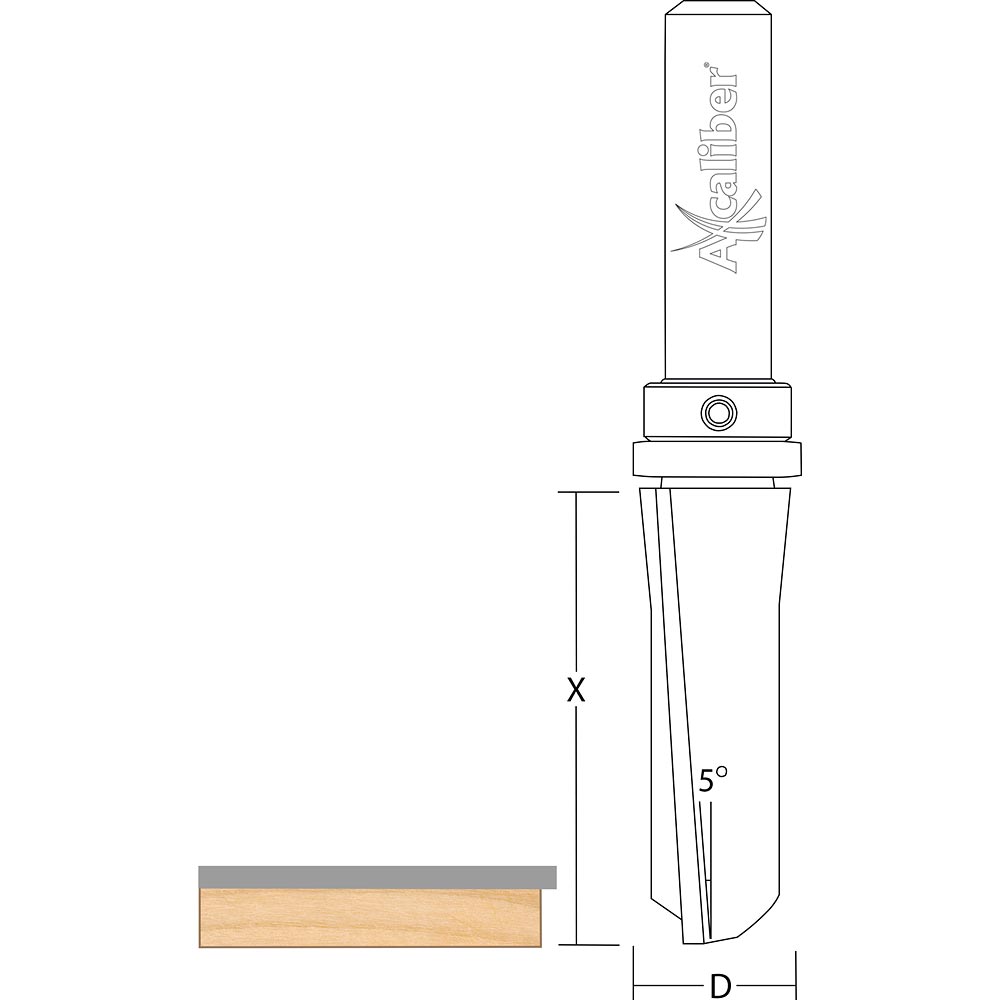

Shank Diameter 1/2" (12.7 mm)
X = Depth of Cut 50 mm
D = Overall Diameter 19 mm
Web Attribute Set Trimming Router Cutters D: 19 X: 50
