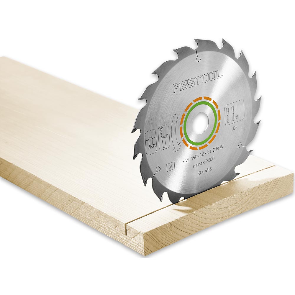

  • Wood and soft plastic cutting blade 160mm x 20mm bore
  • Tungsten carbide tips with alternate bevel grind
  • Kerf of only 1.8mm, gives a rapid, clean cut
  • Minimal amount of power required for a given cut
  • 18-tooth a good general purpose blade for wood or plastics.
These Festool 160mm diameter (20mm bore) blades are compatible with the TS55F, HK55 and HKC 55 models as well as other saws taking this size of blade. The tungsten carbide tips have an alternate bevel grind coupled with a kerf of only 1.8mm, giving a rapid, clean cut. These features minimise the amount of power required for a given cutting operation. This 18-tooth blade makes a good general purpose blade for wood or plastics.
Blade Diameter 160 mm
Maximum RPM 9,500 rpm
Manufacturer Part Number 500458
Kerf 1.8 mm
Teeth 18
Tooth Format ATB
Plate Thickness 1.2 mm
Hook Angle 25
Bore Size 20 mm
Web Attribute Set Circular Saw Blades - Power Tool
EAN Barcode 4014549223598
