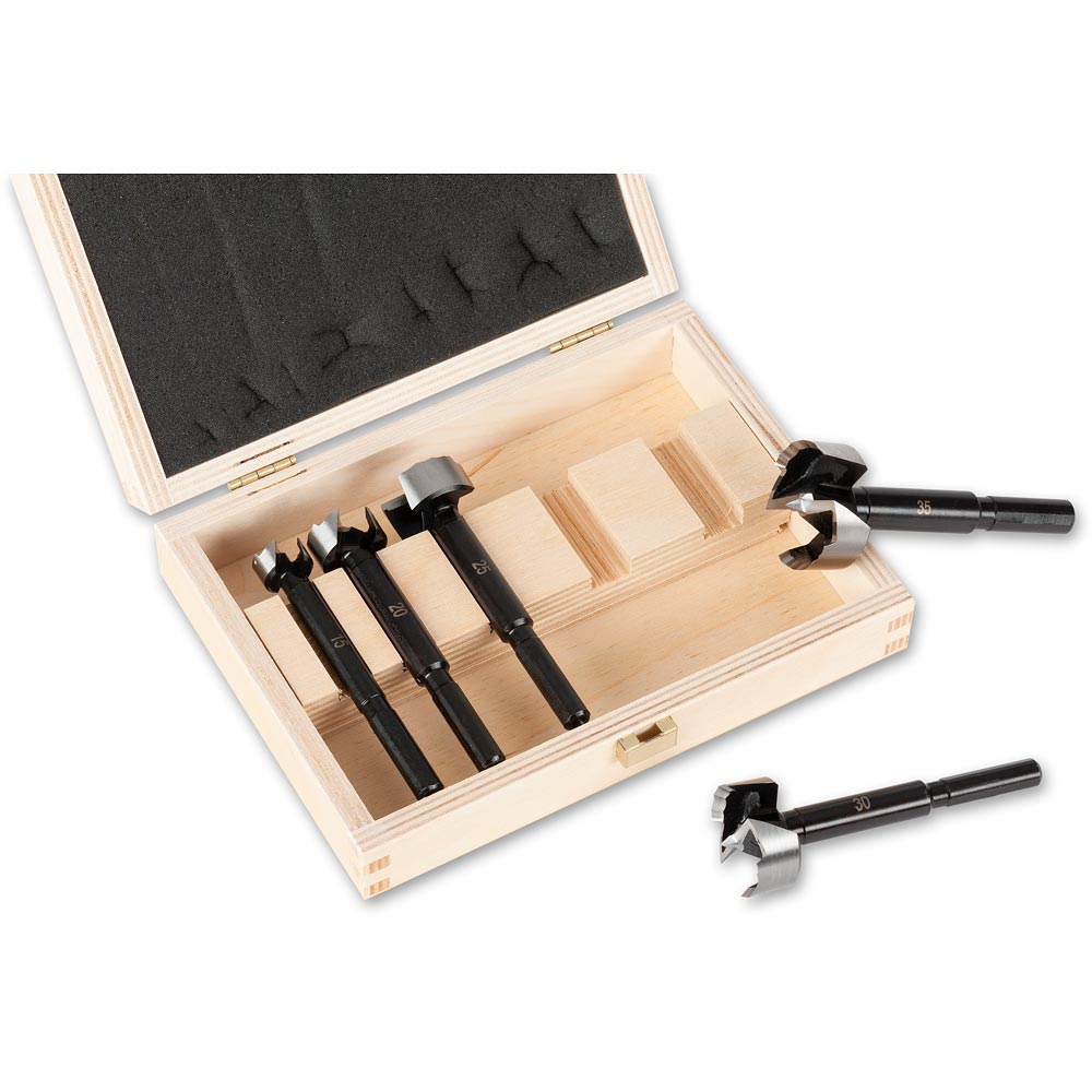

  • Made in Austria
  • Set includes: 15, 20, 25, 30 and 35mm
  • Features Serrated ‘Wave’ cutting edge for clean cutting
  • Extremely precise for both softwood and hardwood
  • Drill partial holes on an edge or at an angle
  • Forged from one steel billet for extraordinary strength

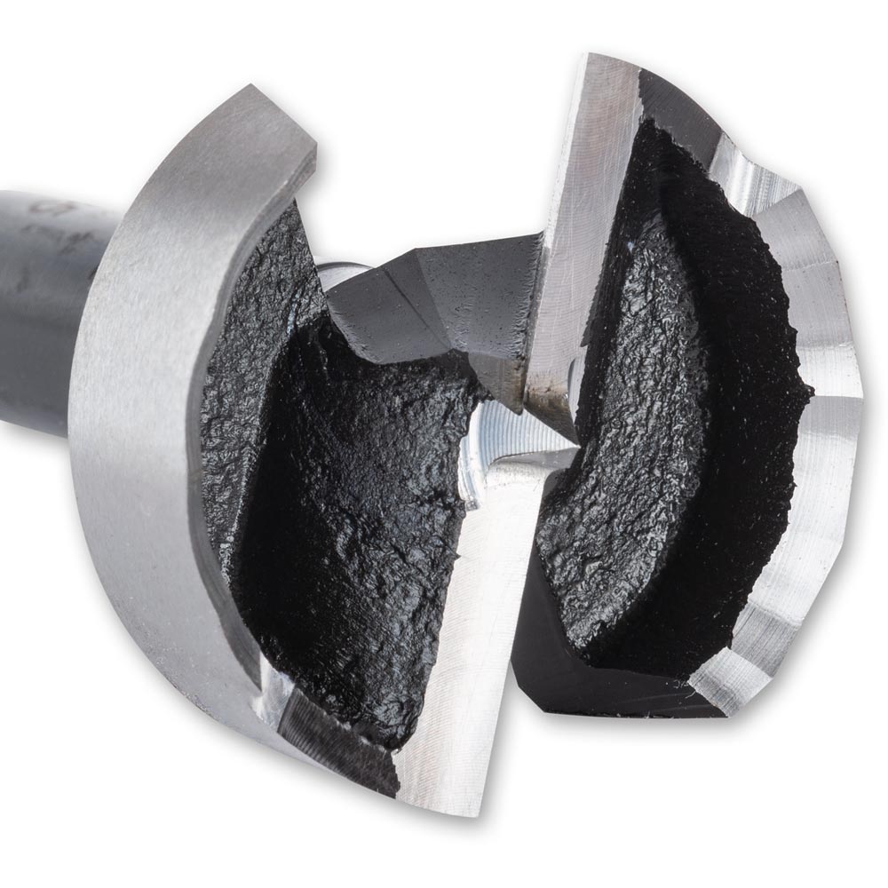

One of the standout features of the UJK Wave Forstner Cutter is its serrated 'Wave' edge. This design generates less heat, allowing for faster cutting speeds and requiring less effort to achieve each hole. The result is extremely clean entry holes and precision drilling, even at angles.
The shank features three flats for a secure fit in a 3-jaw chuck, ensuring a positive grip and longevity. The large chip-free zones ensure perfect chip removal, while the wavy peripheral cutting edge prevents annealing of the cutting edges.

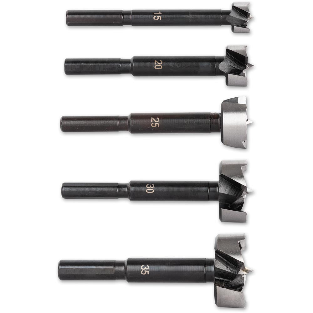

5 piece set consists of 15, 20, 25, 30 and 35mm.
Diameter size 15-30 mm: Shank 8mm. Diameter size from 35 mm: Shank 10 mm.
