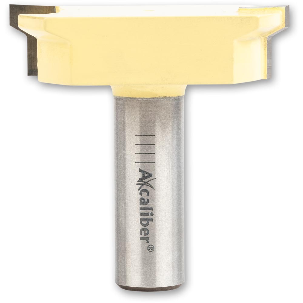

Axcaliber drawer-lock bits produce strong, perfectly fitting joints quickly and easily. This one bit produces both the sides of the joint without any further adjustment. The joint resists pulling forces when opening the drawer and has a large surface contact for glue. Where the aesthetics of a dovetail joint aren’t required, the drawer lock joint is nearly as strong, easier to set up and quicker to produce. The Axcaliber drawer-lock bits are suitable for material thicknesses from 12mm to 20mm.

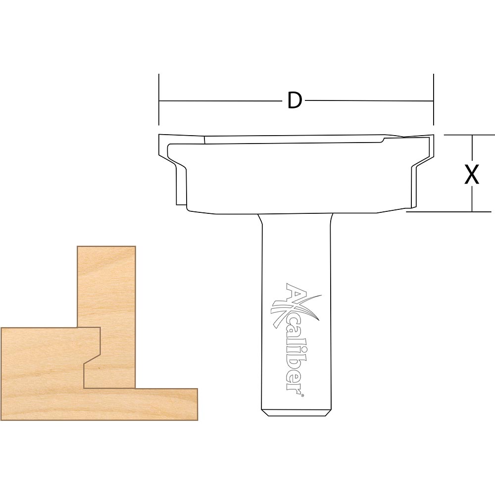

Shank Diameter 1/2" (12.7 mm)
X = Depth of Cut 13 mm
D = Overall Diameter 50 mm
