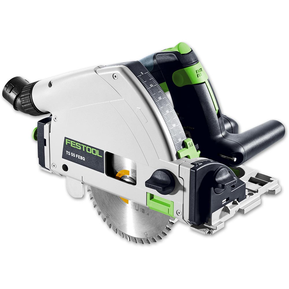

  • Accurate plunge cutting saw for splinter free cuts
  • 1.8mm thin kerf blade for fast cutting
  • Fully compatible with Festool FS guide rail system
Festool’s TS 55 saws have a reputation for absolute precision cuts, maximum power and extreme durability. This latest incarnation is no exception. The TS 55-FEBQ takes a 1.8mm kerf blade. The narrow kerf means it removes much less material, allowing the TS 55-FEBQ to cut at up to twice the speed of previous models. The new generation of cutting blades guarantees perfect cutting quality with maximum cutting performance.
A detachable splinter guard in front of the blade, gives a virtually splinter-free finish on both sides of the workpiece. Behind the blade a guide wedge acts as a riving knife and aids positioning the saw in an existing cut. The angle adjustment from -1 to 47 allows a slight undercut for perfect butt joints. In addition, the cut line remains the same no matter what the cutting angle. With the TS 55-FEBQ maximum cutting performance meets perfect cutting quality.
Optional guide rails, a wide variety of thin 1.8mm kerf saw blades and connection to an extraction system, form a first-class sawing system.
Supplied with 42 tooth thin kerf blade and Systainer SYS3 M 337 carry case.
Bevel Angle Range -1 to +47
Dust Extraction 27 mm / 36 mm Outlet
Max Depth of Cut @ 45º 43 mm
Max Depth of Cut @ 90º 55 mm
Rating Trade/Professional
Spindle Lock Standard Feature
Blade Diameter 160 mm
Sound Power Level LwA [Uncertainty K] 101 dB(A) [3.0 dB]
Corded or Cordless Corded
Sound Pressure Level LpA [Uncertainty K] 90 dB(A) [3.0 dB]
Vibration Cutting Wood [Uncertainty K] <2.5 m/s² [1.5 m/s²]
Motor Power 1,200 W
Saw Blade Speed 2,000 - 5,800 rpm
Manufacturer Part Number 230V - 576706, 110V - 576707
