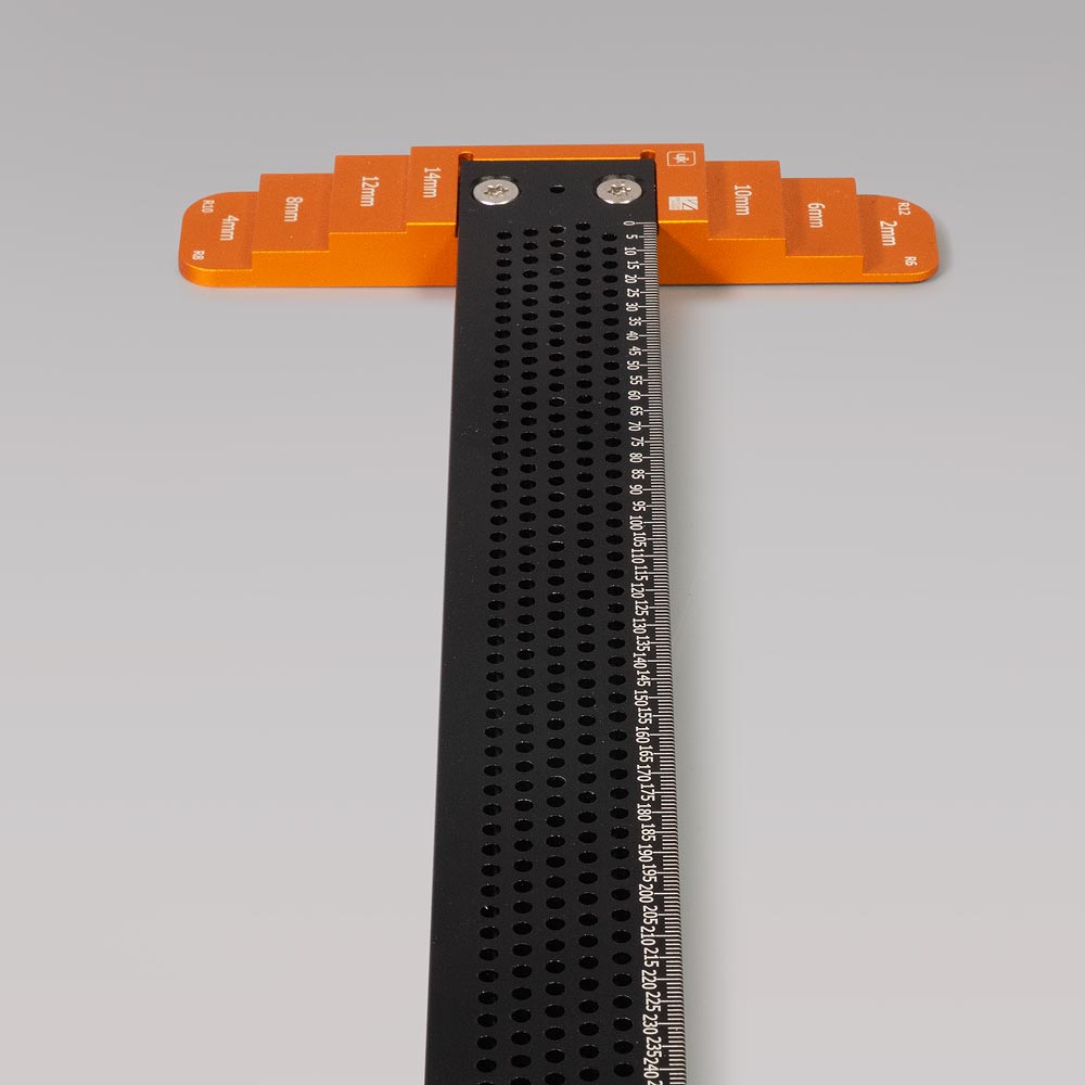

  • Precision T-square for accurate measuring and marking
  • Designed for squaring, radius marking and depth setting
  • Converts into a measuring compass for circles and diameters
  • Anodised aluminium for durability and accuracy
  • Metric drilled holes for consistent, repeatable layouts
  • Accepts 3mm pencils including UJK
  • Made in Britain

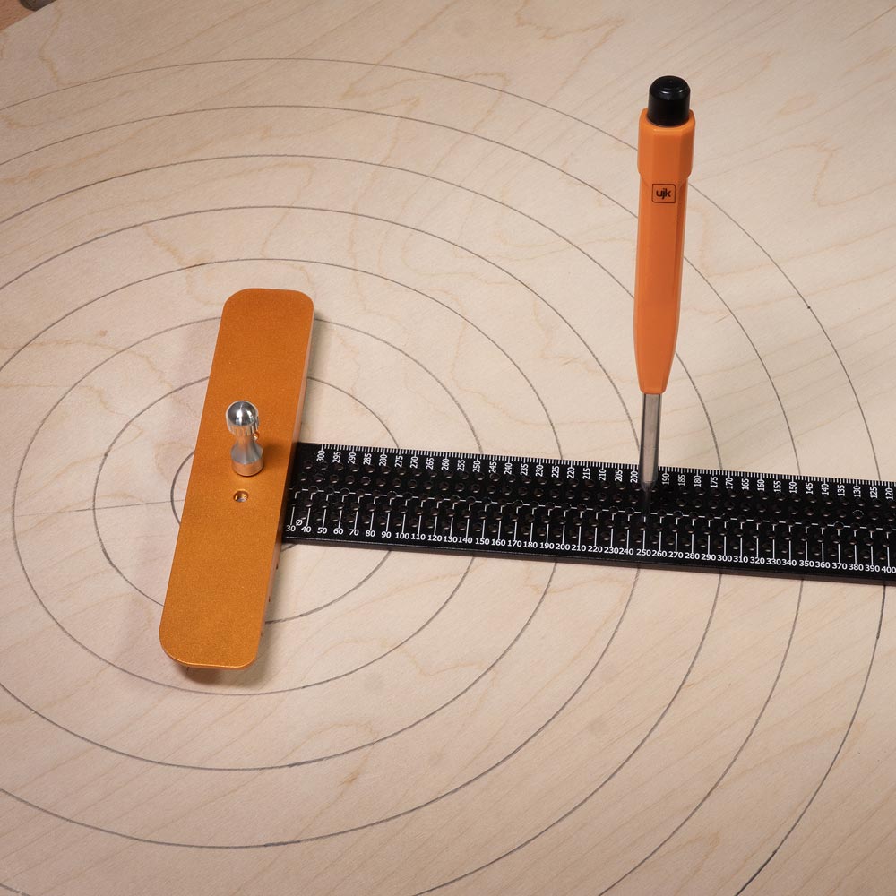

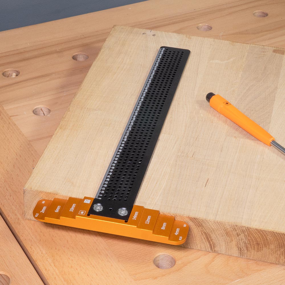

The UJK T-Square is designed to do far more than a standard square, offering a highly accurate and versatile solution for measuring, marking, squaring and layout work in the workshop. British made and manufactured from anodised aluminium, it combines durability with long-term precision, making it suitable for regular, demanding use.

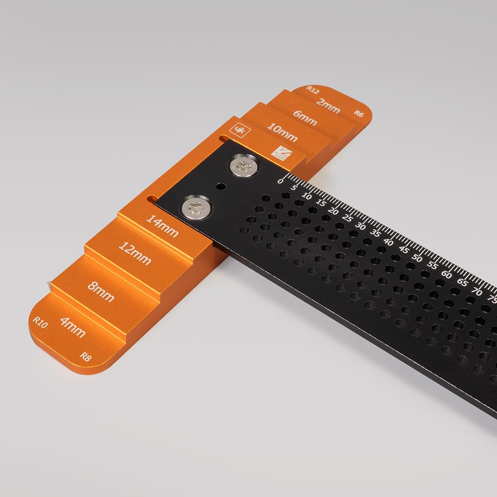

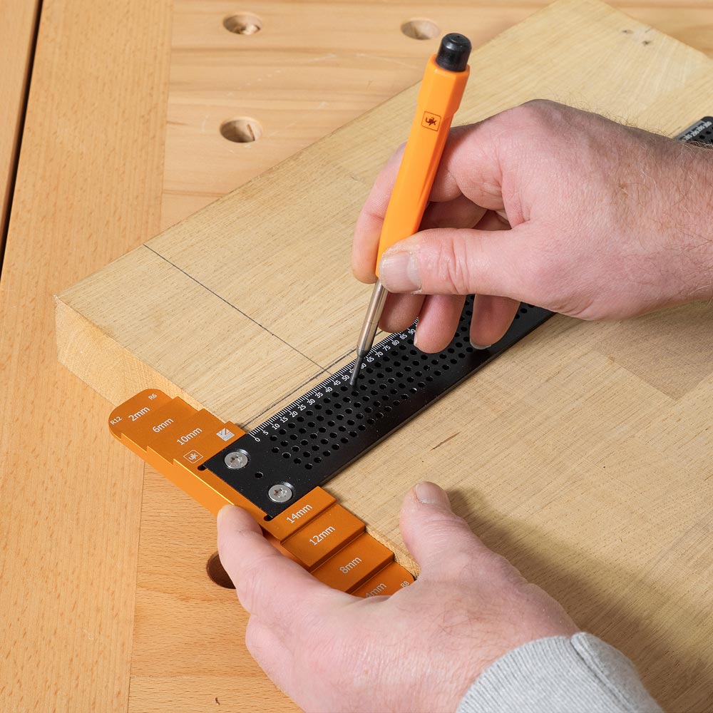

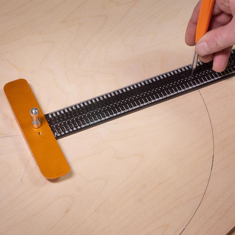

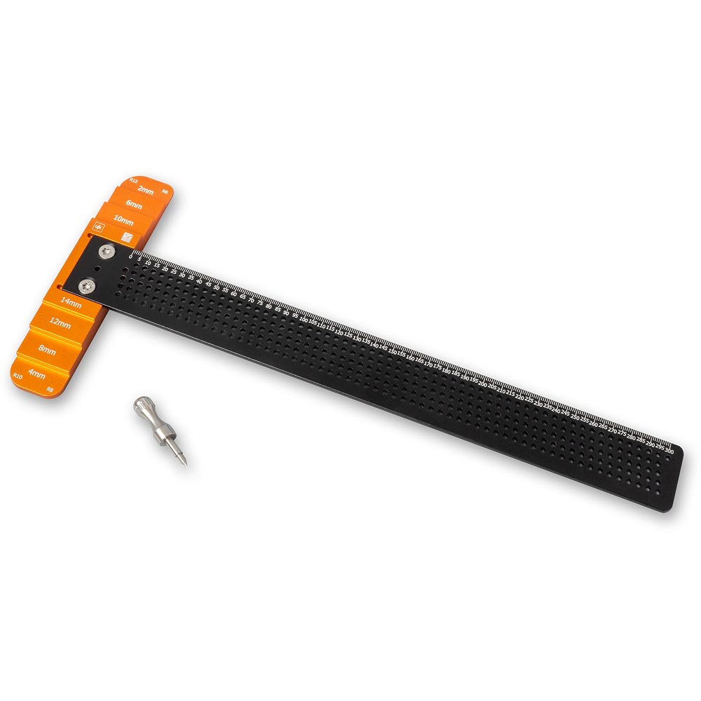

Every detail of the design is focused on accuracy and repeatability. Along the length of the ruler, precision-drilled holes are positioned at every millimetre and centimetre, allowing consistent, repeatable marking without the need for constant measuring. These holes are arranged in incremental rows that increase by 1mm per line, covering measurements up to 300mm, making it particularly effective for batch work and precise layout tasks. The holes are sized to accept UJK pencils or any 3mm diameter pencil, ensuring clean, accurate marking every time.

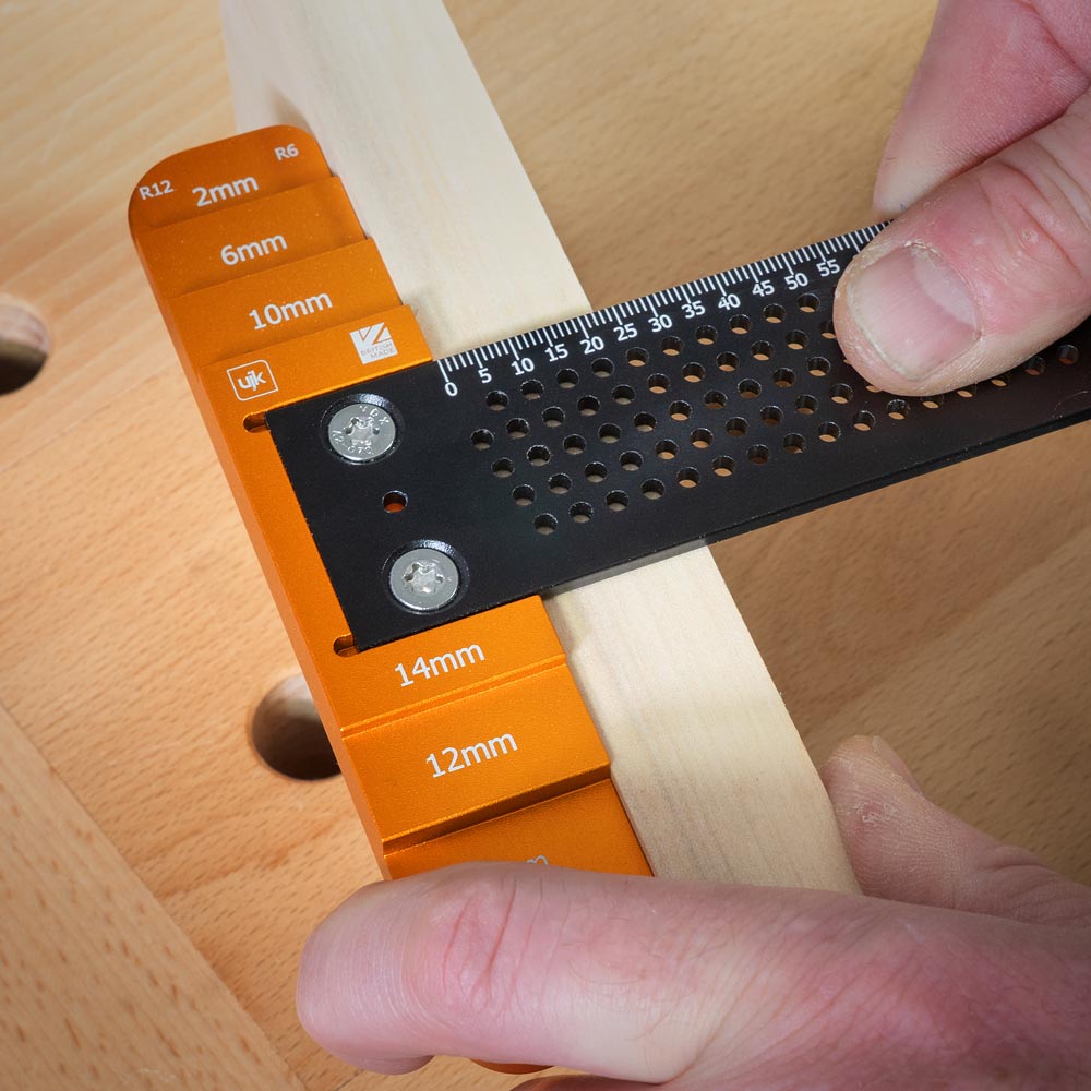

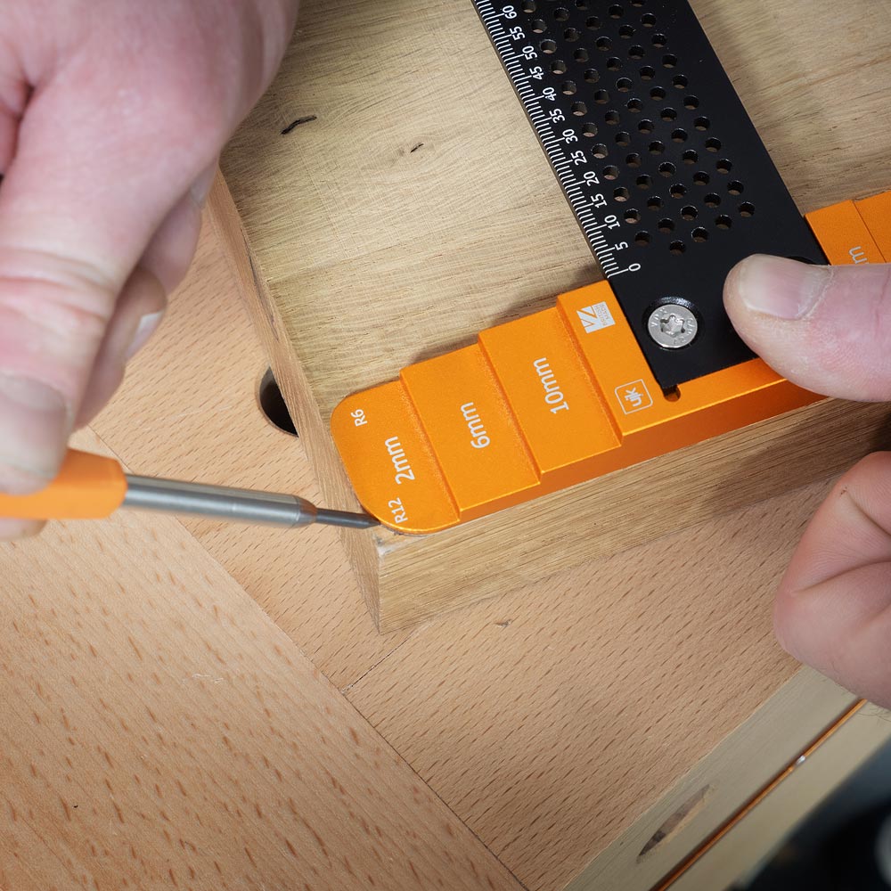

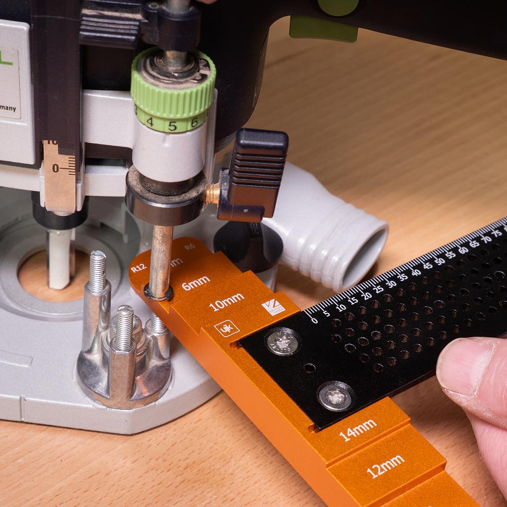

Its functionality extends well beyond straight-line marking. The square is engineered for precise squaring, as well as radius marking and depth setting, with commonly used depth gauges built directly into the design at 2mm, 4mm, 6mm, 8mm, 10mm, 12mm and 14mm. Integrated radius markers at 6R, 8R, 10R and 12R allow you to mark consistent curves quickly and accurately, removing the need for separate tools.

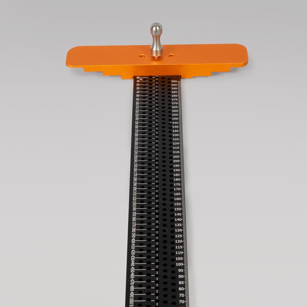

For even greater versatility, the T-Square can be converted into a measuring compass. By simply flipping the tool and inserting the supplied pin, it allows you to mark perfect circles and measure diameters with the same level of precision as its linear functions.
