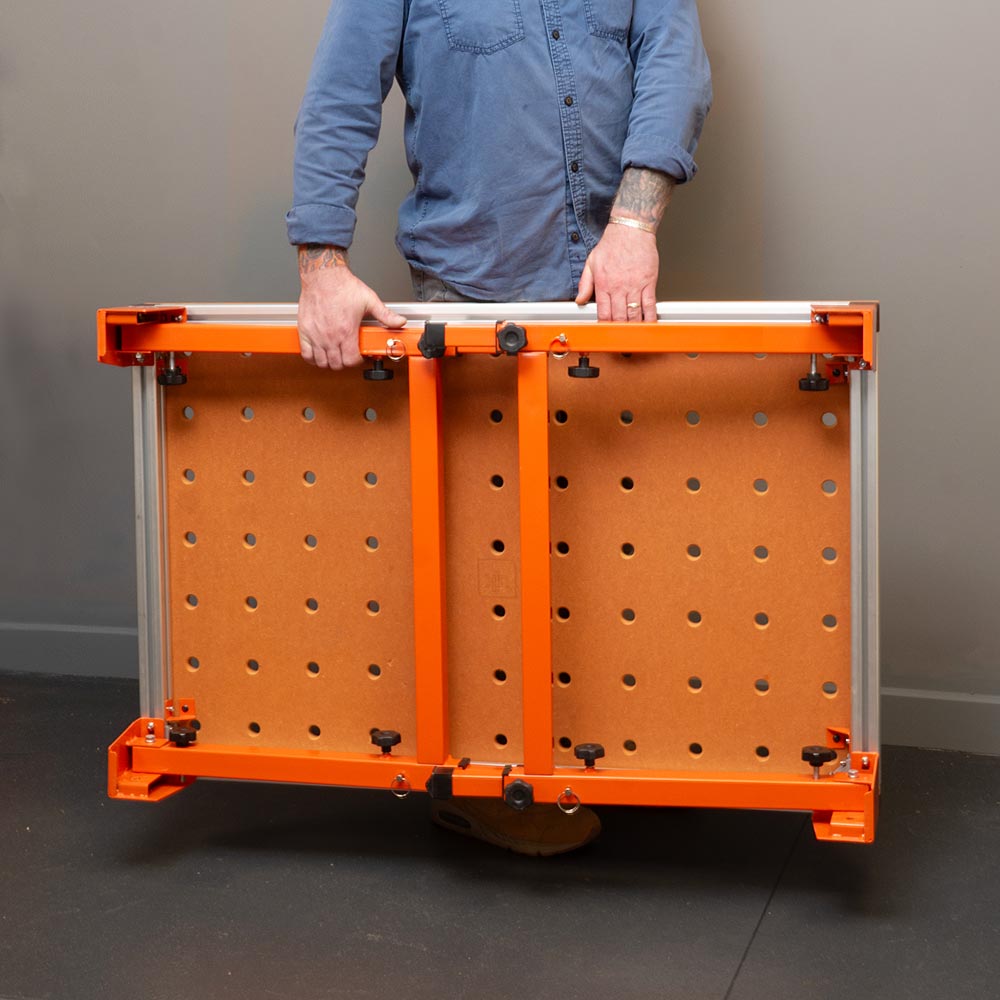

  • Folds flat for easy storage and transport

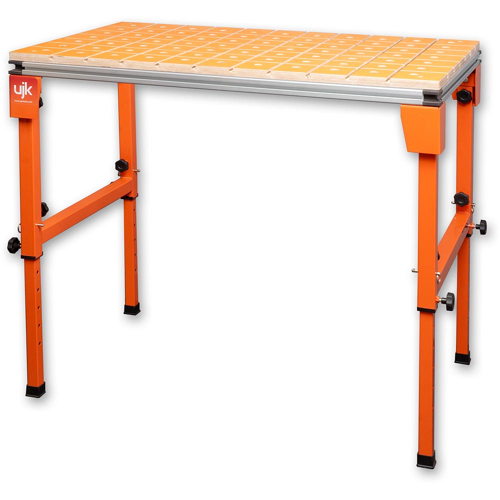

The UJK Multifunction Table Frame is a highly adaptable, height-adjustable workbench base that delivers rock-solid stability, workshop flexibility and seamless compatibility with the UJK system, allowing you to build a work surface that matches exactly how you work.

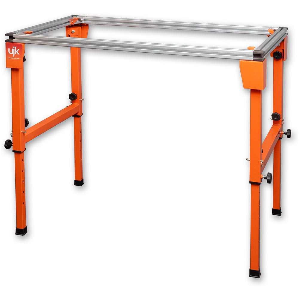

This a precision-engineered metal table frame that forms the foundation of a versatile workbench for cutting, clamping and assembly tasks. The frame is designed to accept UJK multifunction tops or a bespoke surface created using the UJK Parf Mk II Guide System, giving you complete freedom over your final setup. A continuous clamping face around the perimeter allows secure clamping from any angle, while underside fixing for MFT-style tops keeps the working surface clear, flat and fully usable. Height adjustment via a simple pin-and-knob system lets you quickly tailor the bench to the task, improving comfort, control and reducing fatigue. When space is limited or transport is required, the folding leg design allows the frame to collapse flat for compact storage or easy on-site use.
UJK is known for designing intelligent, system-based workshop solutions that prioritise accuracy, strength and adaptability. Built for demanding workshop environments, the UJK Multifunction Table Frame reflects this philosophy with a robust aluminium frame, foldable steel construction and thoughtful compatibility with Parf accessories. Every element is engineered to work together seamlessly, giving you a durable, future-proof platform that evolves with your workflow.
The frame has an overall size of 718mm by 1,102mm and weighs 14.5kg, providing a stable yet manageable base. The working height is adjustable from a minimum of 650mm to a maximum of 950mm. Preset pinned height positions are set at 665mm, 715mm, 765mm, 815mm, 865mm and 915mm for fast, repeatable setup. When folded flat for storage or transport, the frame measures 718mm by 1,102mm by 185mm. Construction consists of an aluminium frame combined with foldable stainless steel legs and non-slip rubber feet, delivering durability, stability and portability.

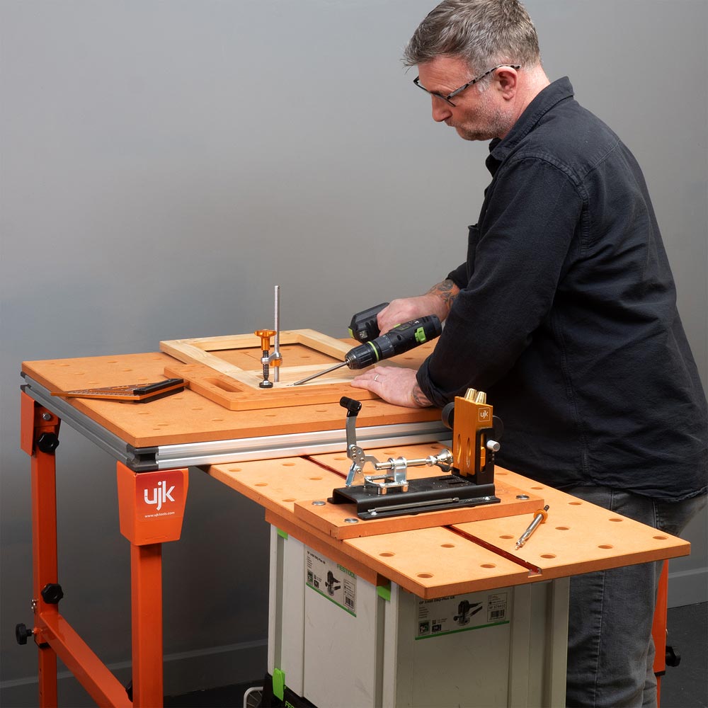

The frame can be paired with UJK multifunction worktops for a ready-made solution, or combined with a custom-made top produced using the UJK Parf Mk II Guide System for absolute precision. It is also fully compatible with T-bolts, T-clamps and the wider range of UJK Parf accessories, allowing you to expand and reconfigure your workbench as your projects demand.
Overall L x W x H 1,102mm x 718 mm x 650 - 950mm
