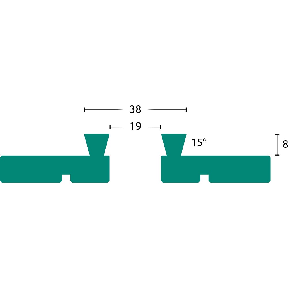

  • Potential gripping range: Internal 11mm to 29mm
  • Potential gripping range: External 31mm to 48mm
  • Recommended for GK100, SK100 and SK114 chucks
  • Drawing dimensions taken when jaws form true circle

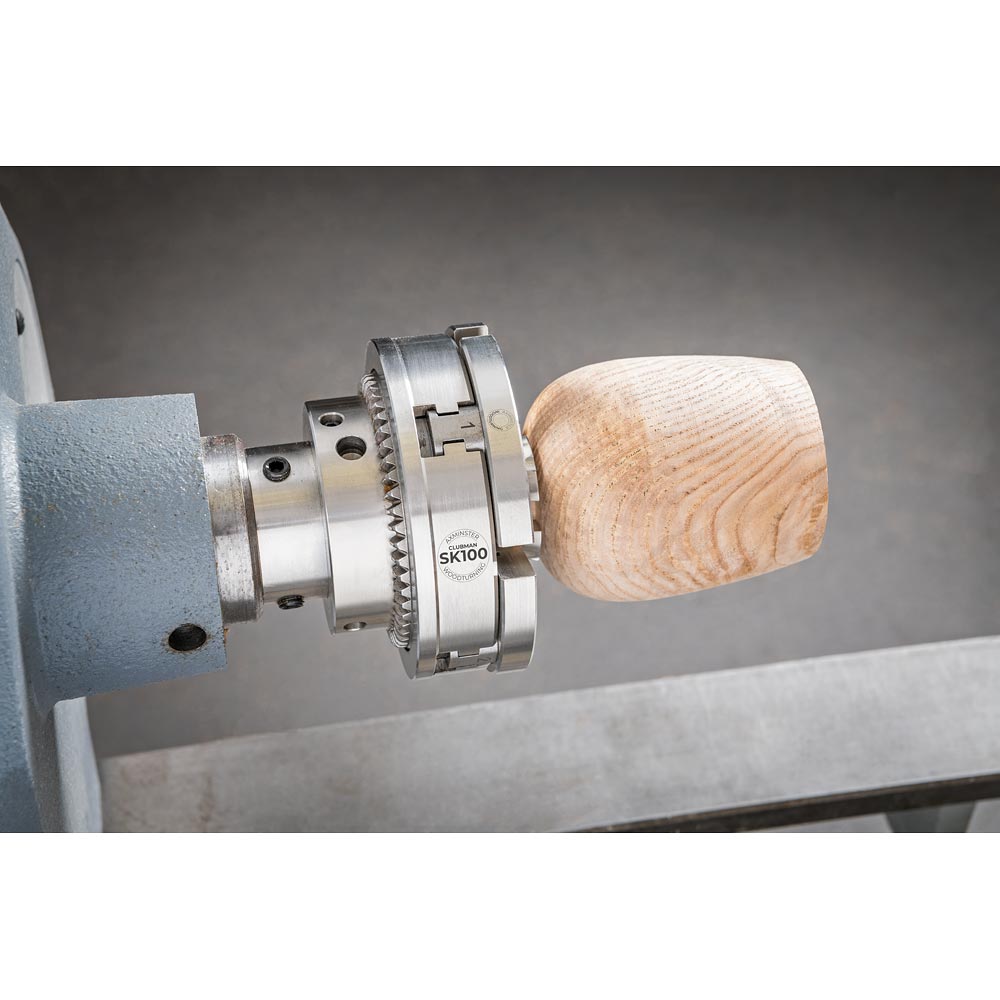

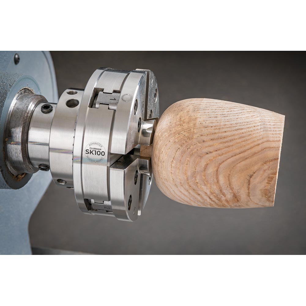

These versatile work-holding jaws for smaller-scale turnery have internal and external dovetails. The SK100 Dovetail Jaw Type F will close down onto a 19mm dovetail spigot or expand into a 38mm dovetailed recess. There is, of course, greater variation due to the chuck’s scroll mechanism. In reality, the internal range is 11mm to 29mm and the external 31mm to 48mm. However, at more extreme diameters the jaws are no longer form a true circle. These jaws are suitable for the GK100, SK100 and SK114 chucks. Made from stainless steel to protect against corrosion. If putting 100mm jaws onto the SK114, the additional 100mm accessory mounting jaws will be needed.
