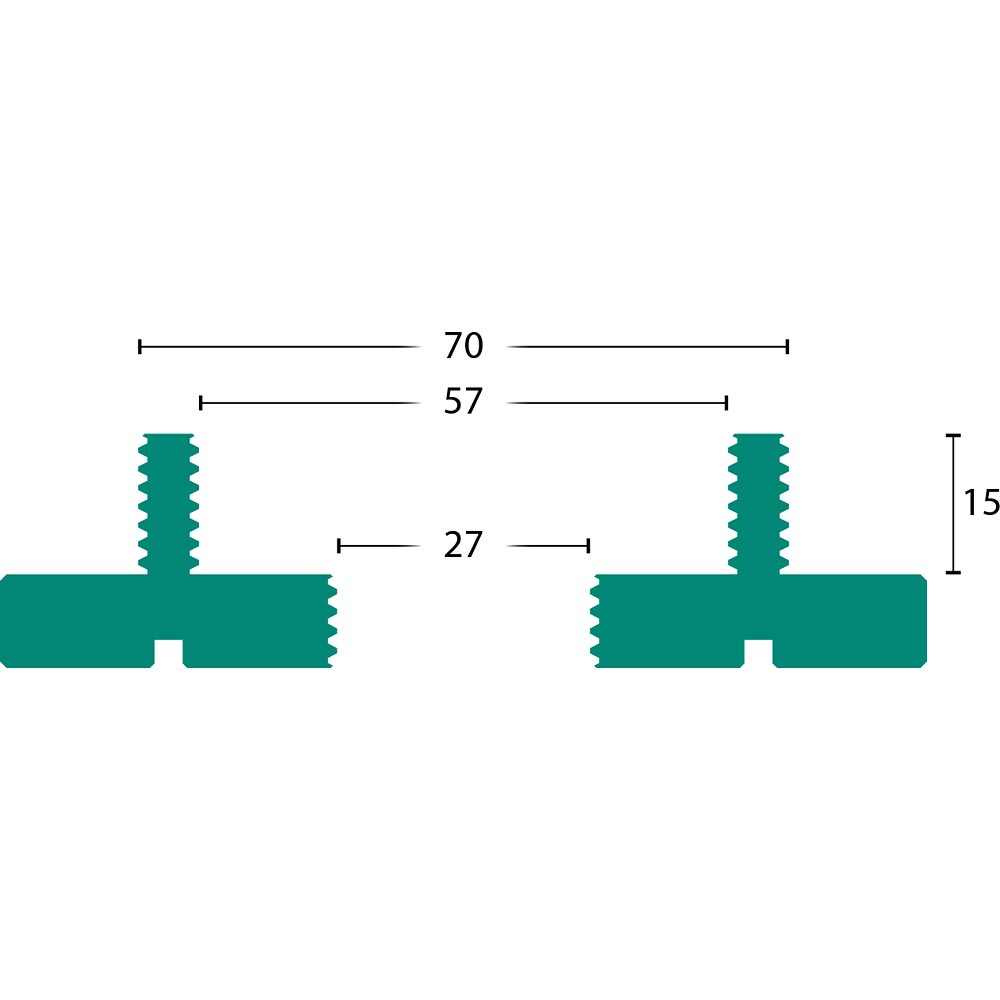

  • Potential gripping range: Internal 51mm to 67mm
  • Potential gripping range: External 64mm to 82mm
  • Drawing dimensions taken when jaws form true circle

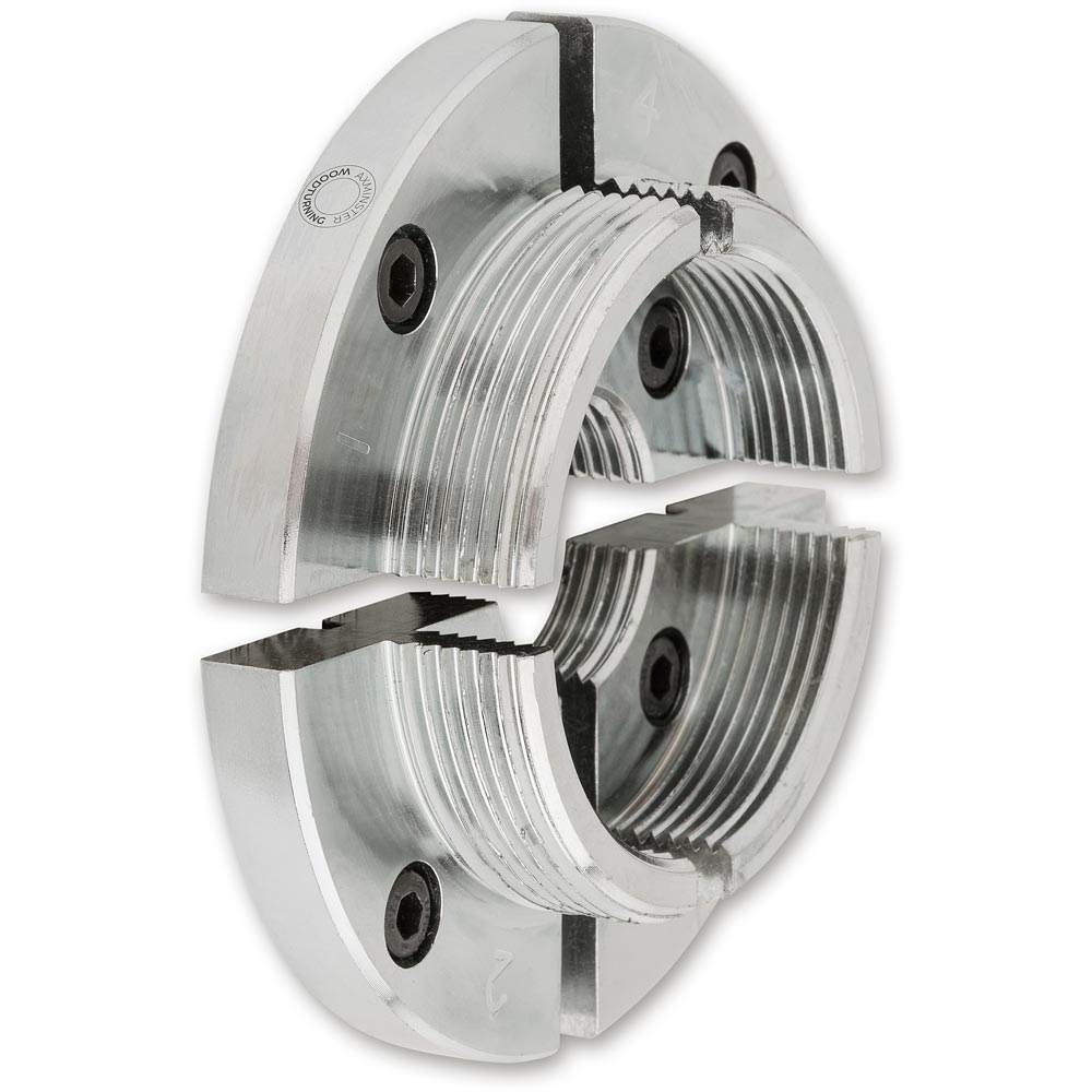

  • Serrated gripping surfaces for extra secure hold
  • Made from stainless steel to protect against corrosion

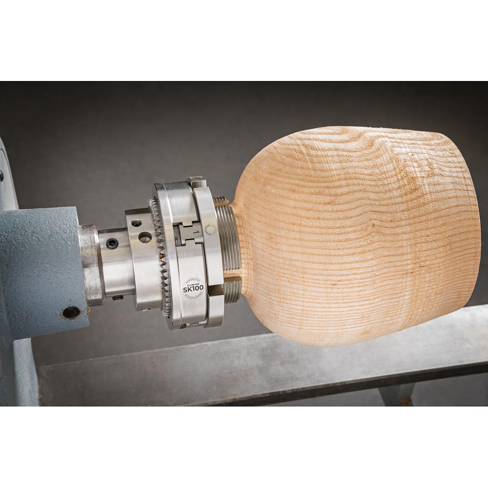

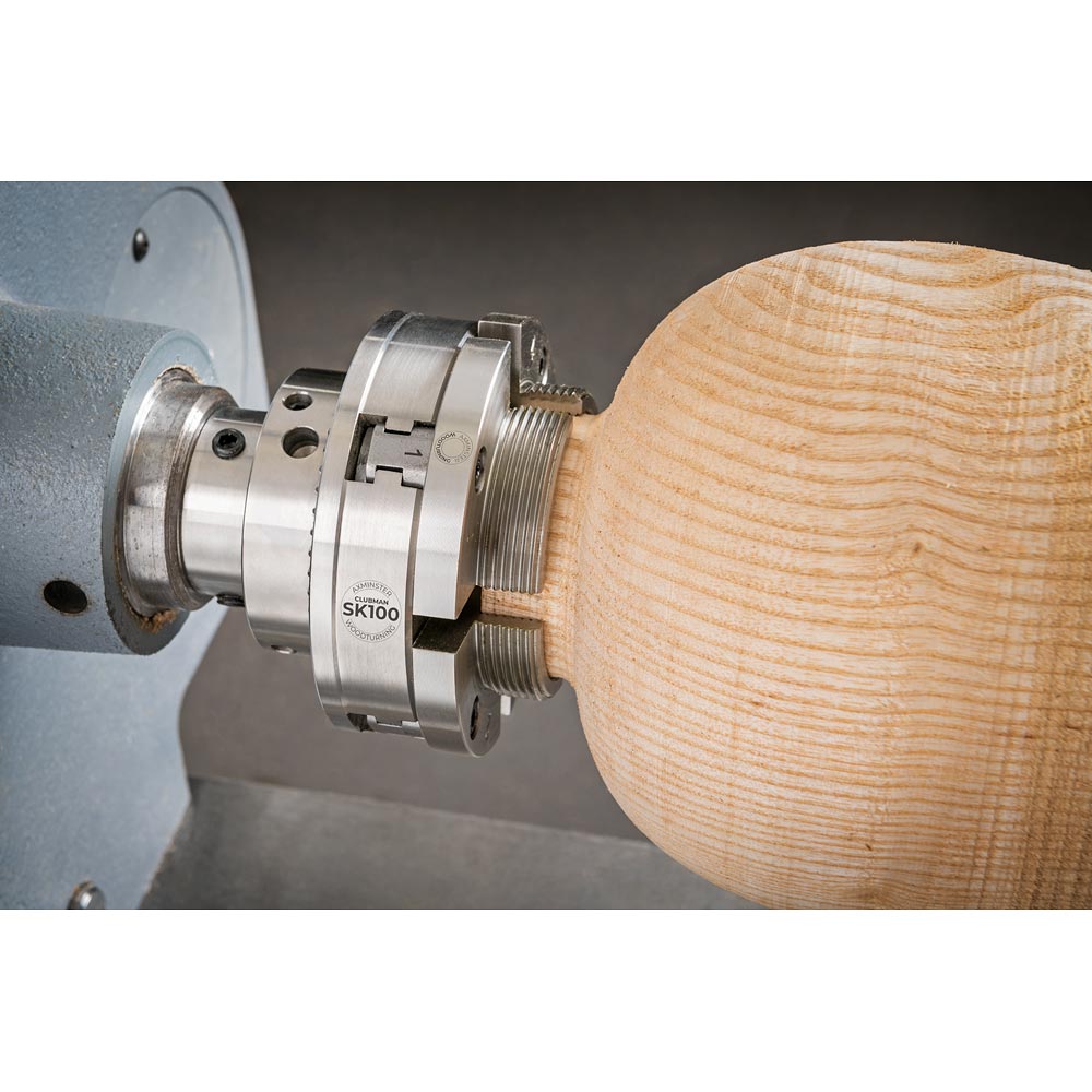

SK100 Type H Gripper Jaws offer a good grip range for medium to large timber blanks. The gripping surfaces have serrations on both the internal and external walls. This design ensures a truly powerful grip on end grain and in green timber. The 15mm jaw depth further adds to the holding power. The SK100 Gripper Jaws Type H are ideal for hollow form vessels or vases etc. As with all the Axminster chuck jaws, versatility comes as standard. The external grip is 70mm, the main internal 57mm with an additional inner internal option of 27mm. All diameters are taken when the jaws form a true circle. The actual range is much greater; internal 51mm to 67mm and 24mm to 40mm, external 64mm to 82mm. At more extreme diameters, the grip is no longer a true circle.
Recommended for GK100, SK100 and SK114 chucks. If putting 100mm jaws onto the SK114, the additional 100mm accessory mounting jaws will be needed. Made from stainless steel to protect against corrosion.
