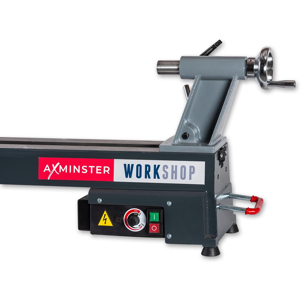

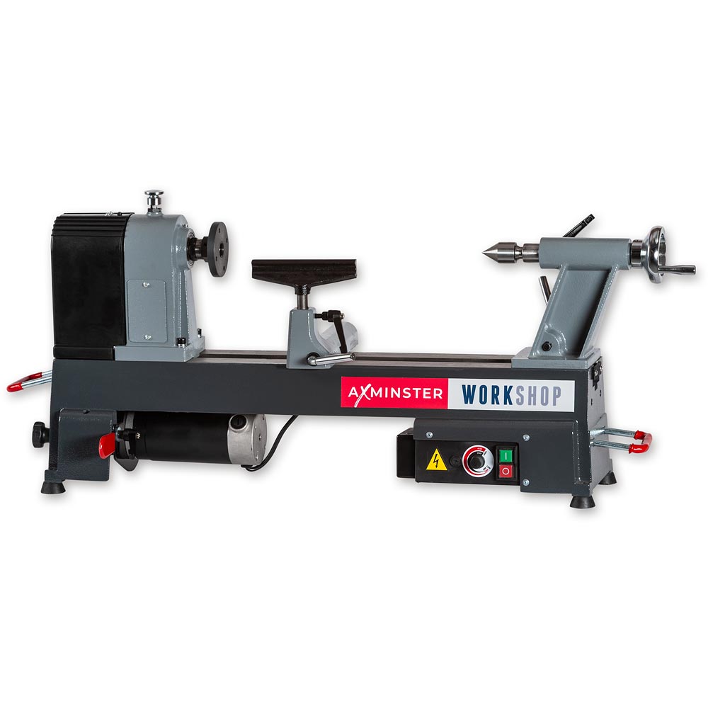

  • Powerful 550W DC motor, quiet and smooth operation
  • Variable speed from 500 to 4,080rpm
  • Cast iron bed, headstock and tailstock provide rigidity, strength and years of pleasure
This bench mounted woodturning lathe offers excellent capacity, capabilities and power. The AD305WL has the convenience of variable spindle speed with electronic control.

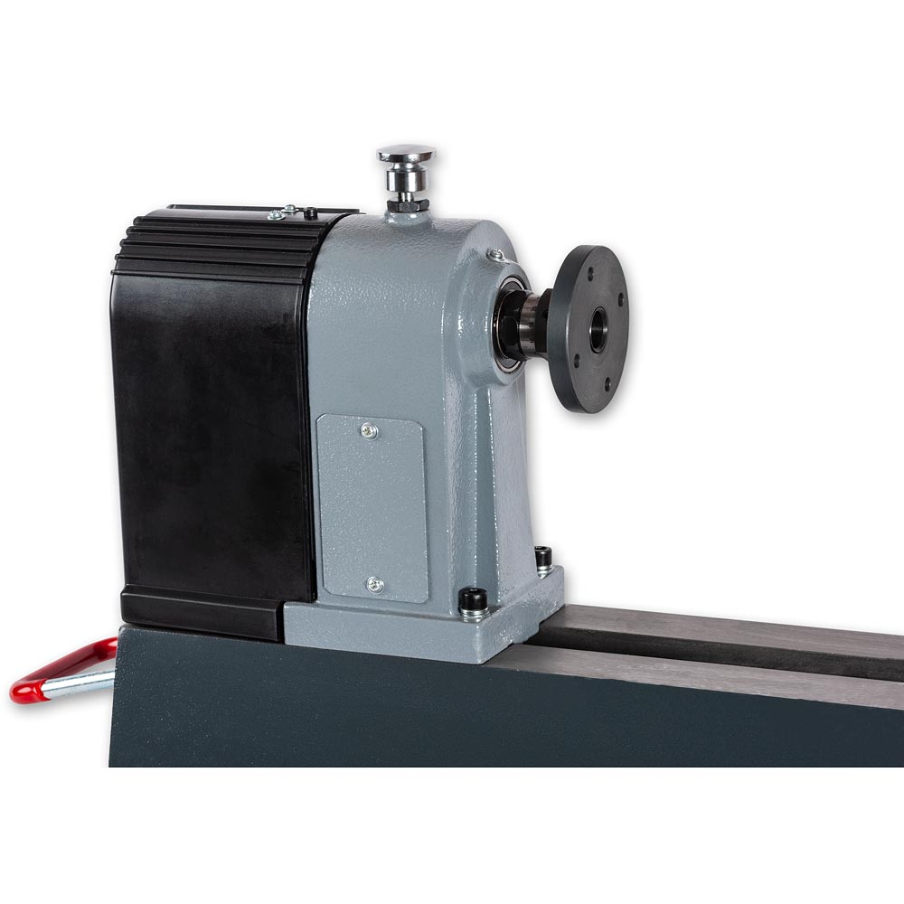

Power comes from a 550W DC motor providing full torque across the speed range. The spindle speed range is from 500 to 4,080rpm, with a choice of two belt ratios.

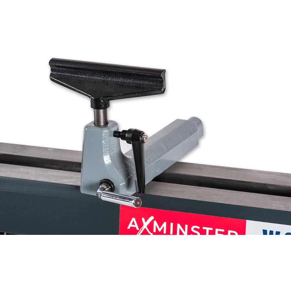

Made almost entirely in cast iron ensuring stability and minimal vibration during operation. The bed of this lathe has a finely ground top surface for smooth tool rest positioning. The spindle nose has a 1 x 8tpi thread and a 2MT taper. The tailstock barrel has a 2MT bore with 50mm of movement and automatic ejection of centres. Quick release levers allow for easy and accurate positioning of tool rest and tailstock. Solid rubber feet help to eliminate vibration.
