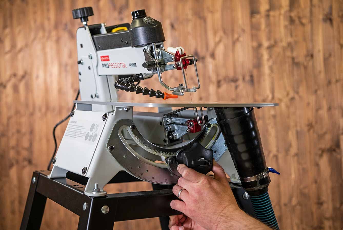

Tilting arm
The saw's arm assembly is able to tilt, with pre-set angles at 90°, 45°, 30° and 22.5°. This feature ensures the table is kept flat for easier working. It also allows for greater control and more precision when cutting.

This 406mm throat scroll saw includes an innovative design, quality construction and comes with some unique features.
The arm assembly tilts up to 45° to the right and 35° left leaving the table horizontal. With your workpiece level, you automatically have greater control and precise cuts are easier to achieve. Visibility is improved and work carried out in a natural position. The saw has a 305mm x 470mm, heavy gauge, epoxy coated plate steel table, giving plenty of support to larger workpieces. Blade changing could not be made easier. No tools required, PEGAS blade clamps are lightweight, reduce vibration and reduce stress on the machine. Changing a blade is a simple matter of operating a quick release lever. When carrying out pierced work, you can raise the upper arm to give yourself more clearance to thread the blade through the hole in the workpiece.
