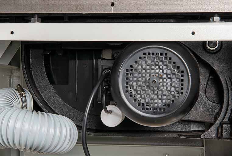

Saw design
The motor and saw arbor assembly is mounted on trunnions bolted onto the chassis, a feature which is usually reserved for much larger saws. This improves adjustability and allows for a smooth blade rise and tilt function.
Dust Extraction
The dust extraction on the AW216TS is highly efficient from both above and below the table. The crown guard connects to the main 100mm dust outlet via a sturdy 63mm hose.
A table saw, perfect for the home workshop. The AW216TS saw features a quiet running 1,100W induction motor. The saw has a generous ground surface cast iron table with twin 19mm mitre fence grooves. It comes with a 216mm Axcaliber Premium 48 Tooth noise reducing blade, giving 65mm max depth of cut.
The whole motor and saw arbor assembly is mounted on trunnions bolted onto the chassis, leaving the table completely unstressed. This design means that the blade tilt and height mechanism is exceptionally smooth. The table includes a pressed steel side extension and rear support table. The full length rip fence includes a 400mm sliding sub fence with high/low functions. Dust extraction is highly efficient from both above and below the blade. The single 100mm dust port is easily connected to a suitable extractor. The NVR switch has a separate locking Emergency Stop function for safety. Removable side panels allow easy cleaning and maintenance.
