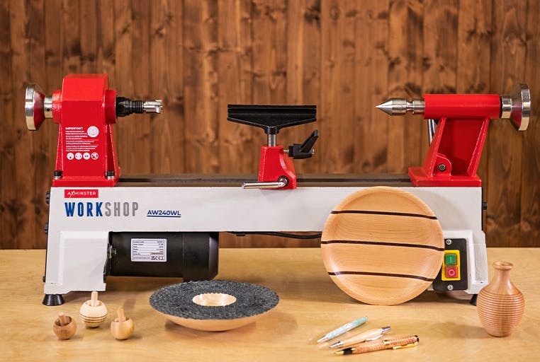

  • 5 spindle speeds, 700, 1,000, 1,400, 2,000, 2,800 rpm
  • 240mm diameter turning capacity, 440mm between centres
  • Cast iron headstock, bed and tailstock minimising vibration

A simple belt change allows you to select one of five speeds ranging from 700 to 2,800rpm.
Motor
375W induction motor has more than enough power for the lathe’s capacities and any projects that are likely to be undertaken.
Turning capacity
Features an impressive 240mm x 440mm capacity, allowing you to turn a great range of small projects and kits.
Cast iron construction
The cast iron construction ensures stability and reliability. The bed is made from cast iron, helping to reduce vibration.
Supplied with genuine Axminster Woodturning Centres
The lathe is supplied with high quality stainless steel Four Prong Drive and Revolving Tailstock Centres; both designed and manufactured in Axminster, UK.
Perfect for...
The AW240WL an ideal entry level lathe for those looking to dip their toe into turning. It is well suited for small project kits like pens and light pulls. Supplied with a 75mm faceplate, it is ideal for making small bowls too.
If you have ever wanted to take up woodturning this lathe will meet all your needs and give you hours of turning enjoyment in your workshop. It is well suited to anyone with a limited budget or only enough space enough for a small lathe.
The AW240WL woodturning lathe features five spindle speeds, giving a useful range between 760 and 3,200rpm. It has a maximum bowl turning capacity of 240mm diameter and a spindle turning capacity of 440mm between centres.
The headstock, bed and tailstock are constructed of heavy cast iron, minimising vibration. The 375W induction motor has more than enough power for the lathe’s capacities and any projects that are likely to be undertaken. Both the headstock spindle and tailstock barrel take 2MT accessories, with the spindle nose having a 1" x 8tpi thread. The tailstock also has a hollow barrel to enable long hole boring.
Supplied with Axminster drive and revolving tailstock centres, 75mm diameter faceplate and 150mm tool rest.
