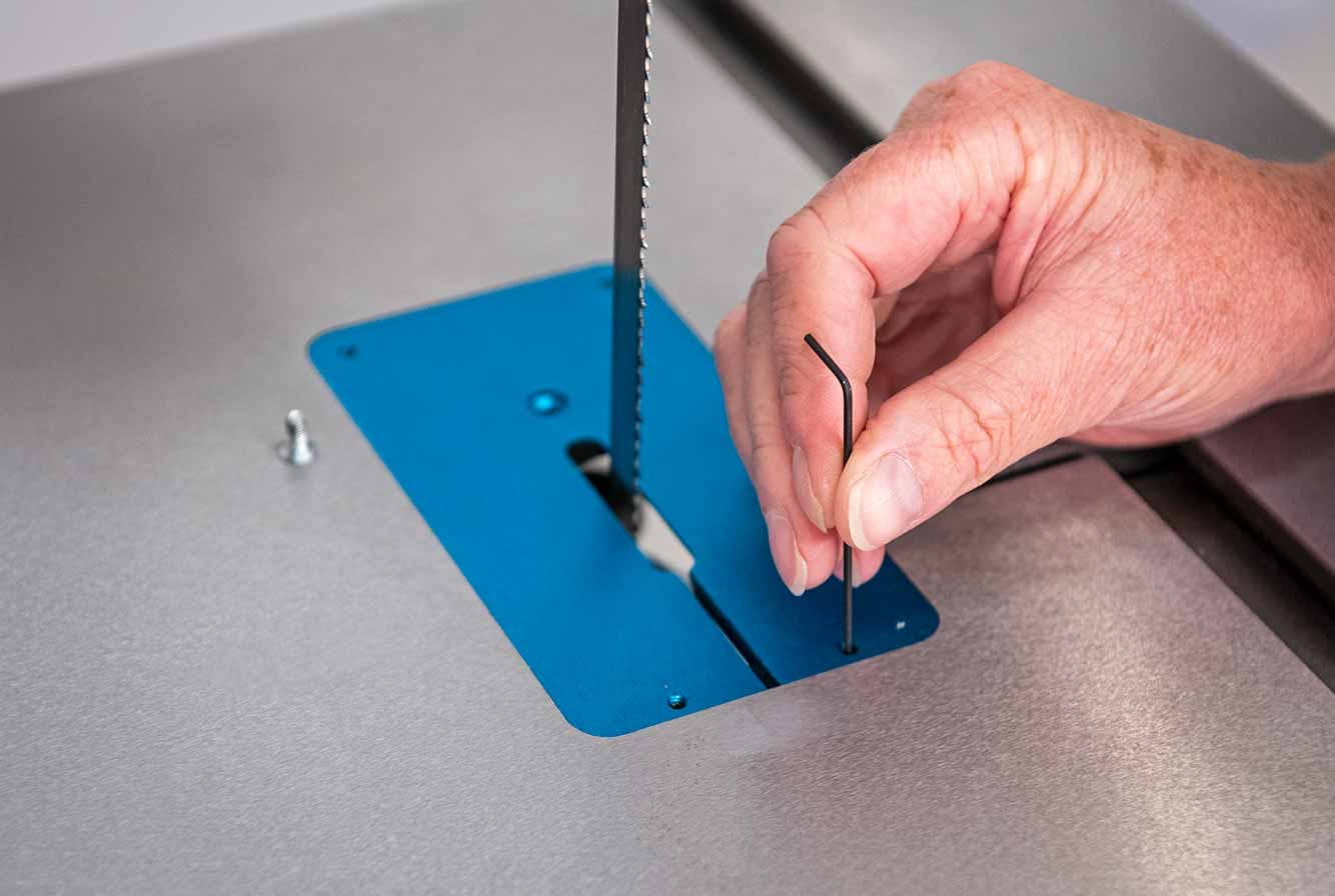

Table insert adjustment
For simple levelling.

The fully adjustable Hi-Lo aluminium fence enhances versatility, allowing for full and precise timber support for both large and small work pieces. The fence height can be adjusted to 140mm or 12mm, providing flexibility for different cutting needs. Additionally, the table insert adjustment allows for simple levelling, and the table tilt ranges from -7 degrees to +45 degrees, providing flexibility for a variety of cutting angles. The micro-polished cast iron table, measuring 400mm x 546mm, is mounted onto an oversized double cast iron trunnion with two locking points, ensuring a solid surface to work from. This table size provides ample workspace, making it easier to handle larger pieces of material.
