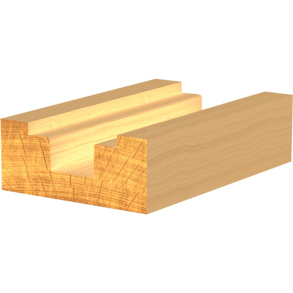

  • Produces a stepped groove suitable for Tonk strip adjustable shelving

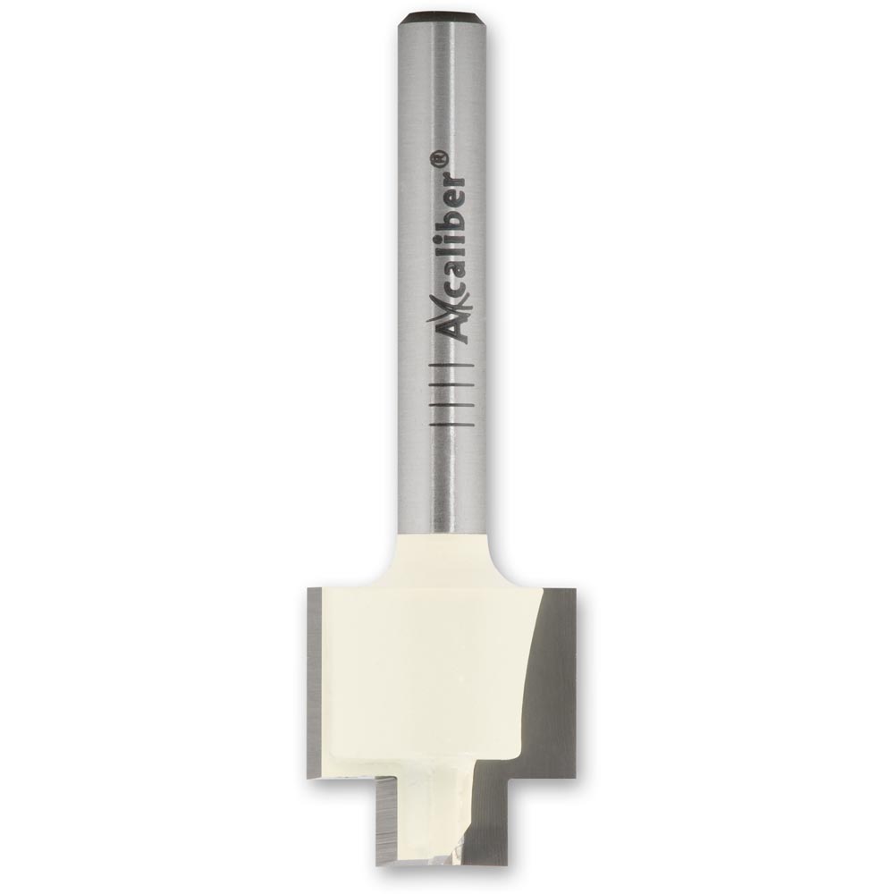

  • 19mm diameter TCT cutters
When designing bookcases it is useful to incorporate some adjustable shelving. Metal strips often referred to as Tonk strips are recognised as one of the most neat and reliable ways of achieving this. Two strips are recessed flush into each side of the bookcase and supports are used to locate the shelves at whatever height is required. At 19mm diameter these router cutters are designed to make the double groove necessary to accommodate the metal strip and fittings.

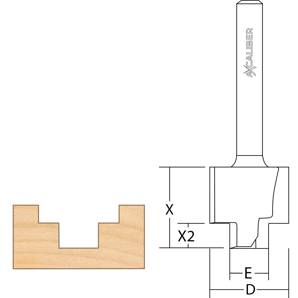

Shank Diameter 1/4" (6.35 mm)
X = Depth of Cut 19 mm
D = Overall Diameter 19 mm
E = Minor Diameter 9.5 mm (3/8) H = Horizontal Depth of Cut: 4.8 mm (3/16") Web Attribute Set: Rebate Router Cutters D: 19 H: 4.8 X: 19 X2: 6 X2 = Depth of Groove: 6 mm
