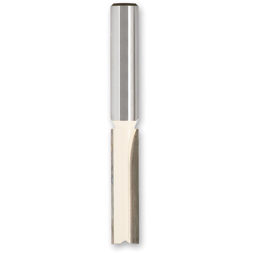

  • Long Shank Worktop Cutter
  • Bottom cut insert for efficient plunge cuts
  • High quality durable cutters

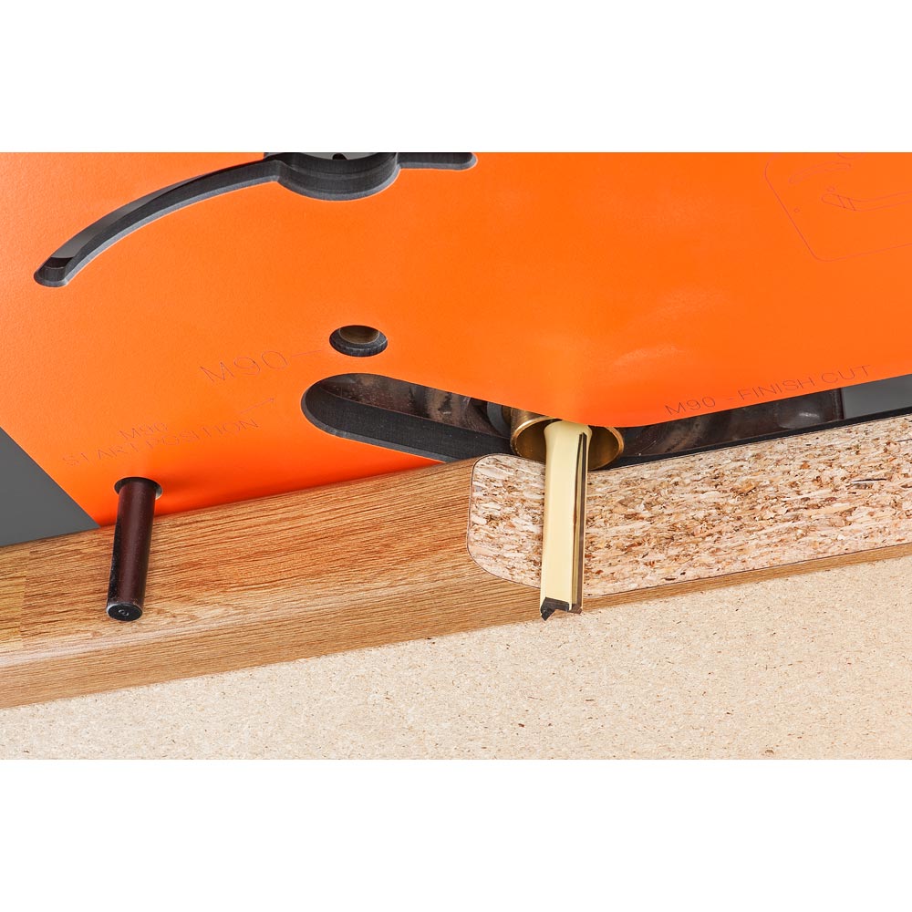

  • Excellent for use with kitchen worktop jigs

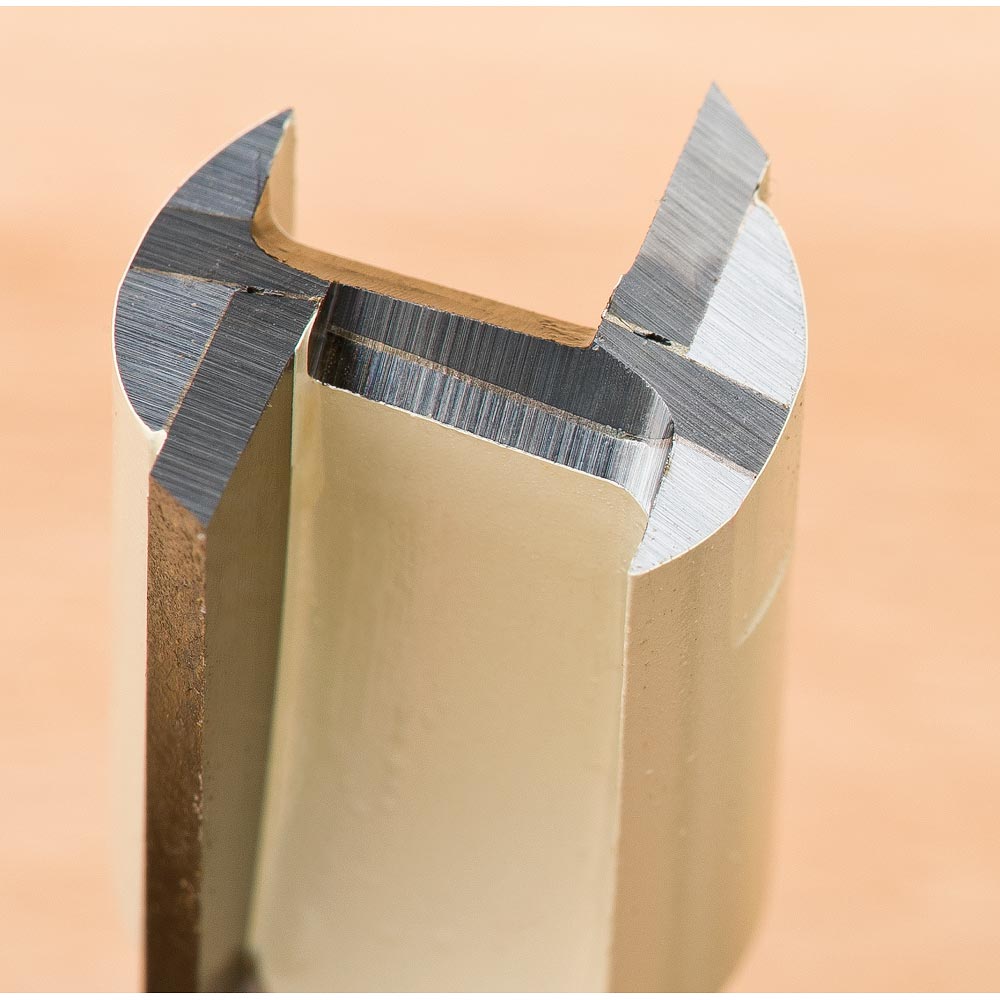

When fitting kitchen worktops using a worktop jig, it is necessary for the router cutter to be long enough to extend below the bottom of the worktop but retain a sufficient length of shank in the router collet. This can be difficult to achieve with some routers and when you add an extension to the router such as a sub-base a long shank is needed to provide sufficient protrusion from the base. It's critical that the router bit is inserted to the K Line as moving away from the line causes instability. With this in mind we have introduced a worktop cutter featuring a longer shank than usually found on this type of cutter. This ensures you have enough reach to cut safely through the work piece. These cutters also feature a bottom cut insert for efficient plunge cuts. 50mm depth of cut, 12.7mm diameter and 107mm overall in length.

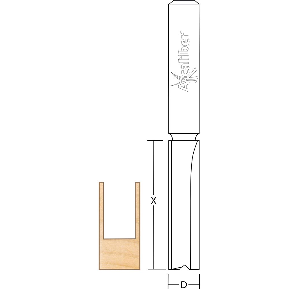

Shank Diameter 1/2" (12.7 mm)
X = Depth of Cut 51 mm (2")
D = Overall Diameter 12.7 mm (1/2")
Pack Quantity 1
Web Attribute Set Straight Router Cutters D: 12.7 X: 51
