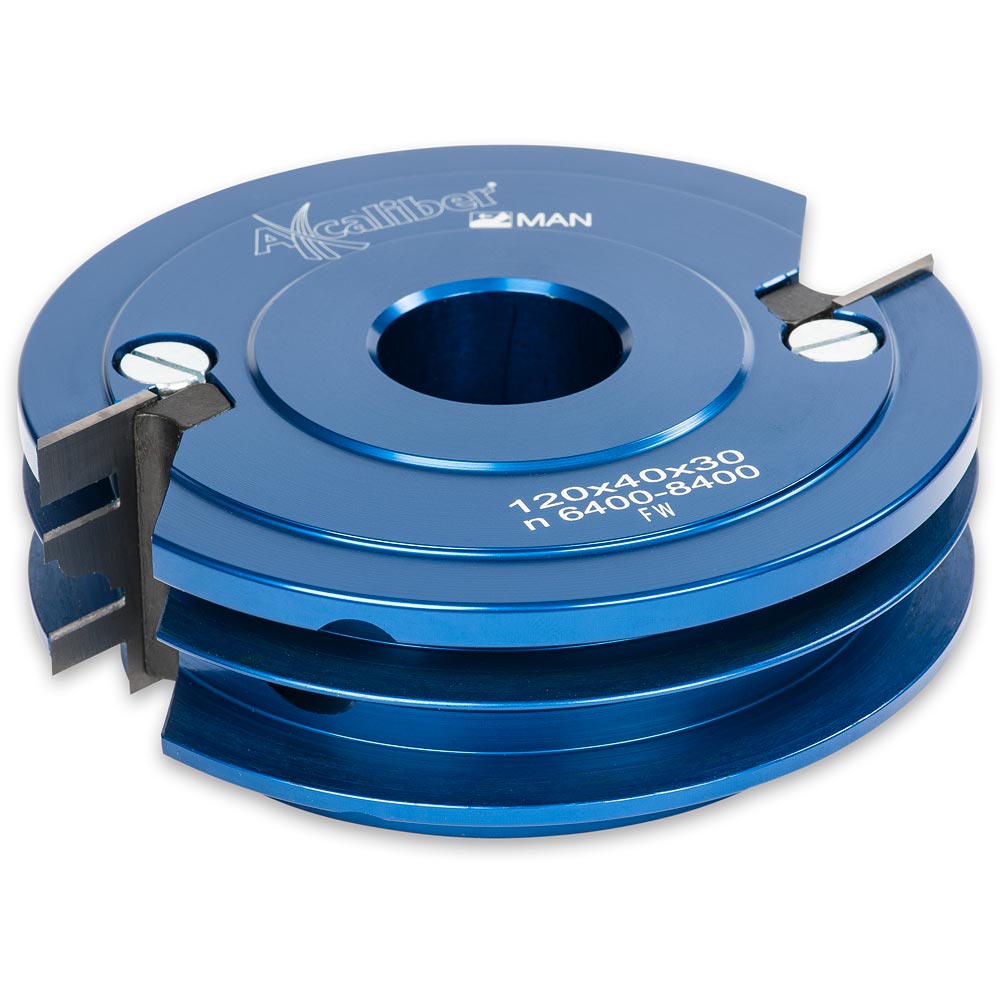

  • Hard aluminium alloy body with high resistance to tensile and yield stress

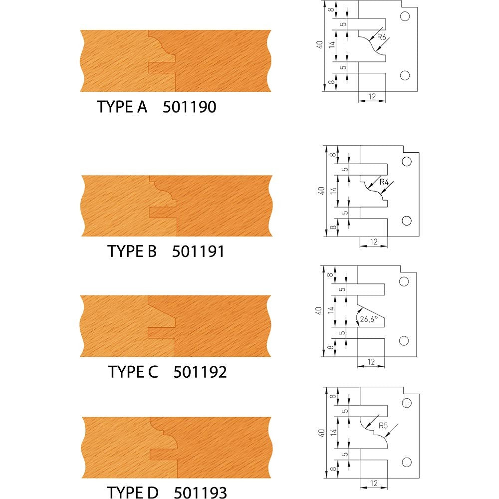

  • 2 solid tungsten carbide knives type (B) 40 x 24.5 x 2mm
  • Suitable for manual feed( MAN)
  • Pins for the automatic positioning of the knives
  • Supplied in a solid plastic box
This cutter head represents the union of two cutters in one tool and it is the ideal toolhead for the construction of furniture doors and drawers. By simply adjusting the height of the head, you can cut two perfectly joining profiles with no wasted time or effort moving the fence or changing the tool. Perfect for solid woods and panel materials in sizes 22mm - max 25mm stock. Cutting diameter 120mm, bore size 30mm.Supplied with Type B Cutters
