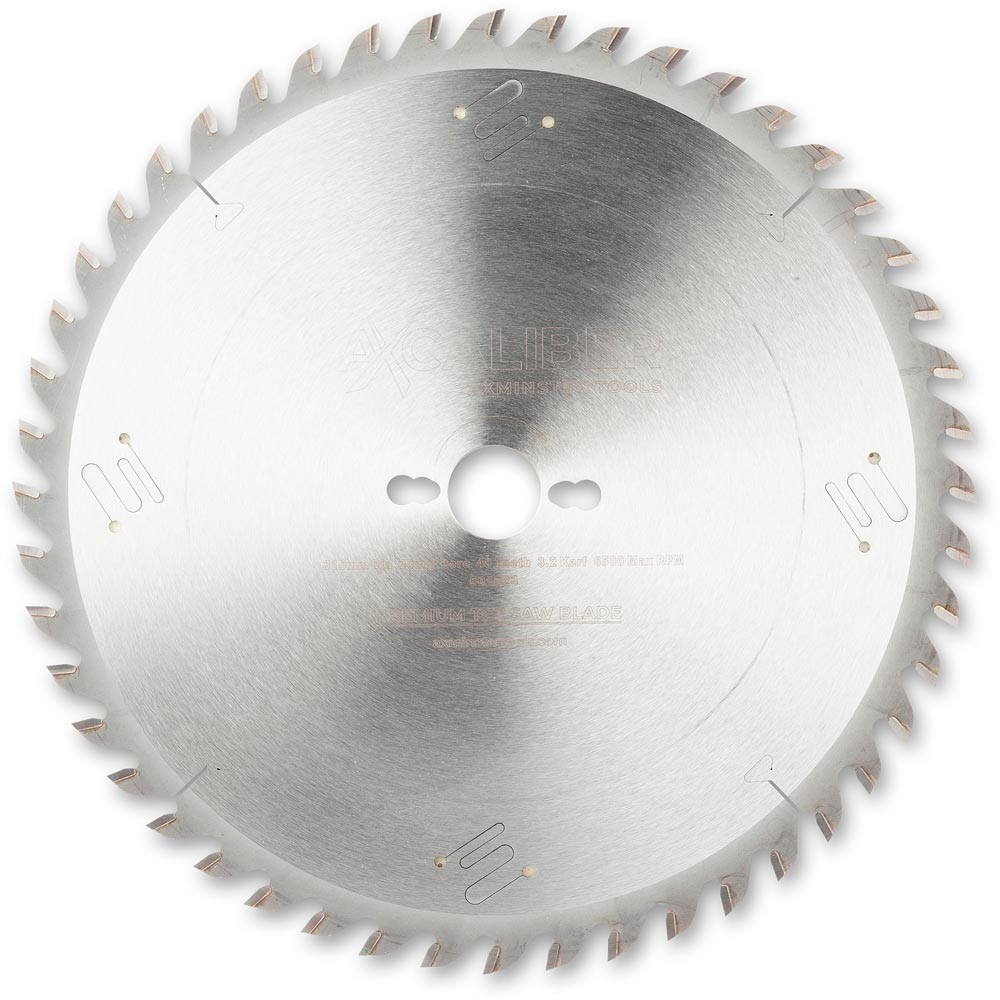

  • Micro grained TCT tips
  • Resin damped, laser cut plates
  • 12 hook angle
  • 3.2mm kerf
  • 30mm bore, reducing bushes available
Axcaliber Premium circular saw blades are from the world's largest blade manufacturer. Using the latest production techniques and the best materials, the Premium blades feature micro grain TCT tips and resin damped laser cut plates, which substantially reduce noise whilst cutting. The Premium range is the blade of choice for all joinery and cabinet workshops demanding the very best performance.
The rip cut blades feature Alternate Top Bevel (ATB) ground teeth, ensuring a clean, fast cut. The tops of the teeth are bevelled alternately at approximately 15 degrees. This tooth configuration bears a sharp pointed tip that provides a neat clipping action for very fine finishes. Two teeth will span the entire width of the kerf.
It produces very low cutting pressures that almost eliminate the tendency to tear out. The chips fall free in the chip spaces created by the large side clearance angles.
The fine crosscut blades feature trapezoidal ground teeth, known as a Top Centre Ground or Triple Chip tooth profile where one flat top tooth is followed by a trapezoidal tooth, which is slightly higher. The higher tooth cuts material narrower than final kerf, helping to eliminate chipping and tear out. This provides the finest finish on all woods or manmade boards including faced boards.
Blade Diameter 315 mm
Maximum RPM 6,500 rpm
Kerf 3.2 mm
Teeth 28
Tooth Format ATB
Plate Thickness 2.2 mm
Hook Angle 12
Bore Size 30 mm
Blade Application Rip (28 teeth)
Web Attribute Set Circular Saw Blades
