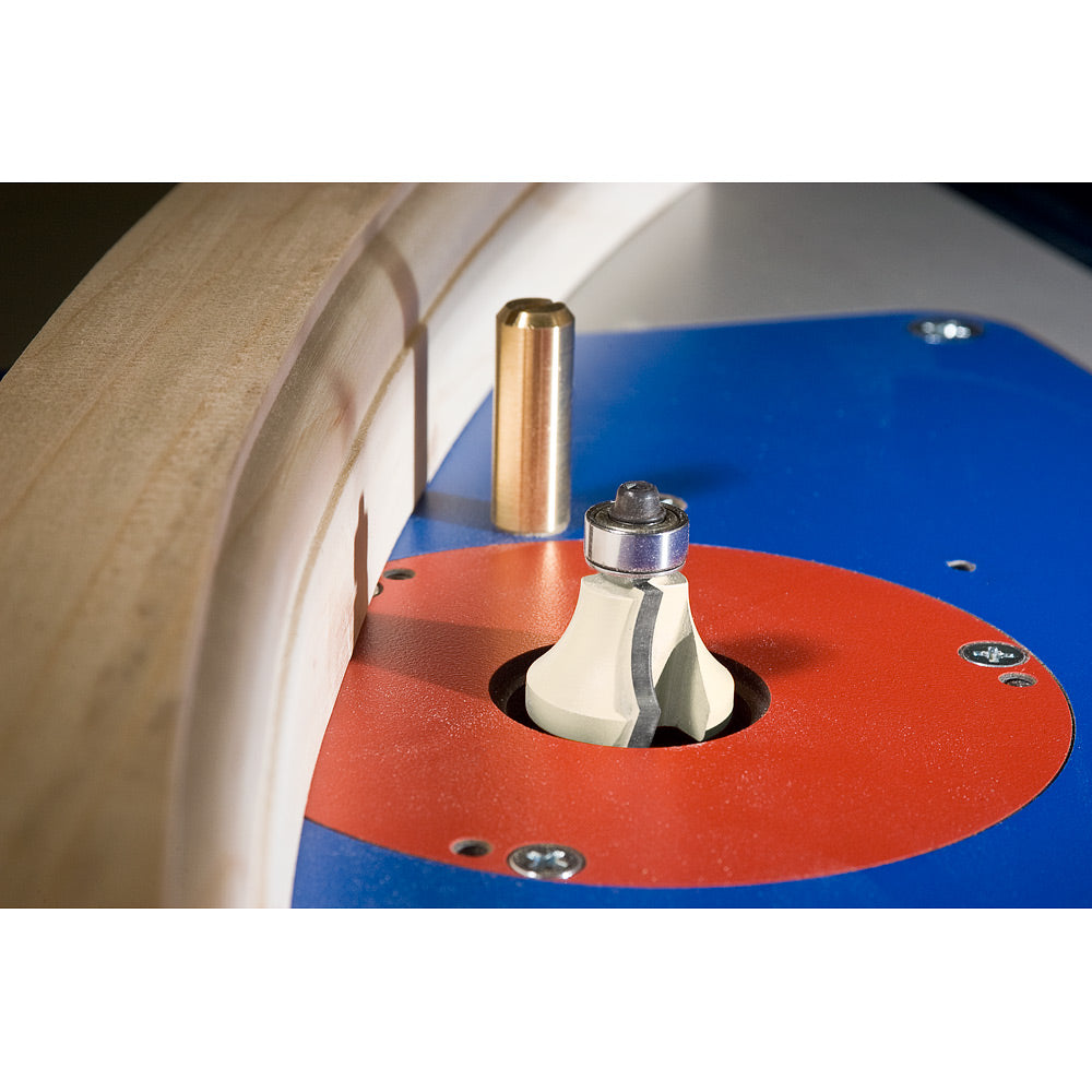

  • Bearing guided cutter suitable for curved rails and sash bars
  • Make sash windows quickly and efficiently
  • Matching scribe cutter available
  • Reproduces the type of moulding found on many older style window sashes

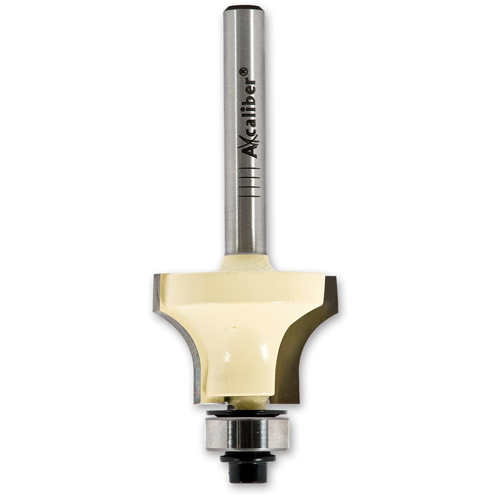

This cutter is used for the fast, accurate and efficient manufacture of sash windows using a router table set-up. It will produce the moulding on the stiles and rails and a matching cutter (Axcaliber Sash Bar Ovolo Scribing Cutter) produces the scribe at the ends of the rails and sash bars to fit over it. Being bearing guided, this cutter is also suitable for curved rails and sash bars. This cutter is 28mm diameter, 10mm radius and 19mm depth of cut. Available in 1/4(6.35mm)shank only.
Axcaliber router cutters are high precision tooling, made using advanced technology on multi axis CNC machines. A high shear-cut angle gives them a smooth cutting action and results in a clean finish. The tips are diamond-ground micrograin tungsten carbide. PTFE coating minimises resin build-up.

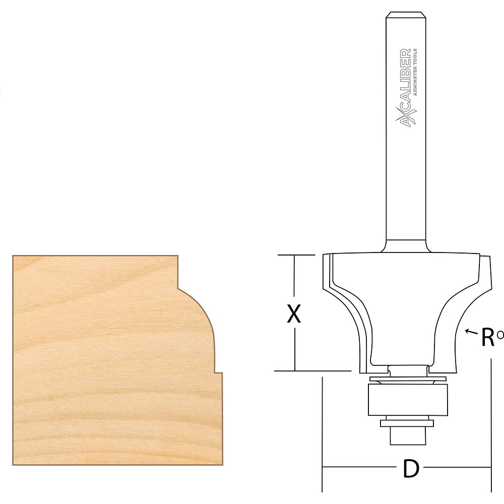

Shank Diameter 1/4" (6.35 mm)
X = Depth of Cut 19 mm
D = Overall Diameter 28 mm
R = Radius 10 mm
Web Attribute Set Ovolo & Rounding Over Router Cutters D: 28 R: 10 X: 19
