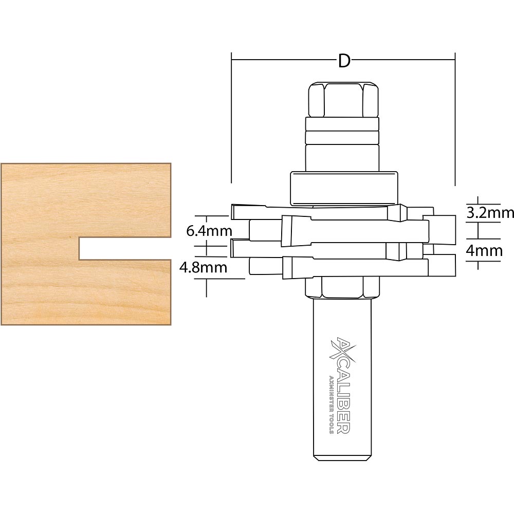

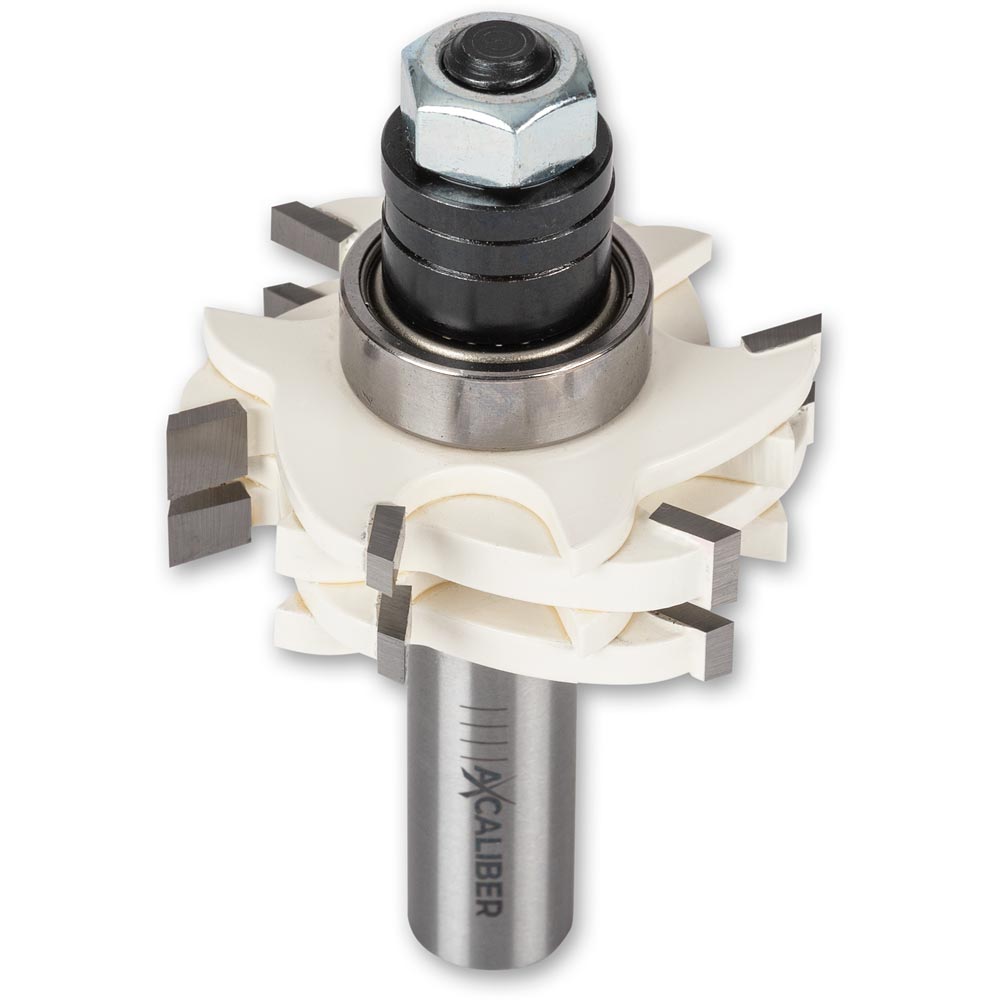

  • Axcaliber three wing slot cutter set
  • A very versatile set for a wide range of groove sizes

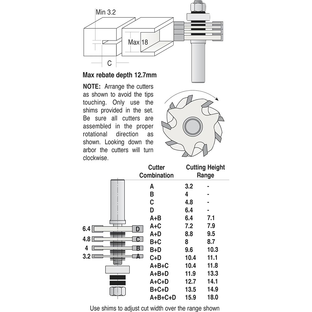

  • Suitable for grooves from 3.2mm to 18mm x 12.7mm deep
  • PTFE coating helps minimise resin build-up

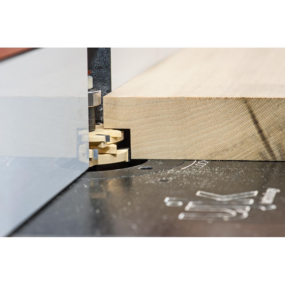

  • This cutter is for use in router tables only
Designed for router table use, this set can be used to create slots, grooves and rebates from 3.2mm to 18mm in depth. The set includes: 4 x three winged cutters 3.2, 4, 4.8, and 6.4mm in width. 1/2 shank arbor. 21 shims (8 x 0.1mm, 4 x 0.5mm, 5 x 1mm, 2 x 3mm and 2 x 6mm).
N.B. The carbide edges of the cutters should never touch; arrange the cutters to prevent this. Use only the thicknesses provided in the set. Be sure all cutters are assembled in the correct rotational direction.Safety tips: Never use the slot cutter set without shims between the cutters. The distance between the cutters can vary from 1mm to 1.5mm. A shim must also be positioned between the ball bearing and the cutters.
