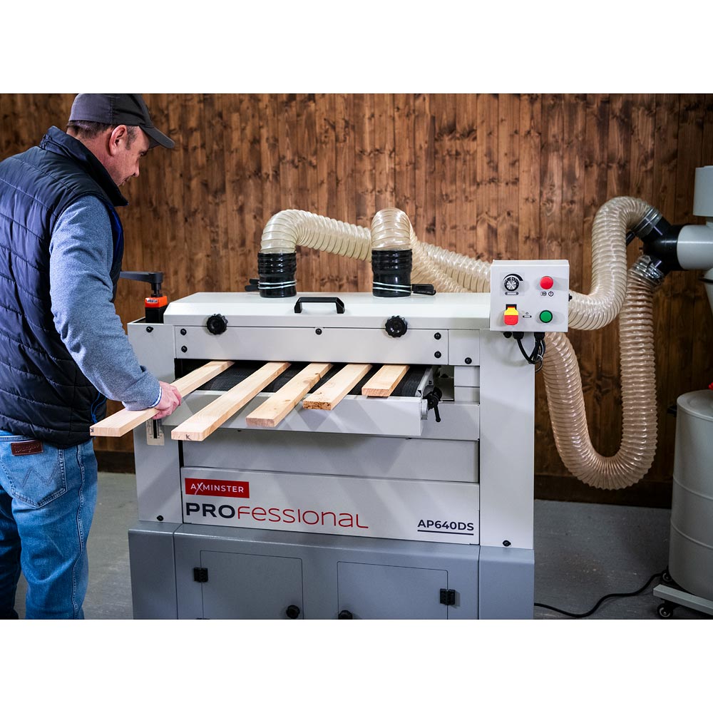

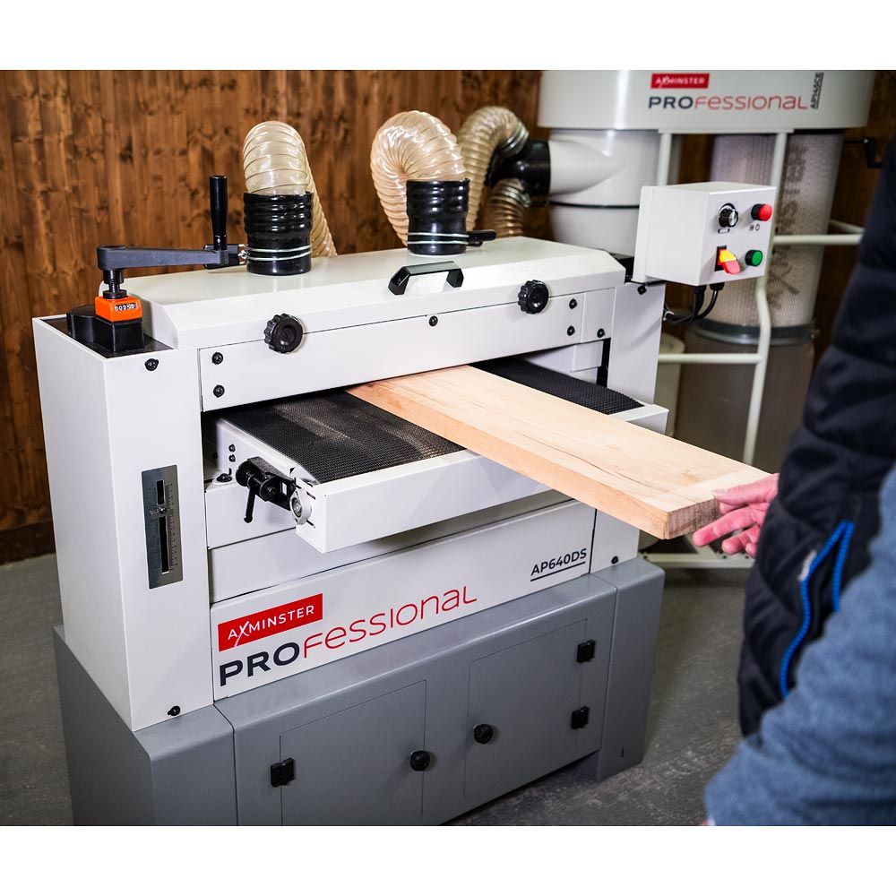

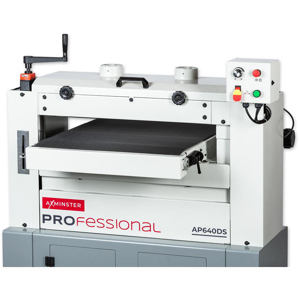

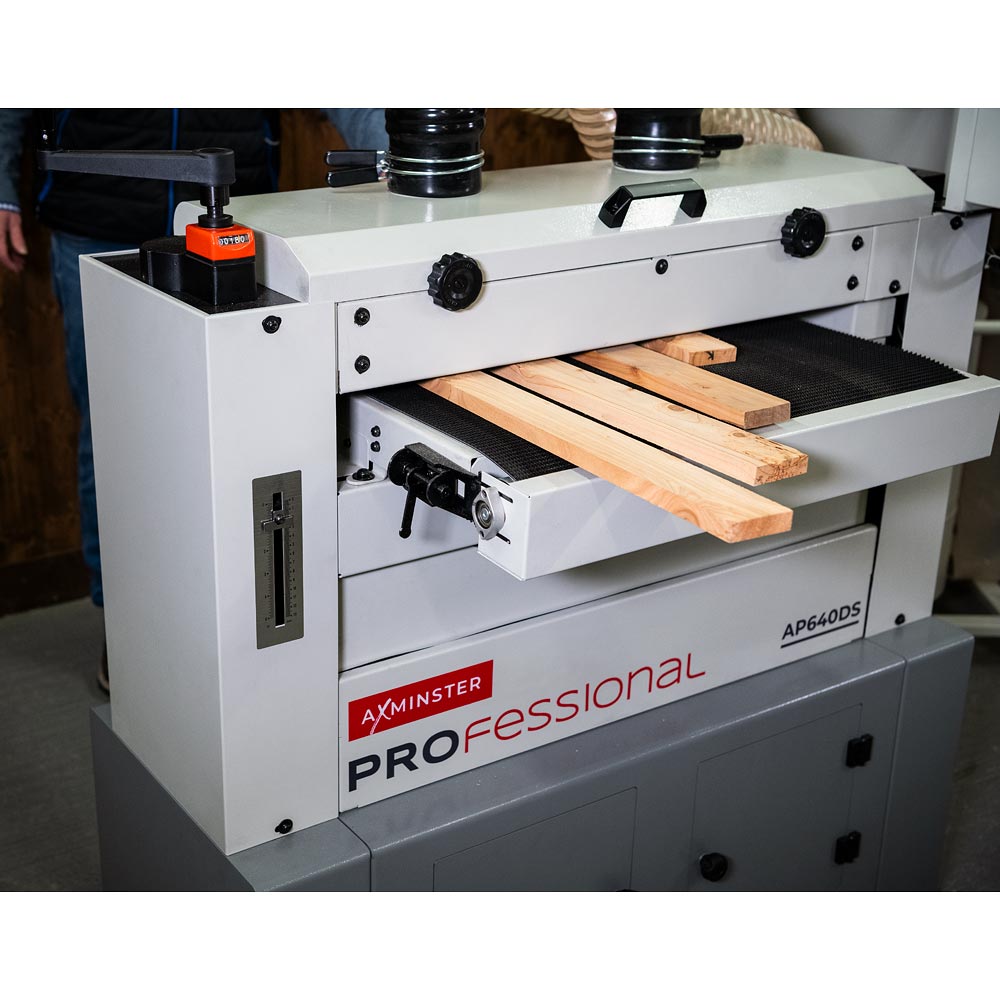

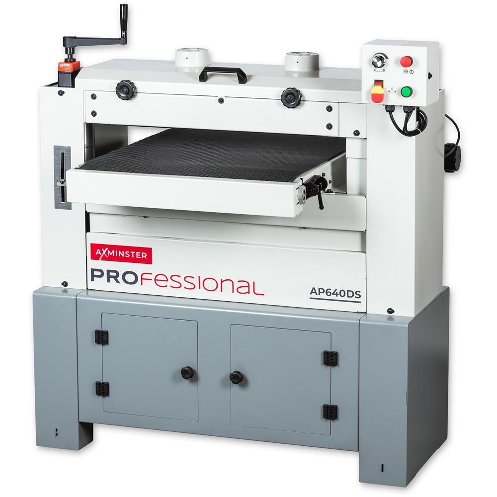

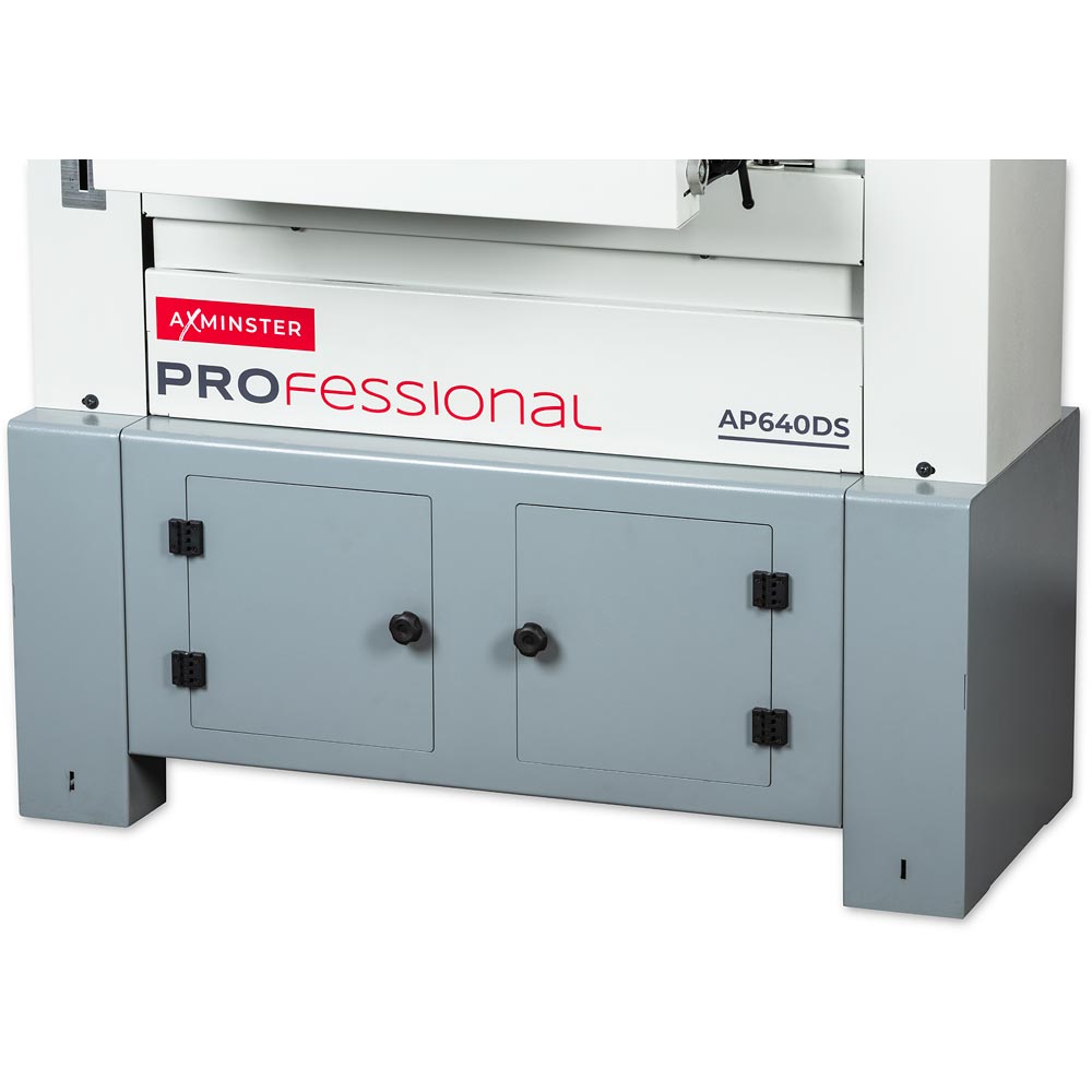

The Axminster Professional AP640DS Drum Sander is a heavy duty dual drum sanding machine designed for workshops that demand speed, accuracy, and a flawless finish. With its dual-drum system, robust cabinet stand, 3kW motor and precise digital controls, the AP640DS Drum Sander delivers exceptional results across a wide range of materials including wood, plastics, and similar materials.

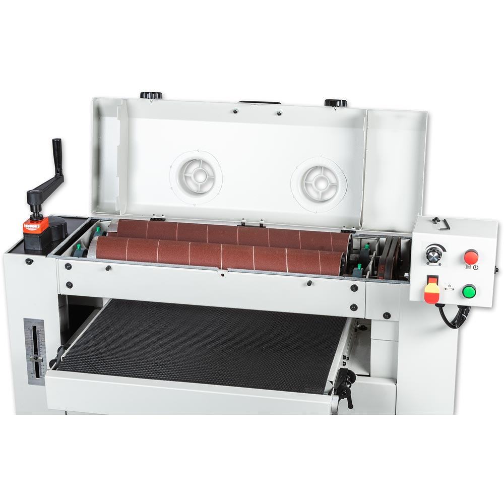

The advanced dual drum sanding system allows you to run 80 grit and 120 grit belts simultaneously, combining coarse material removal and fine finishing in a single pass. This dramatically reduces sanding time while delivering consistent, professional-quality results, especially with the power of the 3kW motor.

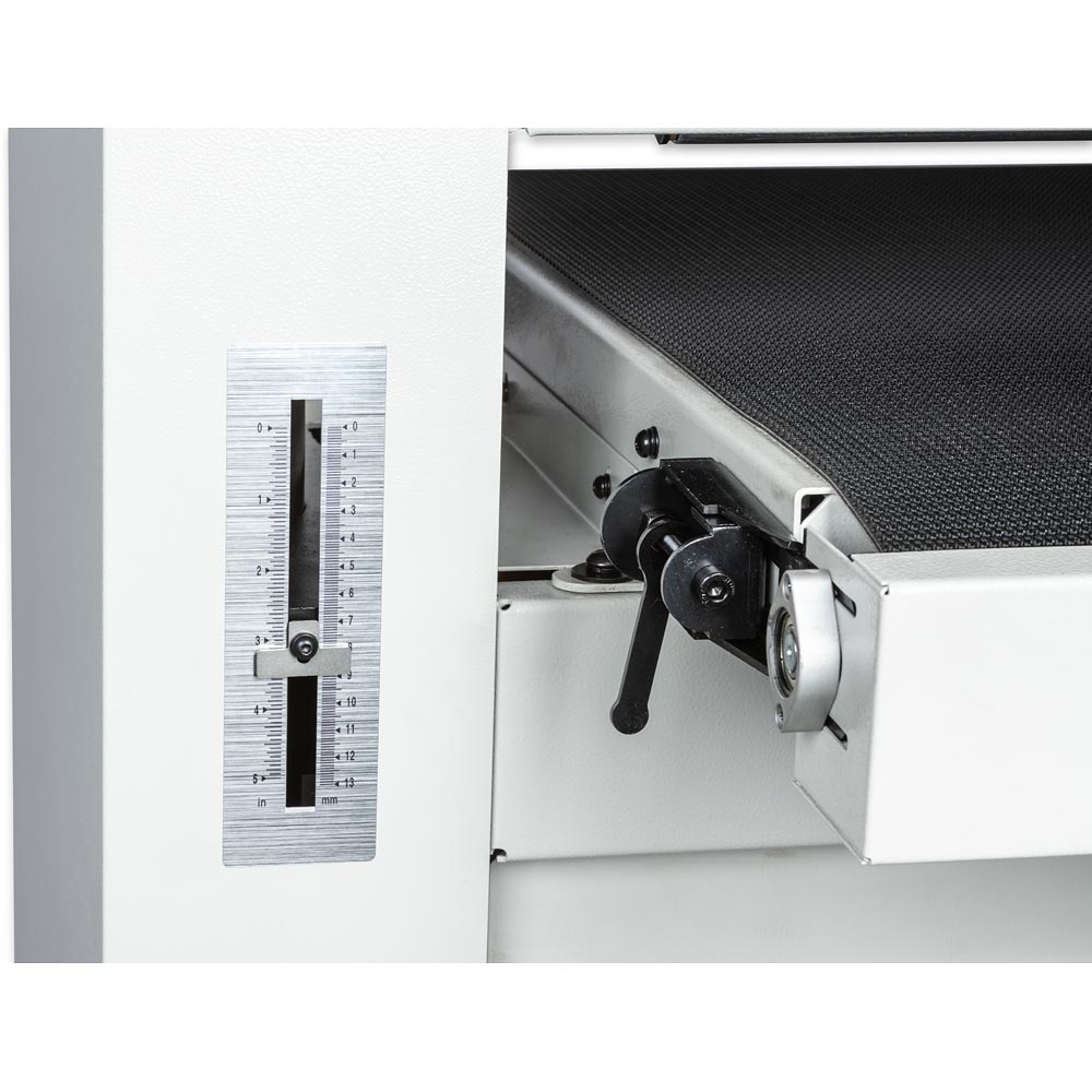

A digital height adjustment scale ensures exact worktable positioning every time, removing guesswork and improving repeatability. The large, ergonomically designed adjustment handle makes fine height changes quick, smooth, and accurate, even when working with demanding materials.
The AP640DS Drum Sander is built on a solid, heavy duty cabinet stand, providing excellent stability and long-term durability in professional environments. Dynamically balanced sanding rollers minimise vibration, resulting in smoother operation, reduced machine wear, and a superior surface finish.

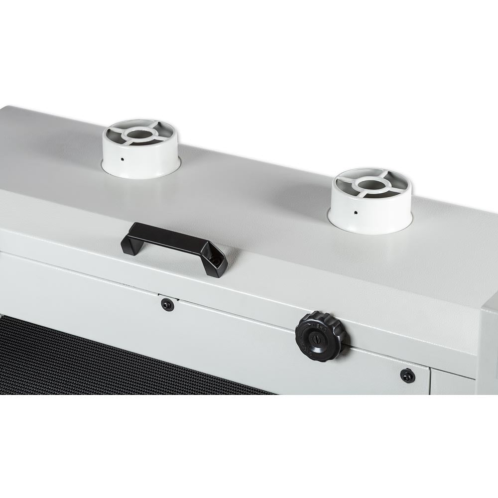

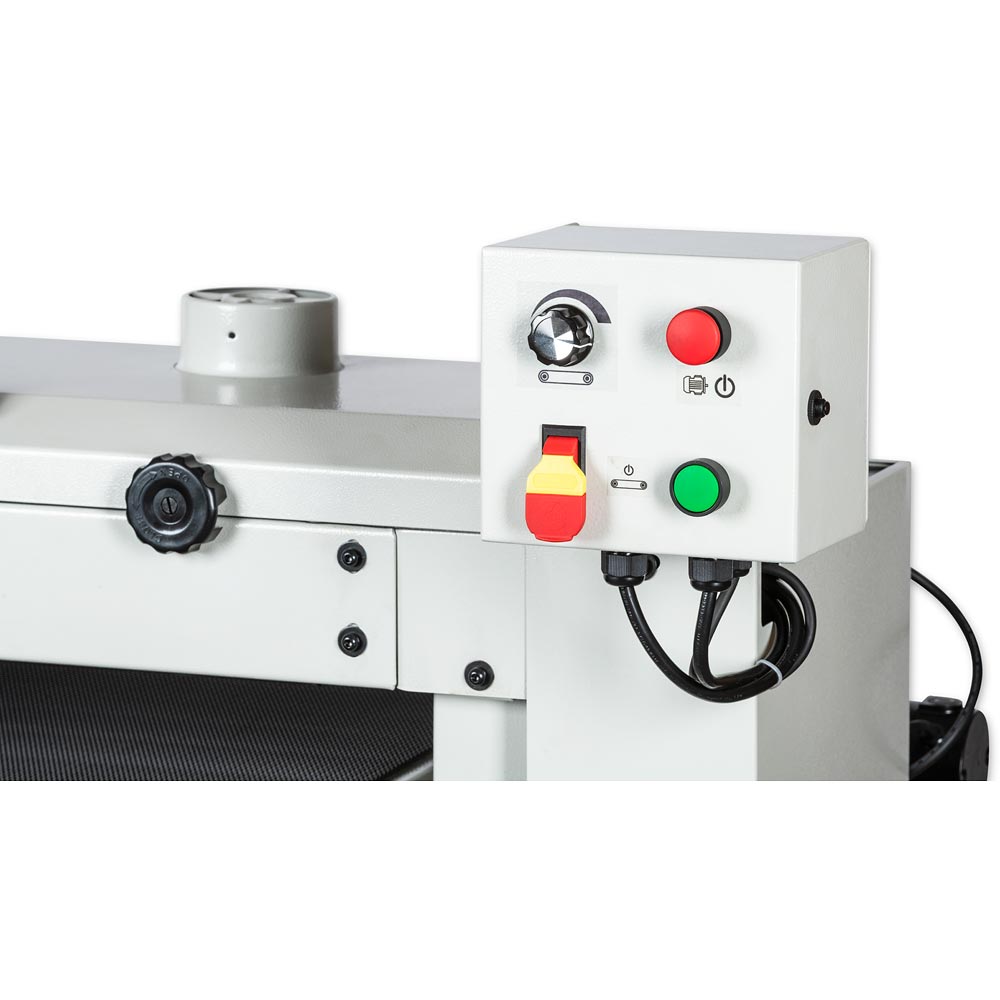

The variable conveyor speed (0–4.6 m/min) allows full control over material feed rate, ensuring optimal sanding performance for both aggressive stock removal and fine finishing. Two 100mm dust extraction outlets efficiently remove dust and debris, keeping the workspace cleaner and improving air quality.
