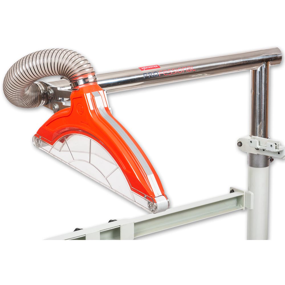

The Axminster Professional Overhead Crown Guard has been designed for use with the Axminster Professional AP254SB Table Saw. With a wide range of possible adjustments, it could suit many machines. This kit will provide both a crown guard which is recommended by the HSE for the improved user protection as well as superior dust extraction and therefore a cleaner working environment. The overhead guard hinges back for easy access to the blades and the clear hood offers visibility during cutting. The crown guard is also wide enough to accommodate a tilted blade. A must when using a dado cutter head, the crown guard will enhance this table saw, making your work safer and more efficient.
There is a 63mm extraction port at the rear of the top arm. Compatible saw blade diameter is 200-305mm. Suitable work table height to the floor is between 800-930mm; distance from the saw blade to the edge of the rightest table is between 600-1,400mm.
Overall L x W x H 1,050mm x 600mm
