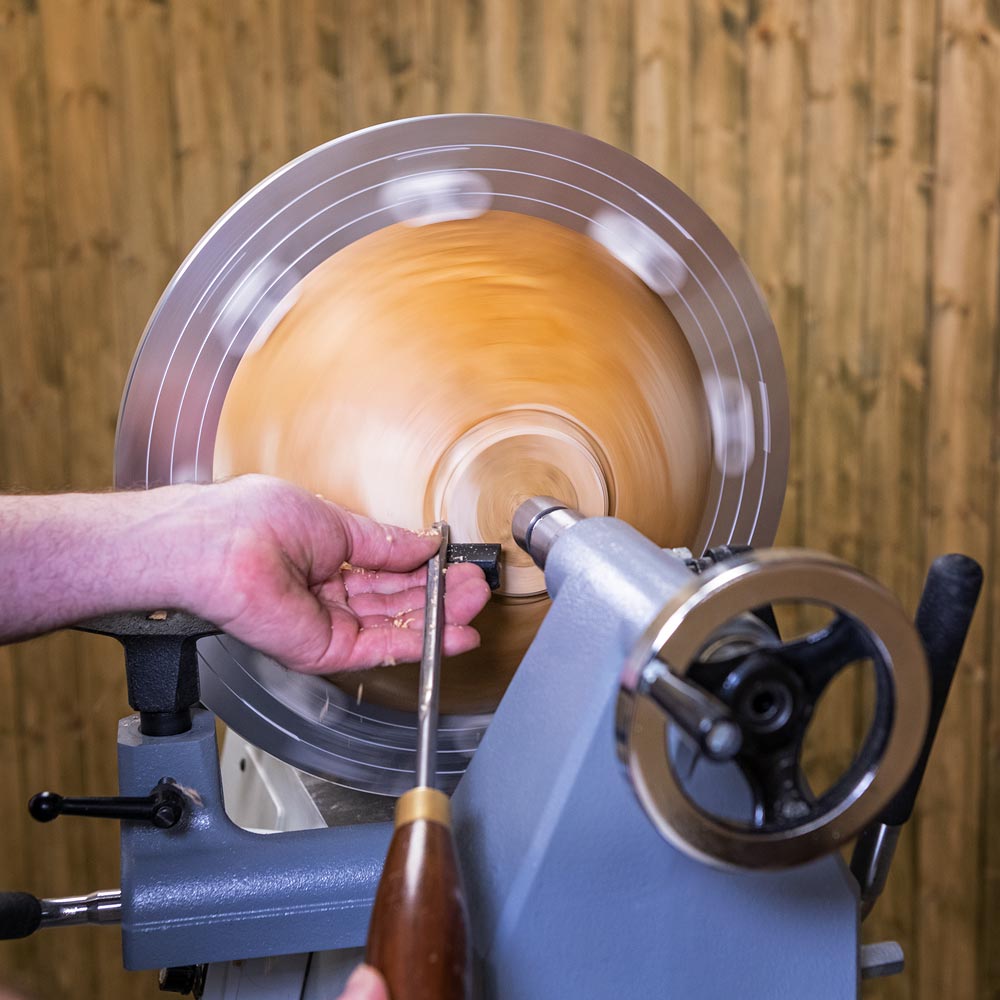

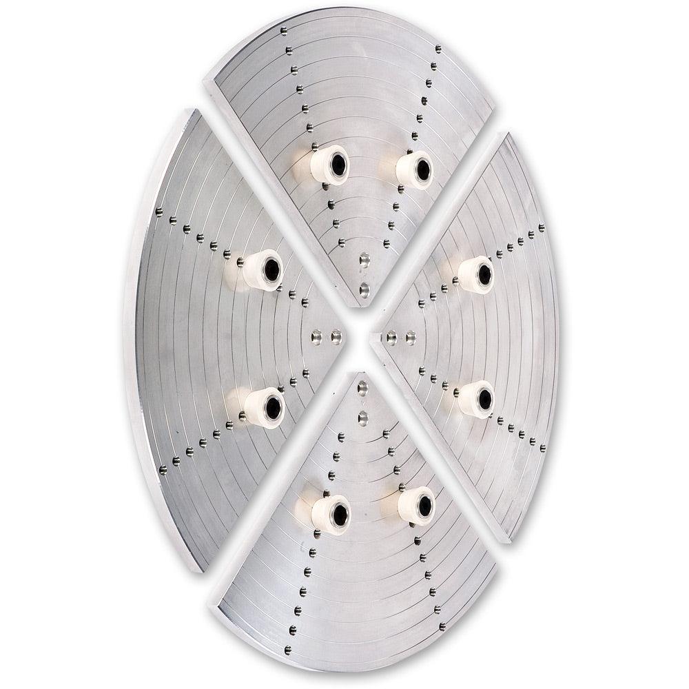

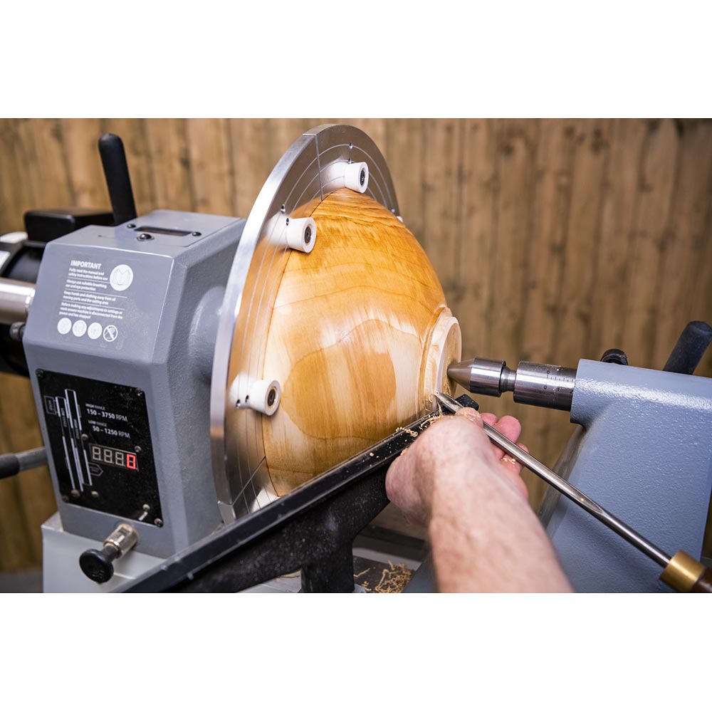

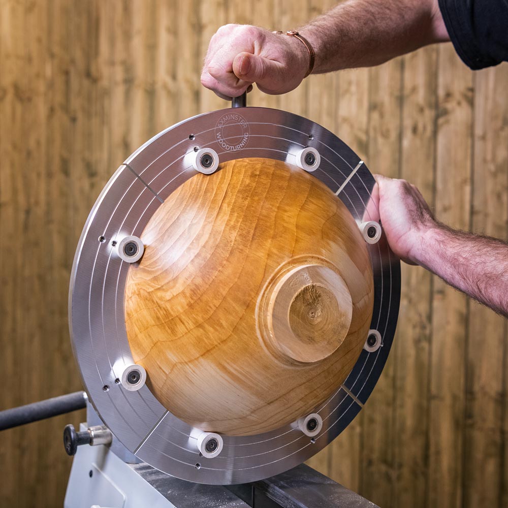

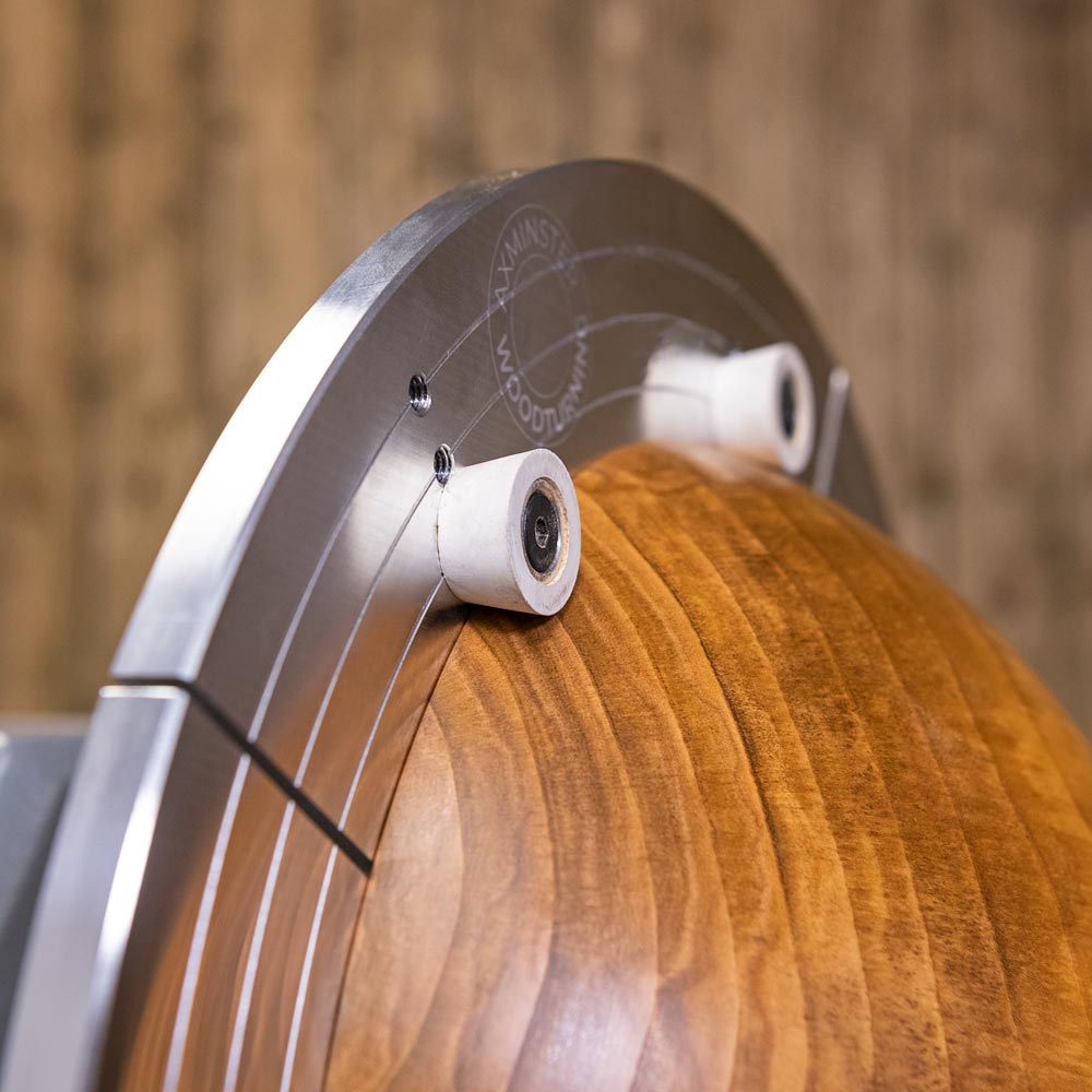

This 400mm Button Jaw set has the capacity to grip large diameter bowls. The arrangement offers an excellent method of reverse chucking and holding a previously turned piece firmly but gently. Although the rubber buttons are easy on the wood, they are not particularly suitable for bowls with a very fine edge. In such a case, a better alternative would be specific wooden jaws mounted on Axminster wood jaw plates. For better access, a longer chuck key may be required when using button jaws.
As an alternative to using the buttons, stacking turn studs are available as an optional extra. They form an excellent primary holding method for all manner of round or square blanks and, give a very secure grip. The studs can be used singly or doubled up using the longer bolts supplied.
Made from aluminium, making them lightweight.
Please note: these jaws are compatible with the GK100 (requires Long Key 340017), SK100 and SK114 chucks ( requires Long Key 600120). As with all the Axminster Woodturning Dovetail Jaws they simply bolt onto the Accessory Mounting Jaws.
