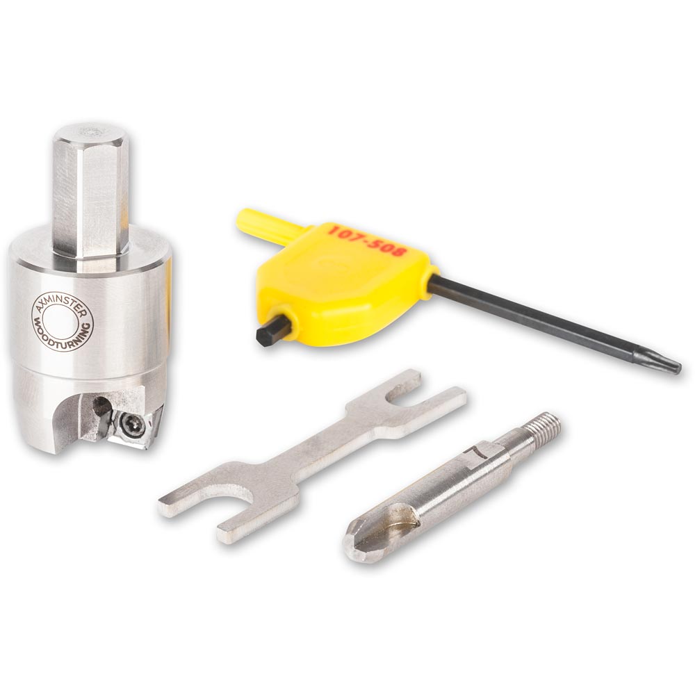

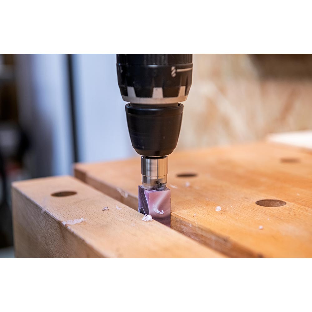

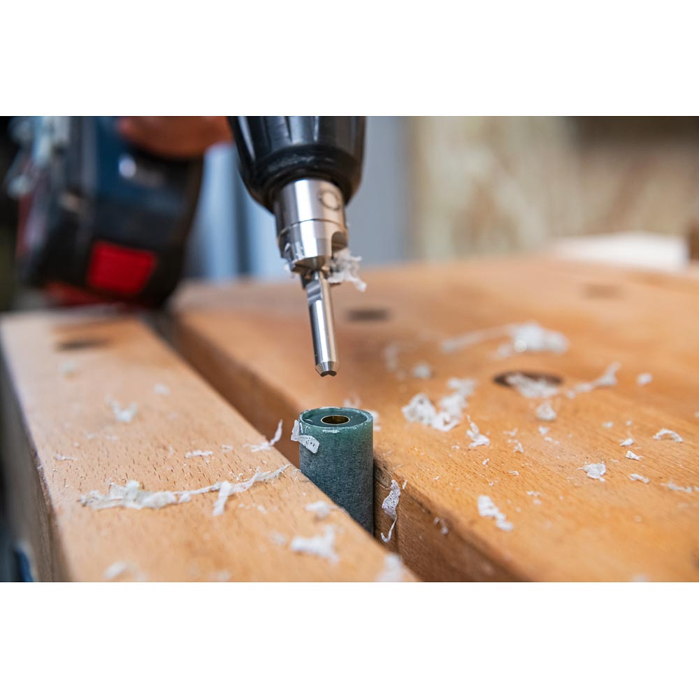

Create perfectly precise pens and pencils every time with the Axminster Woodturning Pen Trimmer and Reamer Set. The process of making beautiful, custom-made pens and pencils requires precision when prepping the blank and brass insert tube. Once the brass tube is glued inside the blank, it's crucial that the blanks are trimmed perpendicular to and perfectly flush with the ends of the insert tube. If not achieved, then you run the risk of there being gaps in the finished product and parts of the assembly not coming together well. The Axminster Woodturning Pen Trimmer and Reamers, eliminates this from happening and ensures you achieve perfect end results.
This convenient set includes the Axminster Woodturning Trimmer as well as the 7mm Pen Reamer, to accommodate the most commonly sized brass insert tubes. The trimmer is made entirely of stainless steel and features carbide tipped cutters which have a high top rake angle to cut effortlessly through a variety of materials. The results are clean, accurate and smooth cuts on wood, polyester, acrylic and more. Also included in the kit is a spanner to tighten and untighten reamers to the trimmer. As well as a hex key to secure the carbide tips to the trimmer.
Create bespoke Pen and pencils to write home about with Axminster Woodturning.
N.B. Whilst the carbide tipped cutters are designed for maximum longevity, when you do eventually require a fresh edge, the hex key can be used to turn the cutters for a fresh edge.
The diameter size on the reamers indicates the size of drill bit required/used to drill the hole into your blank.
