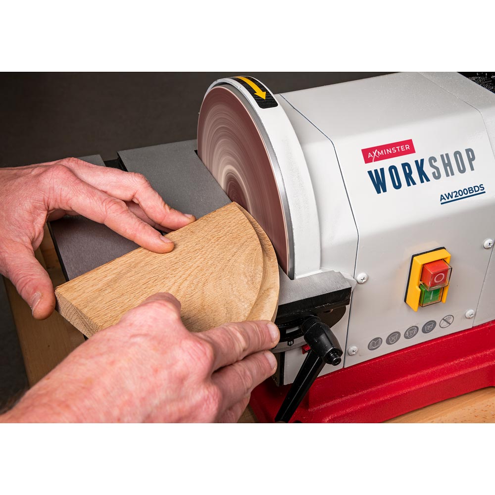

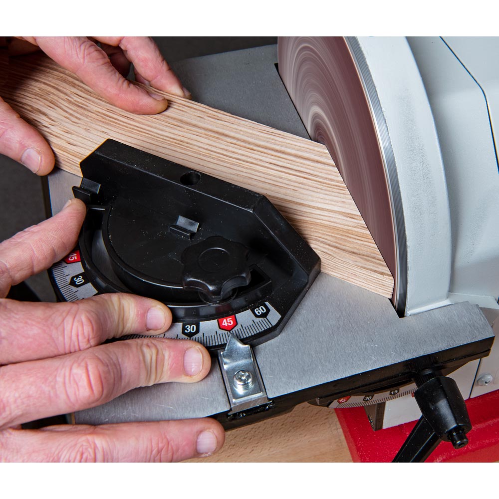

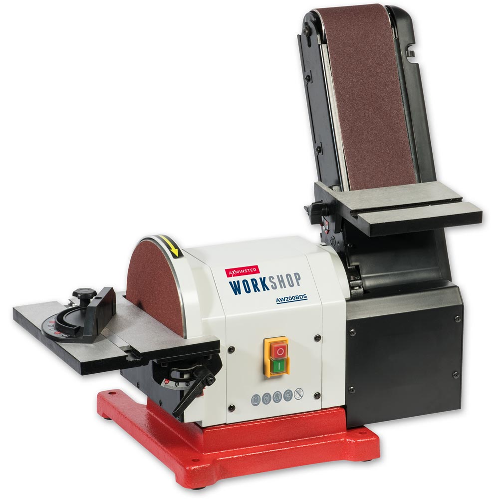

The AW200BDS is a powerful combined 100mm belt and 200mm disc sander. The belt and the disc are driven directly from the motor spindle. As a consequence the machine is much quieter, there are no fiddly drive belts to worry about and does not suffer from a loss of power caused by a drive belt. Both functions feature cast worktables, which pivot from 0° to 45°. A mitre fence is supplied for bevel and compound angle sanding.

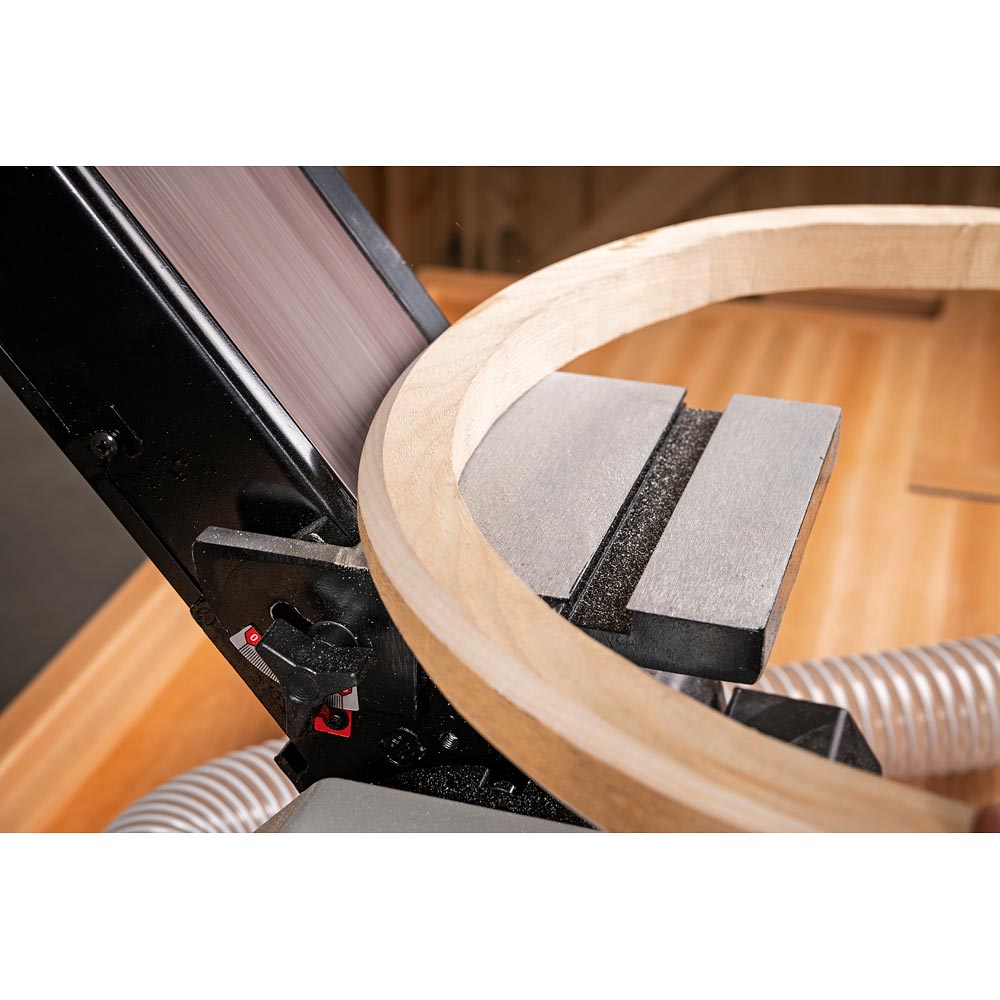

The belt sanding platen can be used vertically or horizontally or anywhere in between. The machine has a 63mm extraction outlet. A powered fan in the dust outlet port helps produce an airflow around both the belt and disc. When connected to a suitable vacuum extractor almost 100% dust extraction can be achieved. The main body is cast iron, which absorbs vibration and has locating holes with rubber grommets for securing this sander to a workbench.
The AW200BDS is supplied with a belt and hook and loop abrasive disc. There is a wide selection of abrasive belts and discs available.
