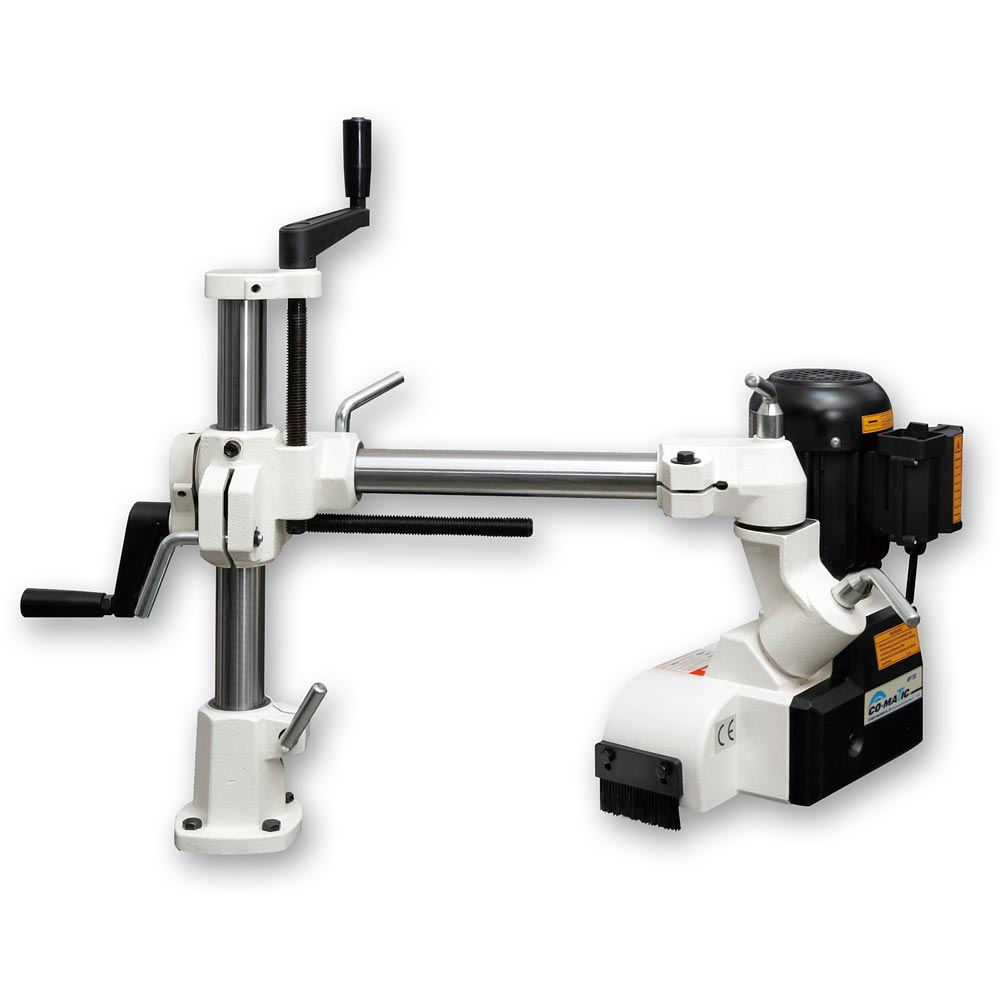

Co-Matic AF32 Power Feed
SKU: 340195
€595,00
  • 240W motor fitted with reverse
  • Feed speeds 5, 8, 9 & 11m/min
  • Max height under rollers 150mm
  • Max reach 260mm
  • Column Diameter 40mm
  • Weight 32kg

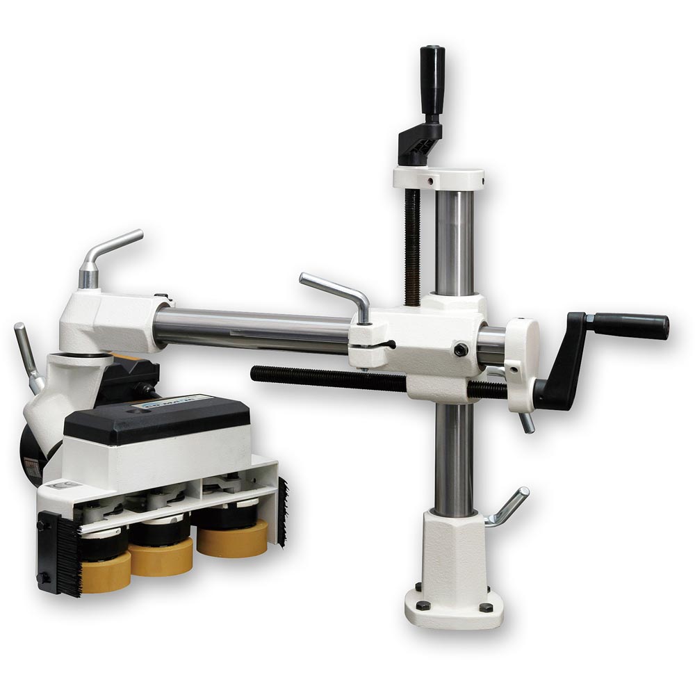

A medium weight power feed unit with three PU rollers, all spring-loaded to provide a constant feed rate for many machining or cutting tasks. There is a choice of four feed speeds, easily selectable by removing the side plate and re-positioning the drive gears. Reverse feed is available via a selection switch. The horizontal and vertical position of the drive head can be precisely adjusted with the aid of the two adjusting screws and then securely locked in place with the two handles. An additional feature is the ability to rotate the head through 90 so that pressure can be applied to the work in either the vertical or horizontal planes. The unit is secured to the table of the machine, either by bolting through or by screwing into holes tapped into the machine bed. If drilling the holes into the table of your machine is too disheartening then the purchase of the universal quick fix support plate (800430) is an excellent solution. This is an excellent power feed for medium sized spindle moulders, but can also be fitted to surface planers and circular saws. Whatever machine it is fitted onto, the standard of work finish and operator safety will be greatly improved.
